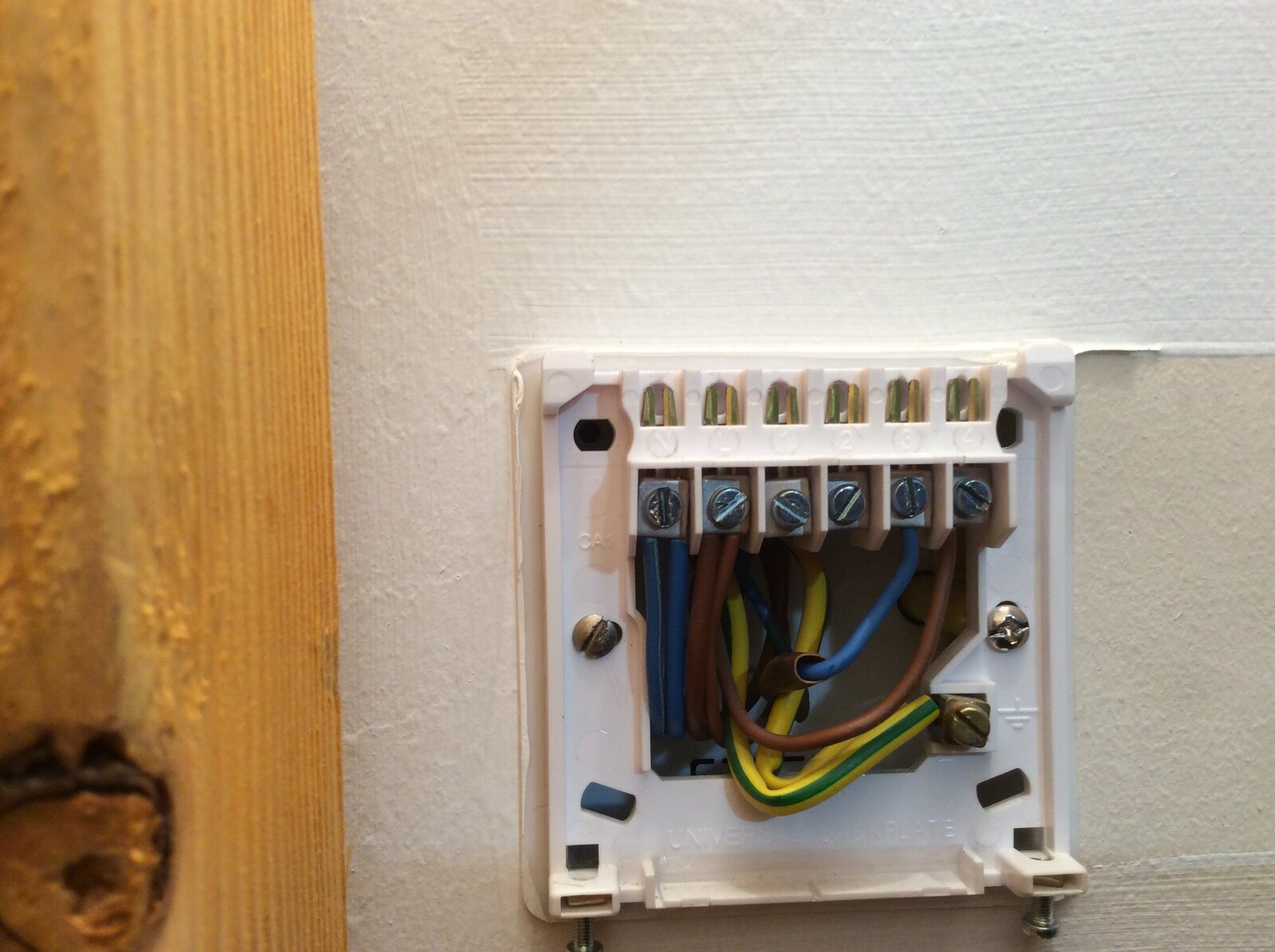

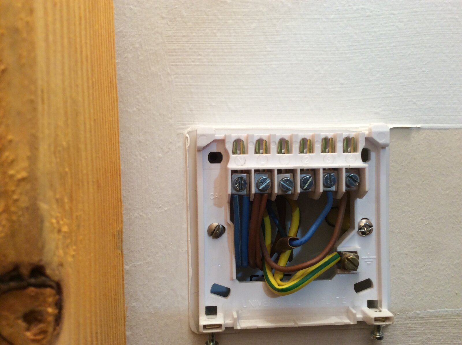

I have just moved into a new house which has a combi boiler (previously normal with HW cylinder) however the owner retained the Centaurplus C27 clock and just had hot water set to 24/7 to give a live to that circuit. Coming to replace with a hive single Chanel unit and looking for some help. At present it’s wired up for the centaurplus with a neutral to terminal 3 and live to terminal 4 - nothing in 1&2. Would I be right in saying that 3 is HW on and 4 CH on. If so looking for suggestions, is it just a case of bridging the HW on (neutral) into the perm neutral. Assuming neutral and live given colour of sheathings on the wires. Any help much appreciated.
under no circumstances attemp that, what you are calling the HW neutral is a live, never go by the colours of wires in a heating system, they mean nothing, which combi boiler do you have ?
You are totally right, I hadn't looked at the wiring diagram properly.
The Boiler is a Grant Vortex Pro External Combi21e, as the name suggests the boiler is outside in a casing so it's a bit more difficult to trace the wiring.
Normally pretty good with DIY electrics but not getting my head around the wiring for the controller, perhaps not aided by it being a dual channel controller hooked up to a single channel system

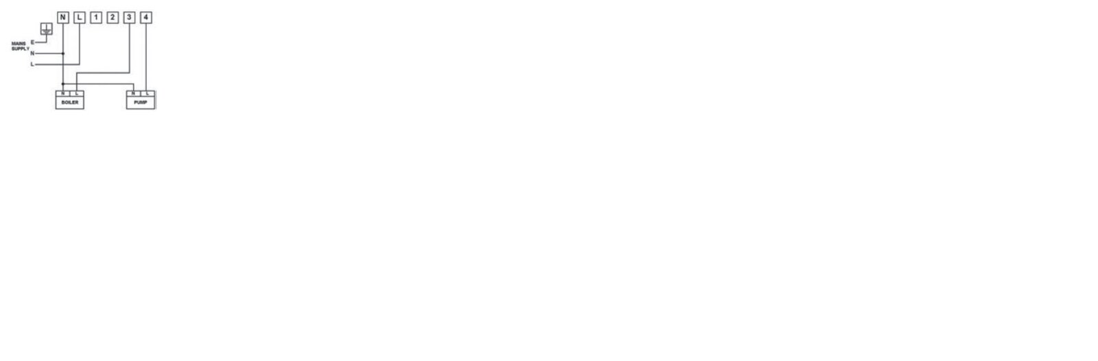

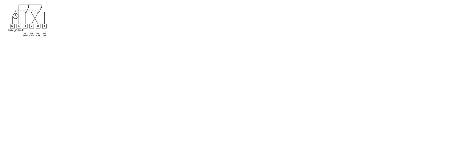

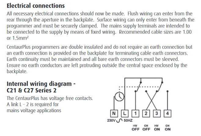

The first thing is look for instructions and read this seems to be the existing programmer
note it says Centaur Plus is volt free, so it seems the centaur plus is same as Hive single channel and standard one is same as Hive duel channel, so I would be hunting on the actual device to see if there is a diagram. Your picture clearly shows a brown sleeve on the blue wire going to 3 so clearly a line not neutral.

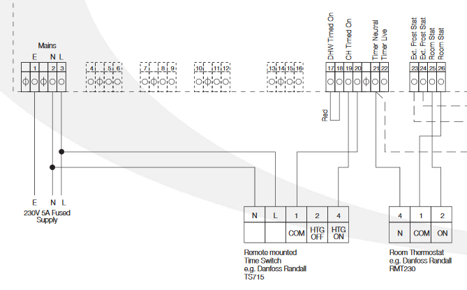

Looking at the instructions page 24 it seems possible the programmer does control the DHW it is not like a gas boiler.
looking at this it seems the programmer may still control DHW even when it is a combi boiler. If it were me I would be considering Hive duel channel, I am not sure if the boiler modulates or uses a mark/space ratio and water store inside the boiler. With a gas boiler common to say 6 kW - 28 kW output, but yours seems to say simply 21 kW output so seems it does not modulate which is expected for oil. There are a series of diagrams I have shown first one, it seems terminals 17 and 18 can be used to turn DHW on/off shown in this diagram with red link.

It would help if we knew what was on the other end of the wires so as to know what they were doing. However, it wouldn't be too difficult to replicate exactly what the C27 is doing now with a single channel Hive. First of all as per @ianmcd
L to L on hive
N to N on hive
The brown wire in 4 to 3 on hive
Link L and 1 on hive
Then if as you say:
If a permanent live has to be maintained here, then putting the blue wire with the brown sleeve on in the L terminal would replicate the hot water being switched 'on' 24/7. I suspect it might be the way the installer has provided a permanent live to the boiler. But like I said without knowing what's on the other end of it...
