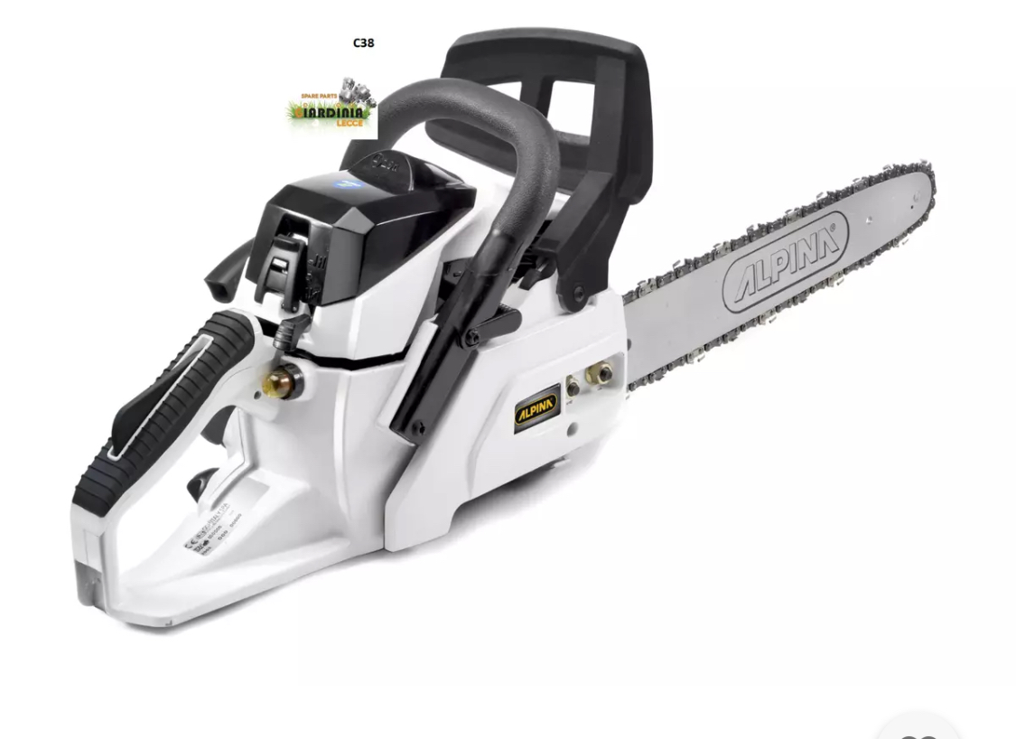

10 years ago I bought the Alpina C38 chainsaw to cut down a few trees in the garden. Since then it’s lived in the shed untouched. The other day I got it out and had a smell of the fuel of which didn’t really smell of anything.
I gave the rope a pull & it started & ran fine “WOW”
I dumped the fuel mix and replaced with new. Used it yesterday for an hour & did t miss a beat.
My question is when I unscrewed the fuel cap there was a fine spray of fuel as i unscrewed it.
Any advice about this ?
I mean none of my other tools do this.
Secondly this morning there was a very small puddle of red oil below the chainsaw.
I see a tank for oil of which I assume must lubricate the chain etc so does the oil get flicked into the unit then drip down once stood or is there a leak ?
Any advice please.
Thanks.

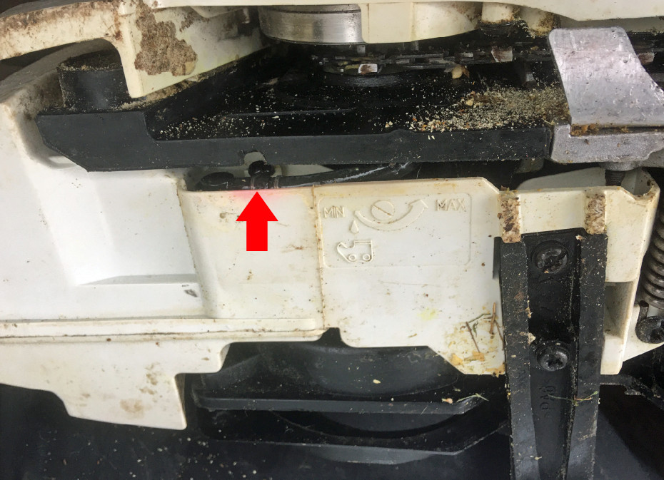

Looking from under the chainsaw i can see a black pipe which pushes onto a black plastic part.
I can see that this pipe has 2 small clips on it which is the issue i believe.
Reason being why not just the 1 clip ? push the pipe on the plastic part then fit the 1 clip.
This looks like the pipe may have been cut & a joiner fitted hence the 2 clips.
What annoys me is this was purchased new from a machinery shop just along the road.
So how do i tackle getting to this piece.
Do i take the chain & bar off or do i take the handle off ?

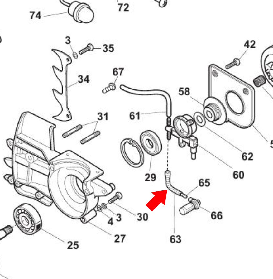

Looking at the pdf file i would say its the part arrowed.

Ive got it apart now and attached photos.

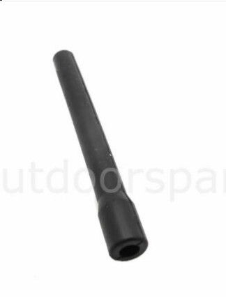

On the lower end of the oil pump is a short length of black rubber hose.
Its say 3 inches long & just pushes onto the oil pump.
The other end pushes onto a plastic joiner piece & held by a coil of wire,doesnt feel tight at all and was able to pull it off with ease.

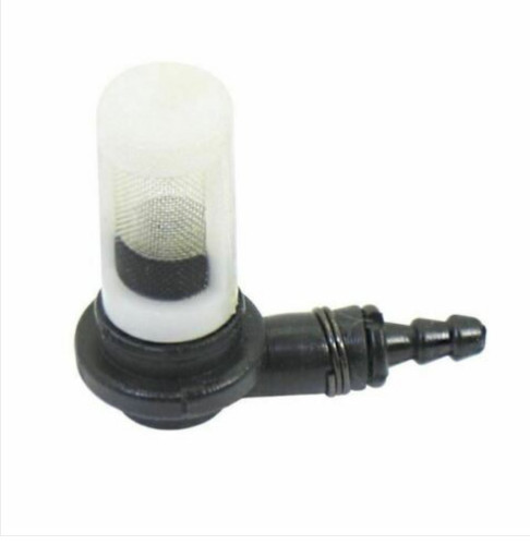

The other side of this joiner pipe is the oil filter.
This pops into the tank & held in place by a spring clip / screw.
This wasnt a very tight fit in the tank either.
Ive located a new piece of pipe but dont seen to see a filter etc.
Do you recognise the filter by the photo which might be used on another chainsaw.
Im happy to just order / fit the new piece of pipe "oil pump to filter" but wanted to make sure the seal of the oil filter grommet to the tank was tight.

I don't recognise the filter, but I can't see any need to replace it anyway - just give it a clean in white spirit or whatever. The seal is probably an O ring, maybe a smear of blue Hylomar would help stick it in if you think it is loose.
As for the rubber pipes, just use a couple of turns of 30 amp fuse wire and spin the ends with pliers - they will hold on just fine.
