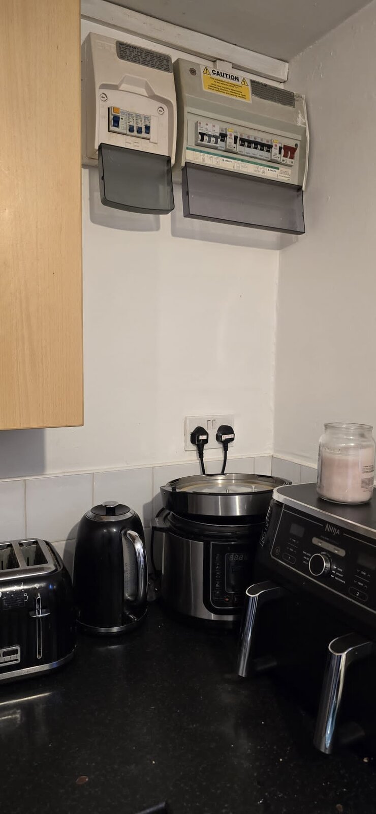

Hi all.
In a small flat kitchen, there is a corner where all the worktop appliances sit:
Air fryer
Kettle
Toaster
Multi cooker.
There is currently a 2 gang socket, directly below the consumer unit.
Is it possible to swap this to a 4 gang faceplate with back box?
More importantly, is it safe?

No.
It will need looking at to see if it is suitable, but you can probably just put another double next to it.
If I was to do this, is it better to just spur it of the original, or ring it (which would need an extension to the original) with a in line terminal connection.
that socket might be fed from the CU above as a radial. what does the cct markings on the cu say
I checked this the other day, after you mentioned it. There is a kitchen red, that knocks out the 2 kitchen sockets.
There is a separate red for the cooker/ microwave sockets.
The strange thing i found is, i was checking with a bosch cable finder, and I couldn't find the source anywhere around.
P.s. I tested it with other sockets in the kitchen
There are no 4 gang sockets, other than dubious converter affairs which are limited to 13A total.

So I think that type was used previously, I think it melted due to the airfreight, kettle and toaster being on at the same time.
That's why the need for change is needed. Right now the plugs are continuously switched.

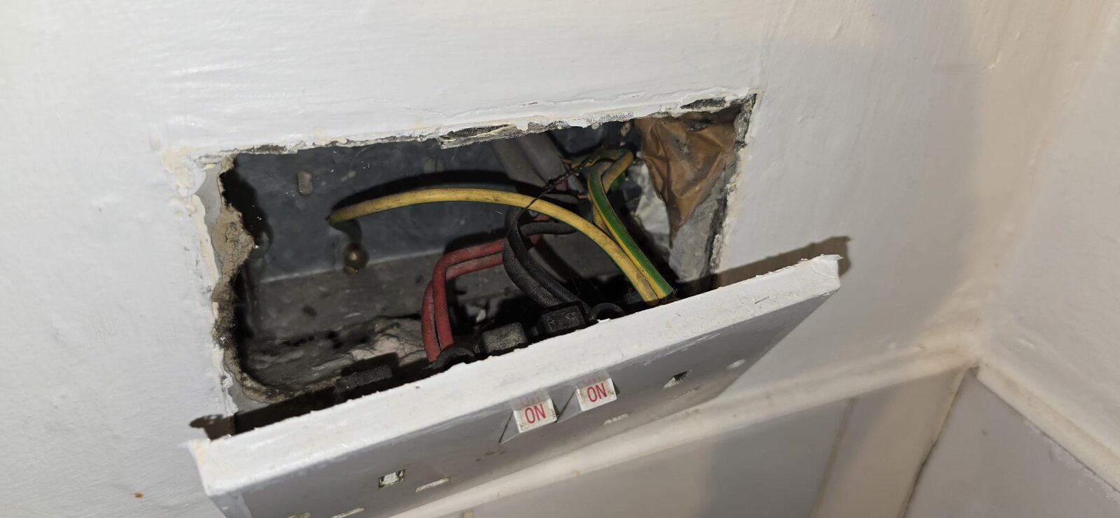

I took off the socket below the CU. It's definitely a ring. Quite old, given the red and black wire.
I also worked out why the detector didnt pick it up. The back box is set quite deep. Also the wall seems to be made of something really thin.
My thinking is, take out one of the connections, extend the wire for a ring, then use this Lap backbox (which should be indiscrimate of depth and the thickness of the wall) to add a second 2 gang about an inch apart from the original.
I might also add a single spur off the new 2 gang for the occasional appliances.
