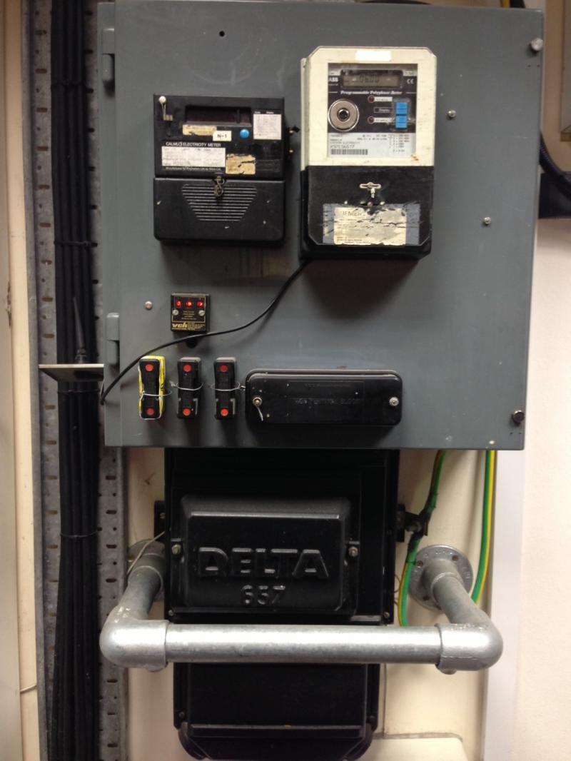

I suspect I know the answer but could be wrong, at work we've got a 3 phase supply, the MOP (SE) has insisted they need to change the meter and has told us they can do it without downtime because the electricity doesn't go directly through the meter! Is this a call center fib or is it true?
I've saved my work just in case!
It's probably true yes. You likely have what's called CT metering. I can't find a good link to explain it
Thanks, looks like it works by induction so makes sense. Out of interest, doesn't it make it quite easy to interfere with the meter (eg place a magnet over the sensor?)
thats why the magnets are locked in a big cabinet!
Ah, only saw this on wikipedia, minus the cabinet I guess - haven't seen our setup.
Yep, meters fed by CT's can be swapped with ease without any downtime, and with no risk to the operative (assuming all precautions taken). The setup is designed to allow this to be done.
It would need to be an AC magnet. As with any meter you can fiddle them but it would be just as hard to do it without detection.

That's probably all very true, but 'corporate crime' does exist! Interestingly, in the pic posted by Iggifer, there are no obvious seals on the CT enclosure/cabinet.
