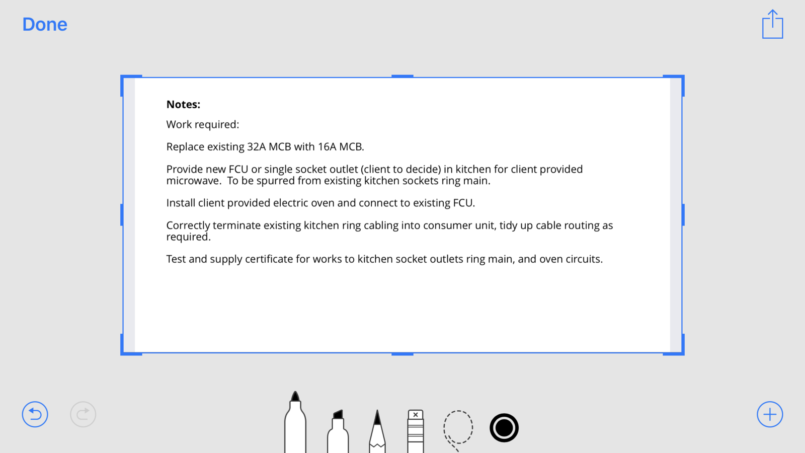

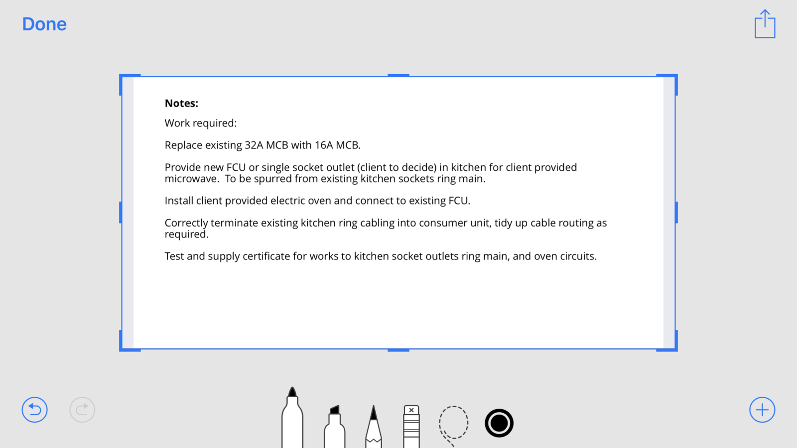

I beleieve both electricians said 32 isn’t right for this setup
See attached quote

They are right in one sense
A 32A is not right for this set up
BUT
2.5mm cable is rated at 27A when it’s installed properly. So they can provide the rating that is equal to, or smaller than 27A.
Some CU makers do a 25A breaker, 20A is more common.
Why did they specify 16A? Does that happen to be the value that they’ve got on the van?

He said:
Im pretty sure that MK don’t make a 25A MCB for your consumer unit.
A 20A would be fine for the cable fitted, but combined with the start up currents and running loads of both your microwave and oven, it would lead to a lot of nuisance tripping if you had both appliances in use, especially as the microwave starts up when you press the start button.
To avoid this, you are better off sticking with a 16A MCB for the oven circuit, and then having the FCU or single socket spur’d from the double socket in the utility area to provide power for your microwave.
There’s no reason you couldn’t have the 20A MCB for your oven circuit, it just isn’t necessary, and there’s really no point over providing for a circuit if you don’t need to.
Hope that helps.
Sounds fair?
sure that could work. Happy to be corrected on parts available. However, having just checked the cable ratings for twin and earth cable, 2.5mm, installed in a cavity wall (assuming some sort of insulation also within) and the cable touching the inner surface of the cavity wall, ref method 102, the maximum current allowed for the cable would actually be 21A.
Without knowing the exact construction method of the walls containing the cable, it’s generally best to assume the worst case scenario and therefore avoid any potential issues in the future.
I appreciate trying to find the easiest and quickest possible way to solve the issue at hand but there are many variables at play.
I still stand by my suggestions as being the safest most reliable method given your current situation and the information available without opening up walls for further investigation etc...
The rating of 27A that you were given earlier is correct, but only when the cable is run clipped directly to the surface of a wall. Not the most attractive way of running a cable, and not the way that the cabling in question is run in your house to your utility/kitchen areas.
