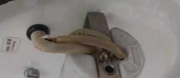

Hi,
I have a few light fittings like the one picture below. I think that the house was, at least partially, rewired back in the early nineties.
Could a new light fitting be connected to the wiring that is currently there? If not, what would need to be done first?
If no other work is required, would it be legal for a DIYer to fit a new light?
If legal, how complicated would it be?
Any advice would be much appreciated.
Looks like it.
Apart from stating you must do it to ensure safety, the law doesn't come in to it.
Very simple, but as you have to ask - ???
Switch OFF the power at the fuse box or consumer unit and disconnect the wires.
The cable you can see is likely to be connected to at least two more cables in the ceiling.
This brown sleeve on the blue wire should not be there.
It does indicate that whoever did it did not know what they were doing so you may find some other surprises.
I did wonder about that brown sleeve. Did these things come with some kind of heat resistant covering as they could have previously had a 100 watt lamp in? That said, such an item is usually braided, rather than looking a lot like normal sleeving as you say.
They always supply heat resistant sleeving with these types of fittings which always appeared to be woven fibreglass? then it changed to white silicon which rapidly turned brown with the heat. I think the pics are showing before and after hot bulb.
