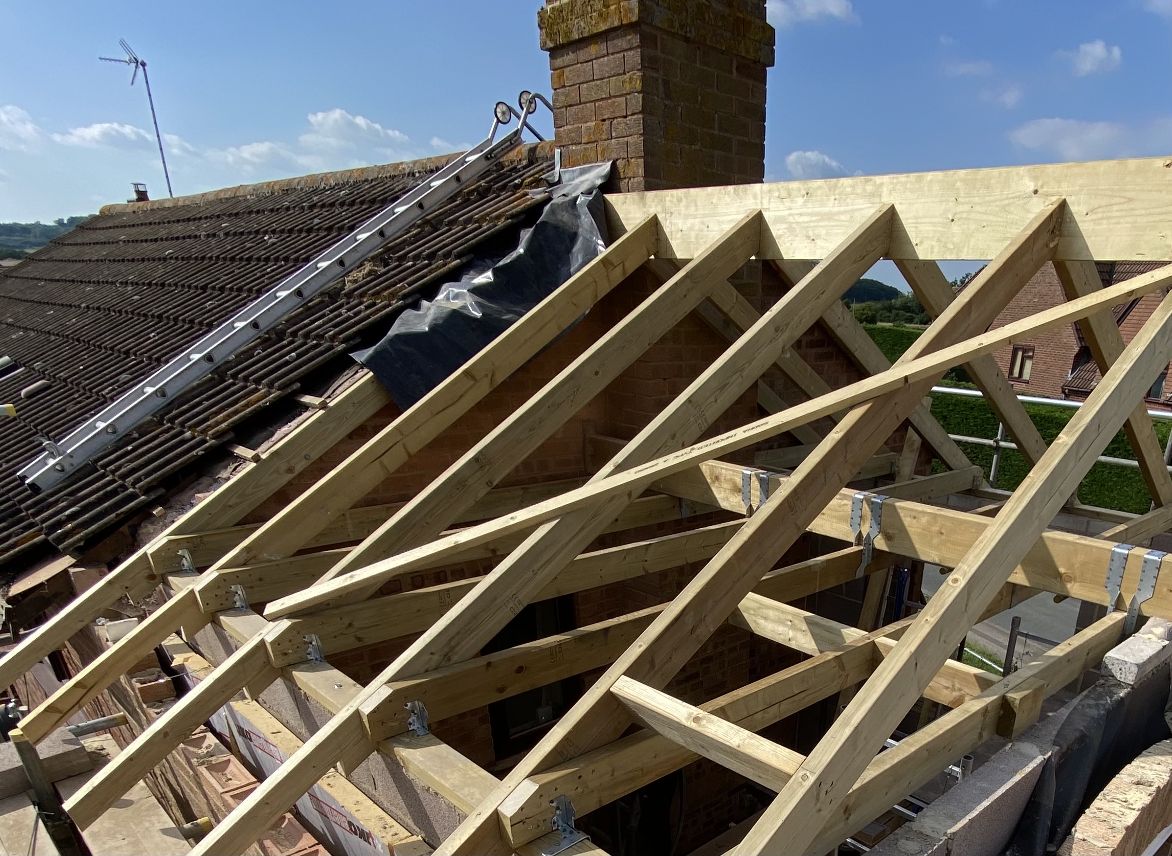

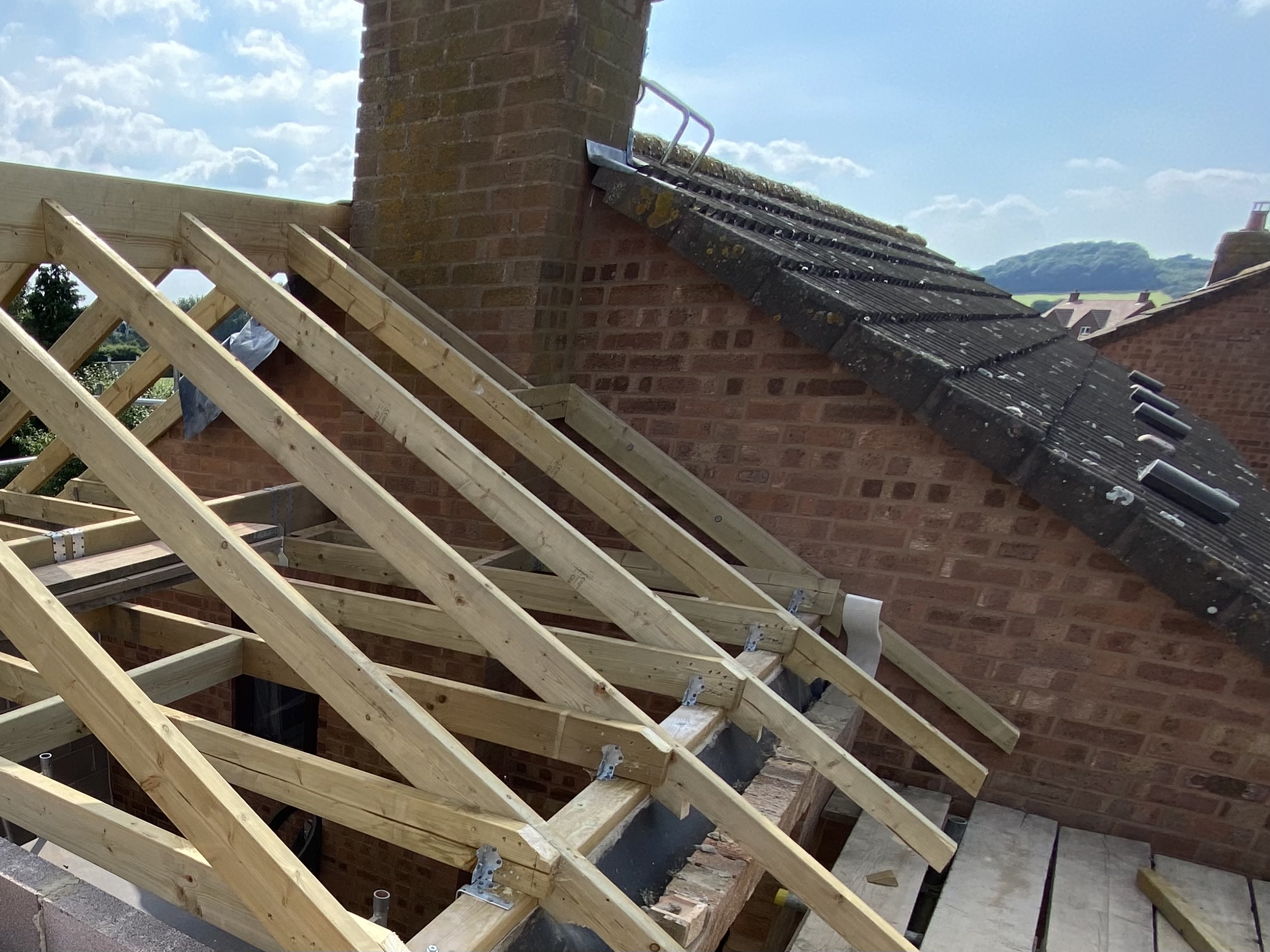

I am building my first roof and have some questions about flashing and ridge tiles. For the abutment (first photo), I plan to use cavity trays with integral lead flashing. For the other side (first photo), I am not sure how to form the flashing. The gap between the ridge and the chimney is 4.5”, the architect has recommended taking the ridge tiles past the chimney and up to the existing roof tiles. Then building a wooden support between the chimney and ridge tiled and using a long lead flashing to go from the chimney over the ridge tile and down over the tiles. Does anyone have any thoughts about the best way to do this?
I think your architects idea would look awful.
I would terminate the ridges at the chimney and form a back gutter/lead saddle and an apron over the last course of tiles.
As above , stop ridge at chimney the flash the rear . Simple job .
Any other way would be a waste of effort .
I had considered a back gutter, but was concerned that a 4.5” wide gutter that is closed at one end would be susceptible to being blocked as the wind would not clear it out?
