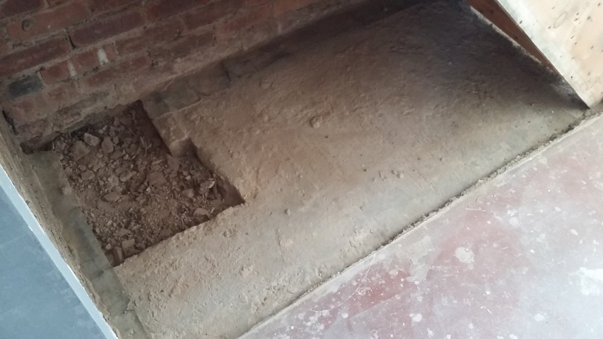

The main issue I need to overcome is that the floor under the stairs isn't finished. There is a concrete finish, but the rest of the house has on top of that: a layer of bitumen, concrete screed (looks just like normal concrete from the edge) and magnesite, total depth about 40mm. So I have 40mm to make up under the stairs.

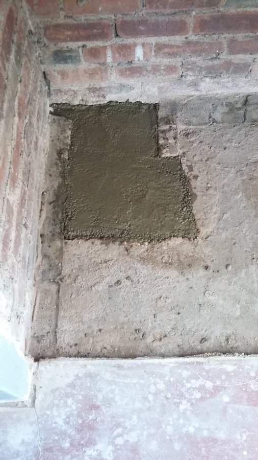

There's also a pit thats been left, roughly where the incoming electricity cables run. I'm not bothered about accessing that, clearly access hasnt been needed for 60 years. So I plan to fill that in with concrete, let dry, then lay a dpm over it all and lay concrete over the lot. Is this acceptable for a 40mm depth?

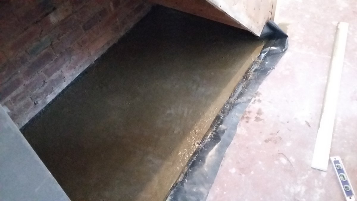

Done this so far. Didn't take as long as I Thought to mix up and lay. 1.5 bags down. 20161105_092813.jpg
Done! I didn't end up using any guide at the back but it looks bob on. The surface of the old floor actually wasn't bad and using that as a guide went quite well.
