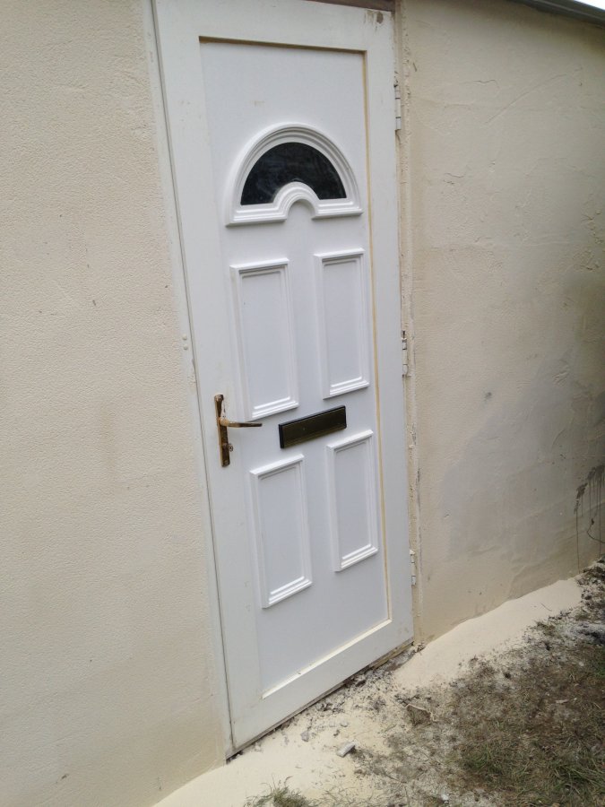

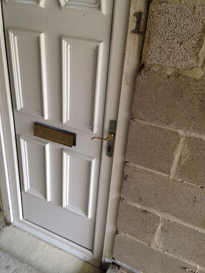

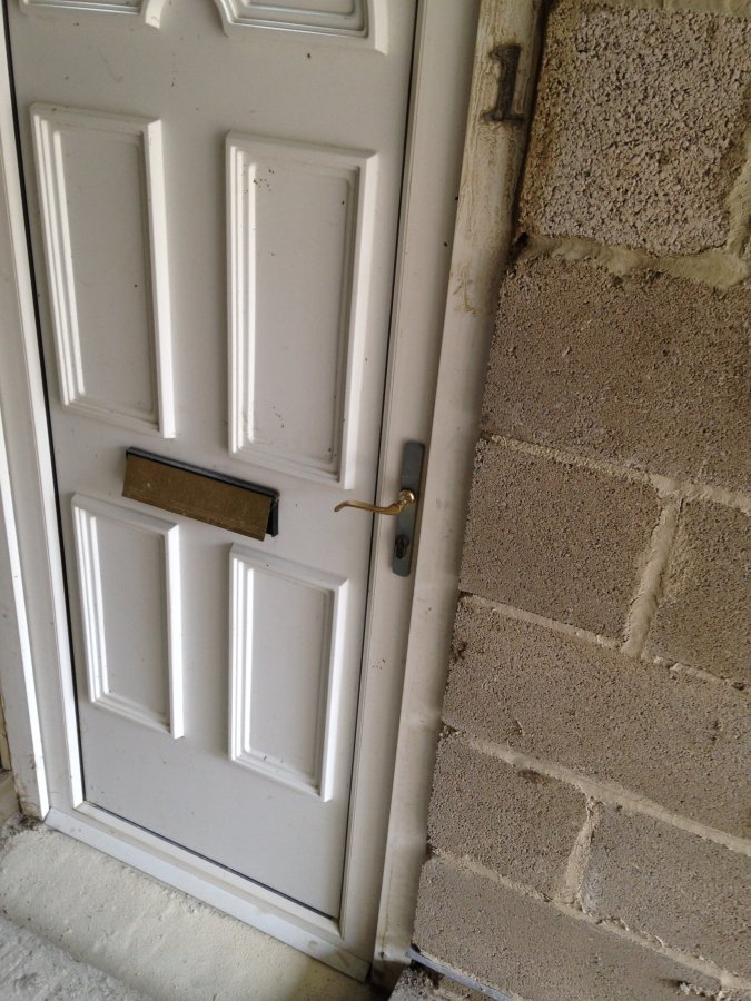

Count the block courses where that placcy door is supposed to fit and tell me we are being trolls. Would you be happy with it? 6' tall (at the low end), zero pointing, foundations on soil, sloping heads on openings, door unlikely to fit. I could go on.

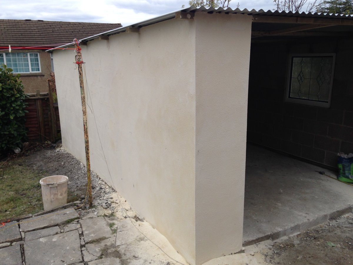

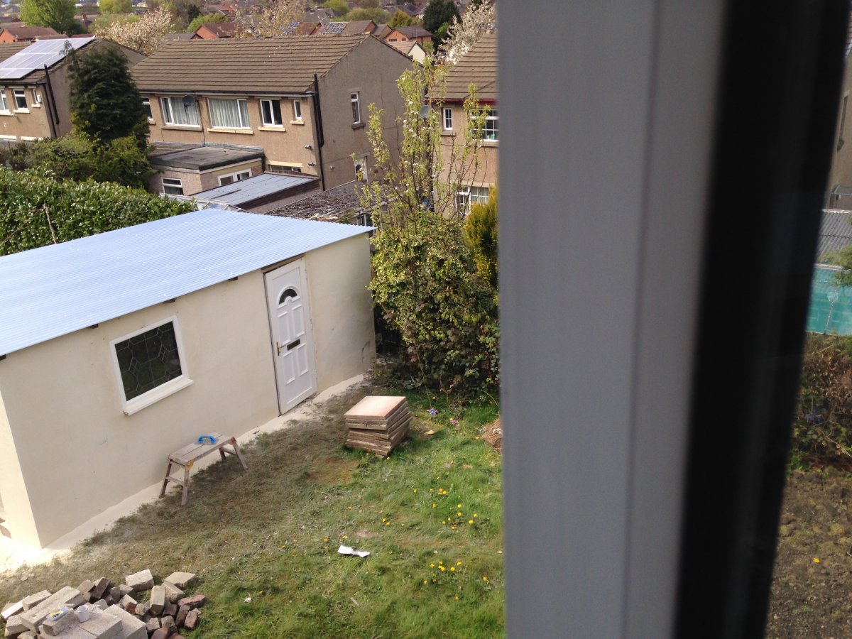

Done as advised. Not been feeding them for a while.

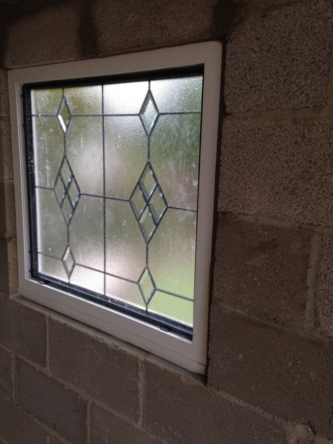

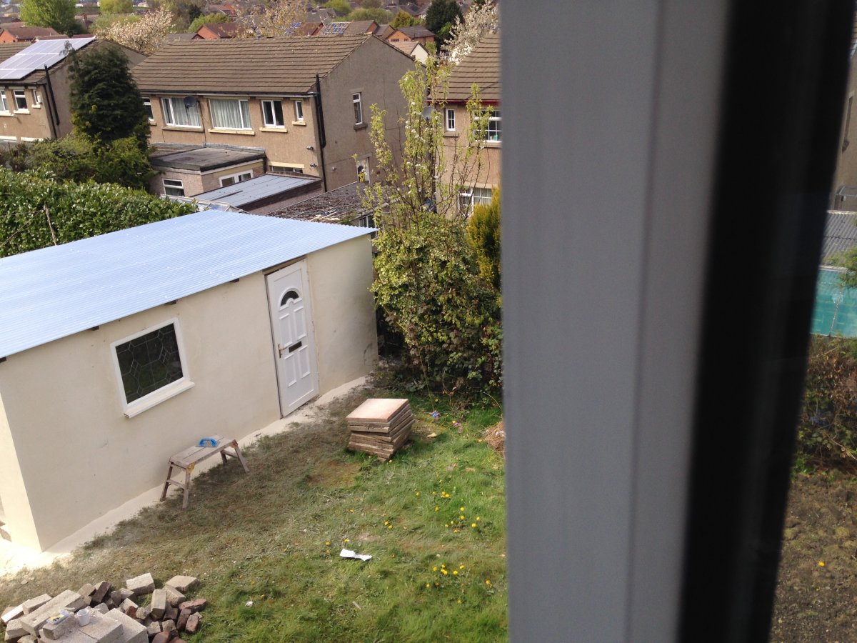

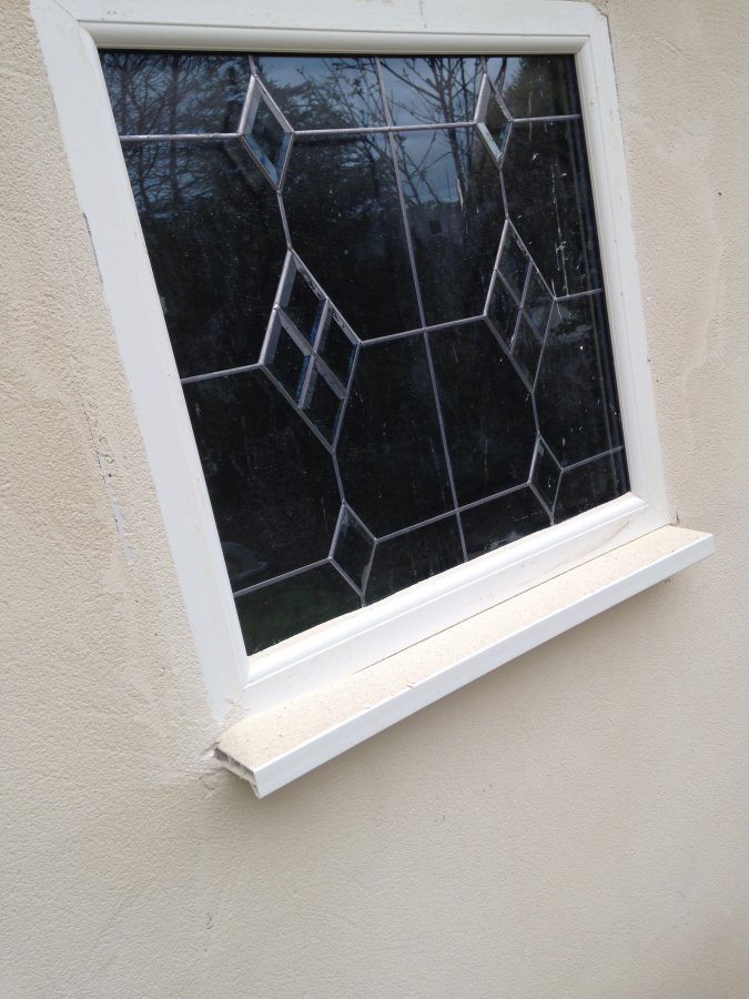

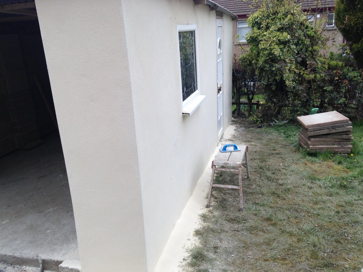

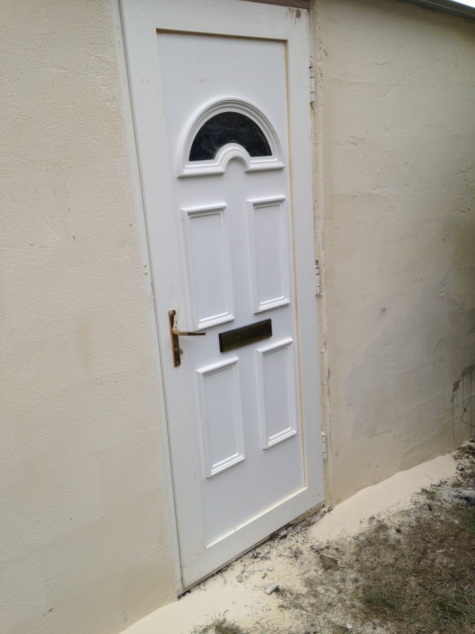

Anyway render on and window and door in place. Door did fit eventually with a step on built inside garage. However opens outwards which isn't an issue.
Gutters and garage door left.
3weeks done maybe a week left.
Cost still £2650.

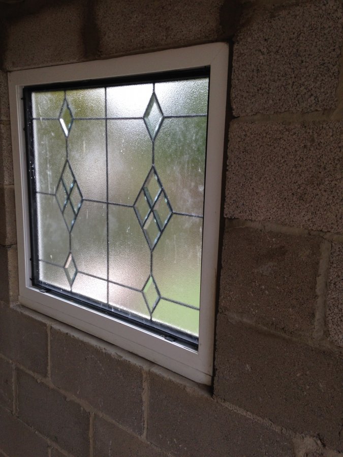

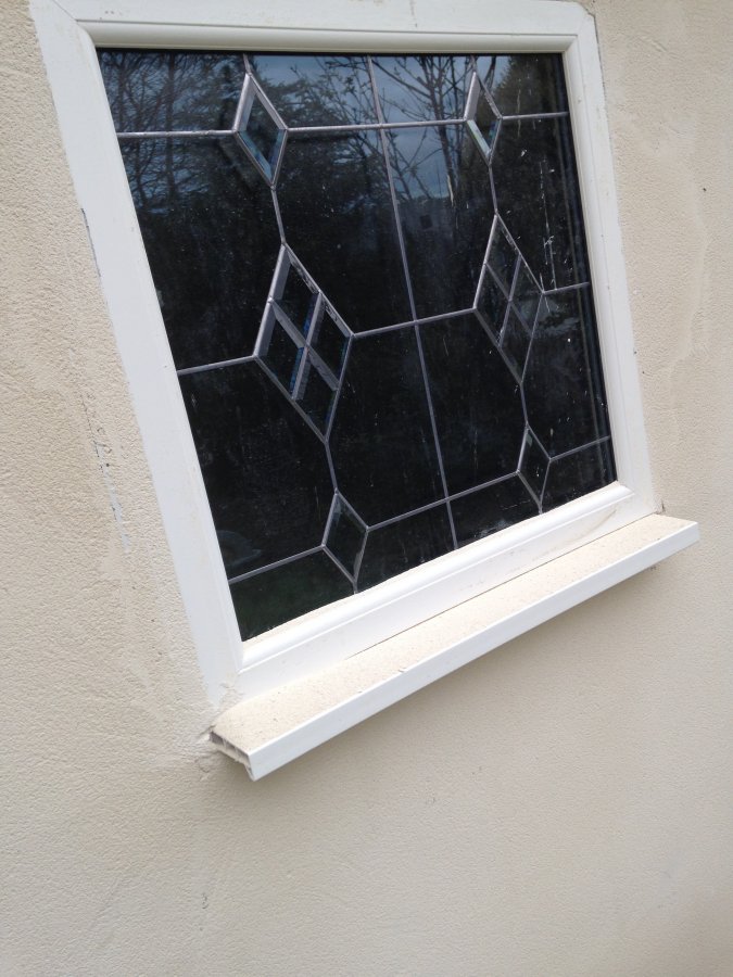

Pics of that door which wasn't supposed to fit and window.

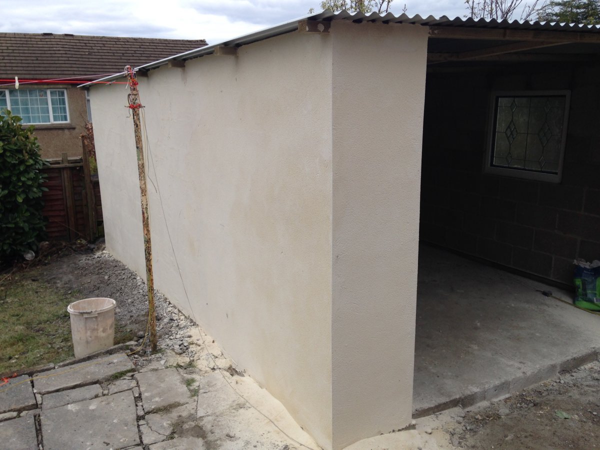

Looks neat, make sure the roof timbers are strapped down to the walls properly, also they look a little on the thin side, do you live somewhere with snow fall?
They had delivered thin ones and he said he reordered larger size.
What min size needed?
Get snow very rarely but he was walking freely on it no flex.
Timbers have been secured down.
Well there you go, proved us all wrong.
If you are happy with that I do know of some excellent tarmacers if you want their number.
But seriously there is quite a bit wrong with it and you should not let him get away with it.
There are beads showing through the render for example
Yeh noticed beads today myself seems like he put on thin render and scratched it off to plain it. Some grey blocks also showing. Will speak to him.

I think for the price of a sectional garage it's bigger( internal size is 10ft 3 by 18 3) and having the choice I would still build it. A few more touches to it and it should be ready for storage.
The roof to wall detailing is novel, it has a certain post-apocolypse shack aesthetic.
