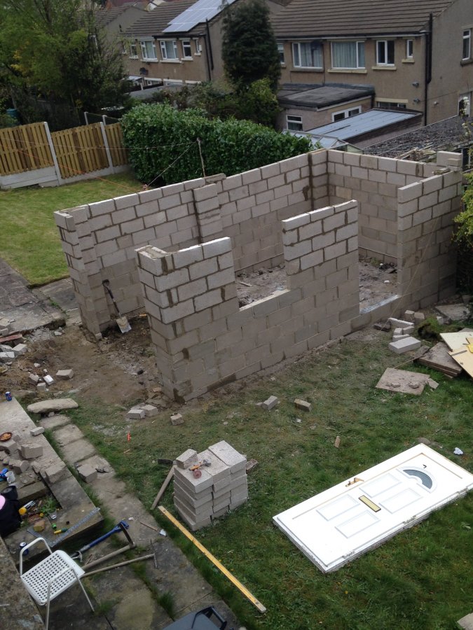

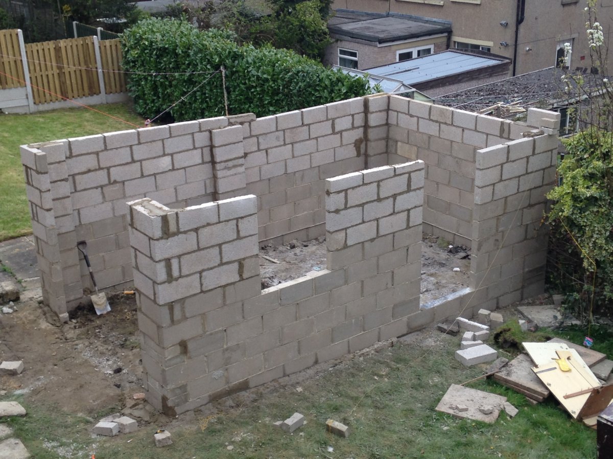

Maximum height achieved with walls with roof to go on not exceed 2.5m. Roof to slope downward since rear height is near max with roof it would go over top.
Digging floor to 8 inch deep and then hardcore 4 inch with 4 inch concrete. Roof on order tomorrow.
Problem with door as it's 7ft high with frame. On top of cutout it would hit roof so it will now open outward. Inside Floor level with dpc and higher than outside. Gutter to go on rear and inside wall.
Neighbours complaining about height. Dumb people saying it should be 6ft high ... read your planning guide mate and telling me it needs planning permission.
I suppose this is where you are loosing out with an inexperienced builder. In England the height is 2.5m from the highest point of ground level. So the roof could be 3m tall is you had a .5m drop
My fault i insisted he bring it down to 2.2m. He said it was ok.
So you measure from the highest point on the ground say front of garden near garage to top of roof at rear of garage .
He kept telling me it was ok but with me doubting his every move I was worried of the 2.5m limit
