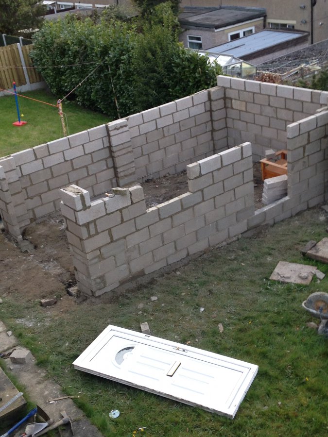

The walls are 80% up. I'll post a pic if you guys don't laugh. Don't know what to make of it? It's not bad but it's more like a shed than a garage.
Hardcore is coming Thursday. They've been walking on soil and they took out bricks it's pretty hard. Do they now pour 4 tons hardcore and compact done with machine and then pour concrete over after putting down sheet.
Luckily I picked up a door from another builder yesterday who delivered it for me. He says you need to put hardcore in and then sheet followed by concrete. He didn't laugh at it said it was Ok.
Oh we have a scaffolding in place ...it called a grand coffee table.
Anyways here goes. Take a deep breath and release. Viewers discretion advised please don't exert yourself after this since your pulse will be racing anyway.

Looks right enough to me. I don't think you need piers in the corners but they will make it all stronger.
Yeah the pier should be on the wall between the door and window as that's a weak spot. Consult your designer/SE to confirm what you have is adequate.
Thanks for telling me that. The builder said opposite. I asked him why he hasn't put pillar there and he said due to window and door being there.WTF. I'll a bit annoyed with him now.
I have an urge to kick it to see if it's strong as being so thin it makes me feel as it's built like domino's.

The general rule with groundwork on a former lawn is to always remove the turf and at least a few inches of the soft fertile stuff near the surface so perhaps dig off 6'' or so. One of the fundamentals is to always remove dug out soil as it has been loosened and can not be compacted properly again.
In your case seeing as they never bothered to strip off the top 6'' they just threw the loose soil on top so not only is that stuff unsuitable but there is turf buried under a foot of it which isn't suitable either. If it had been done properly the turf and top few inches would have been scraped off and the area filled up to the required level with hardcore.
Simply dumping hardcore on top of the crap thats there defeats the purpose, there is no point having a nice sub base on top of unstable rubbish fill
