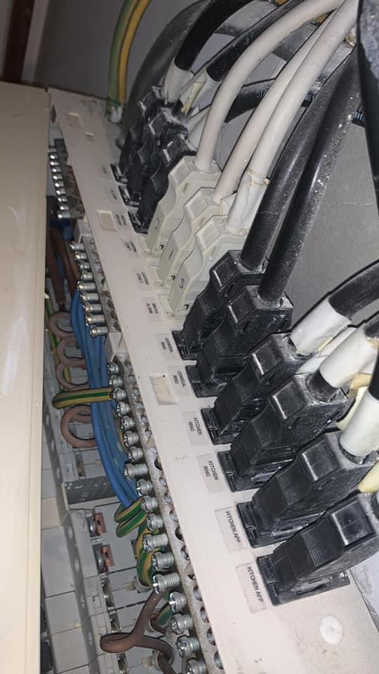

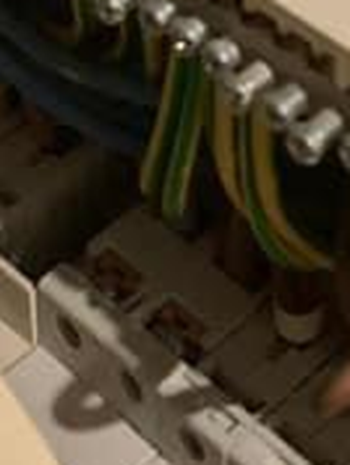

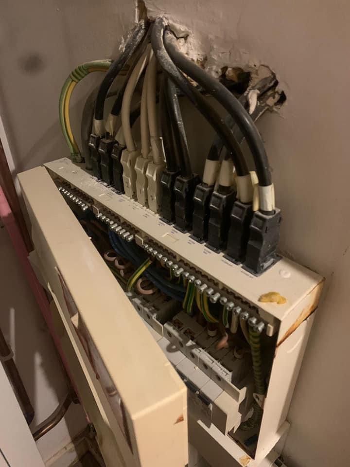

The last few new build schools I have worked on all use plug and play wiring. Basically flex thrown in a basket above the suspended ceiling with a little splitter box above each light or socket. All the flex comes in pre-terminated lengths of 1,2,3,5,10,20m etc. The only on site termination is the switch and socket fronts.
Even the boards are pre wired off site and the final circuits just plugged in.
