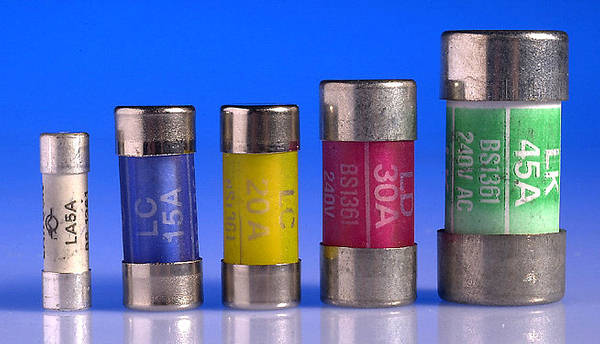

They look like cartridge fuse holders to me (on the Proteus unit), a format widely used in the Eighties.
Well, obviously you now know that the shower had its own unit added with RCD & MCB. If the conservatory was added on sometime later, then that middle board for the addition makes sense. So the two 30A fuses on the main house board are then most likely either two rings, or ring and cooker.
Best with the main switch off to change them, you push the lever down gently, and will see the fuse in there, they are like plugtop fuses but different sizes per amperage, proberly not easy to get, proteus are made by CEF, but other s may fit, once hinged down the fuse pulls up and out, again refit only with main switch off, to prevent arcing/damage.
To be honest they rarely blow unless an extreme fault, once blown they need replacing with a new fuse, once removed they can be tested by a basic continuity test with a multimeter
are they easy to replace or do they work like mcb' and you reset them
Replacement takes just a few seconds - Pull the carrier open, lift the old fuse out, drop a new one in, close the carrier.
The fuses are BS1361 types, like these:
