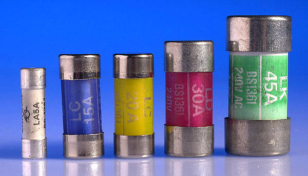

I don't recognise the Proteus, but it is important to know that unlike MCBs (which you can switch on and off under load), with fuses, you must turn the main switch off before inserting or removing them. Otherwise there may be quite a big flash and spark.
It might be worth making a label to fix to the CU saying so. If they do hold cartridge fuses, get at least two of each rating and leave in a clear jar or plastic bag where they are visible and easily accessible. The reason for "at least two" is that sooner or later you are sure to change a fuse but the fault will still be present.
They look like cartridge fuse holders to me (on the Proteus unit), a format widely used in the Eighties.
Well, obviously you now know that the shower had its own unit added with RCD & MCB. If the conservatory was added on sometime later, then that middle board for the addition makes sense. So the two 30A fuses on the main house board are then most likely either two rings, or ring and cooker.
Best with the main switch off to change them, you push the lever down gently, and will see the fuse in there, they are like plugtop fuses but different sizes per amperage, proberly not easy to get, proteus are made by CEF, but other s may fit, once hinged down the fuse pulls up and out, again refit only with main switch off, to prevent arcing/damage.
To be honest they rarely blow unless an extreme fault, once blown they need replacing with a new fuse, once removed they can be tested by a basic continuity test with a multimeter
Replacement takes just a few seconds - Pull the carrier open, lift the old fuse out, drop a new one in, close the carrier.
The fuses are BS1361 types, like these:
https://www.tlc-direct.co.uk/Main_Index/Consumer_Units_Index/Wylex_Standard_Carriers/index.html

They are sold at B&Q stores - There is a major design fault with the 5amp fuse in this type of consumer unit, it is very easy to accidentally insert a plug top type of five amp fuse into the holder, as they are far more readily available, and cost far less, but only differ in size by fractions of a millimetre - replace the 5 amp ones with a plug in mini-trip also from B&Q when you are there. When the bulb blows, it may blow the 5amp fuse, using the mini-trip will be more convenient and safer too.

Aploligies mrcrow, what i was getting at was that the B+Q plug in units DO NOT fit in the board you have.
Proteus may still do mcbs that fit, but could involve changing the busbar, but to be honest, as JohnD says them fuses rarely fail in normal use anyway.
If you want mcb's then maybe the neatest way is possibly remove all 3 of your units and fit just 1 larger one
