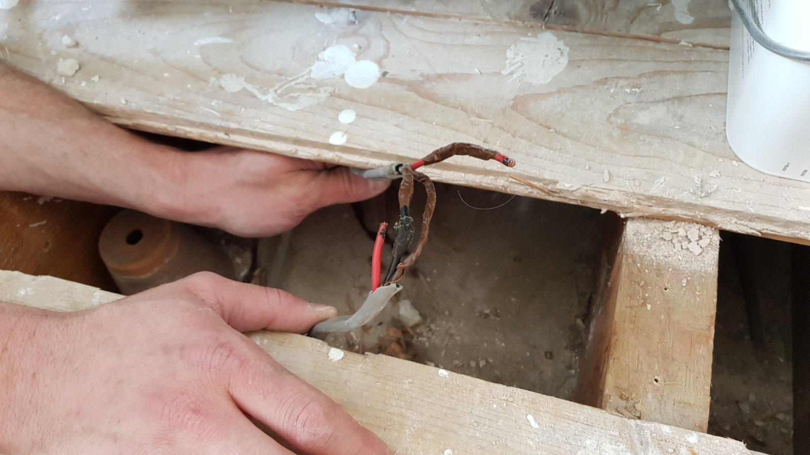

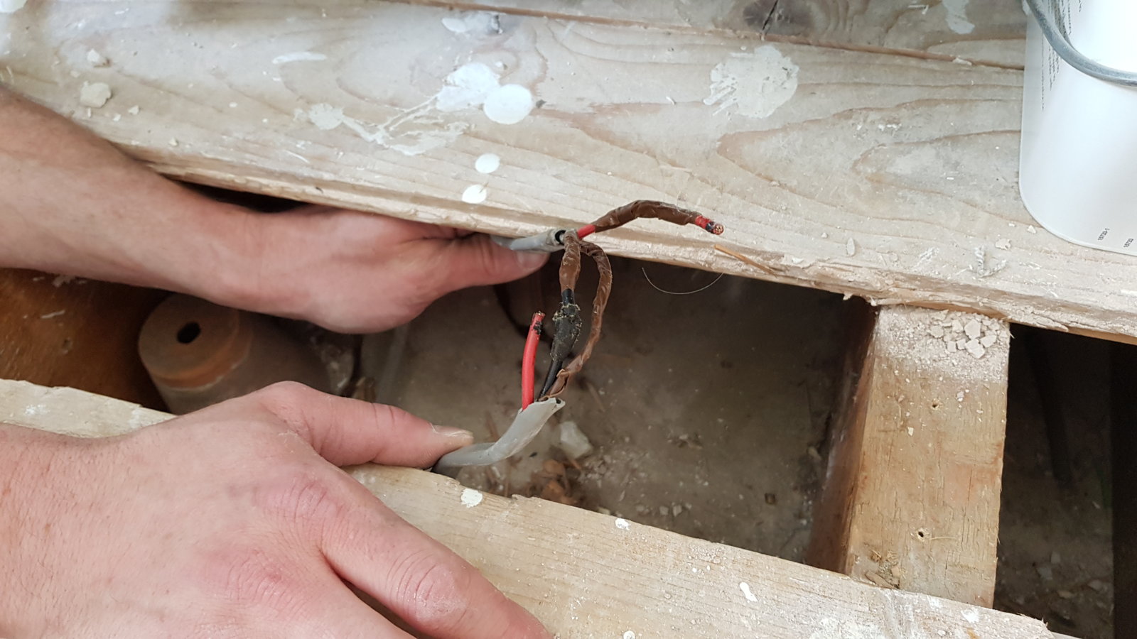

Right, I have been round and checked every socket on the ring circuit, I can't find a live that isn't secured in place albeit I found alot of other wierd stuff, including spur off a spur, lights wired into the back of socket and a bag load of un sleeved earth's with metal backboxes .. Kind of stuck now
You need to get an electrician to find the fault (and I would not recommend you ask your friend, as leaving live cables wrapped in tape hanging out of the wall is not a safe practice)
Update, my friend has been round and found the fault. He split the ring and tested parts of the ring to work out where the break is. It was a flex that lead from the first socket on one side of the ring (after being fed by CU) downstairs that then run upstairs to then run downstairs to a socket in the lounge. The previous owner had broken the live then wrapped it in insulation tape and it could only hold for so long. I guess since work has been done in that room it's moved. Slightly. Anyway it has not been crimped and insulated and we have a complete ring
