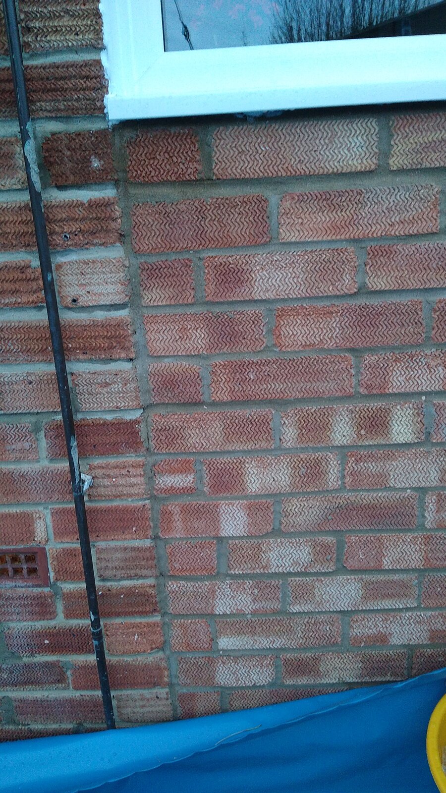

Core drilled through end of Lintel & metal showing

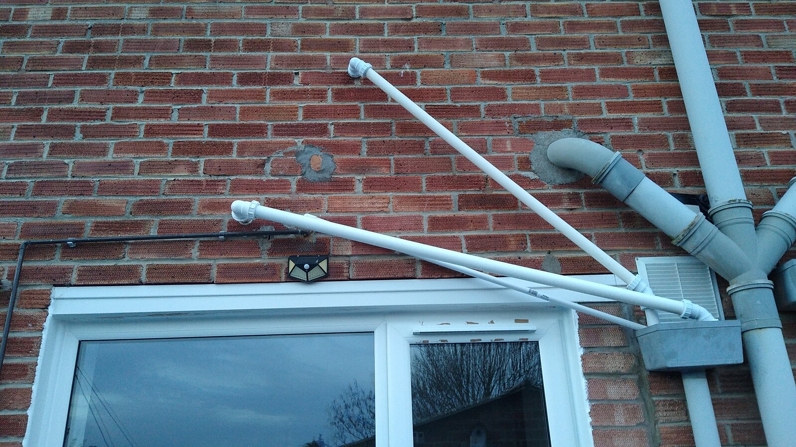

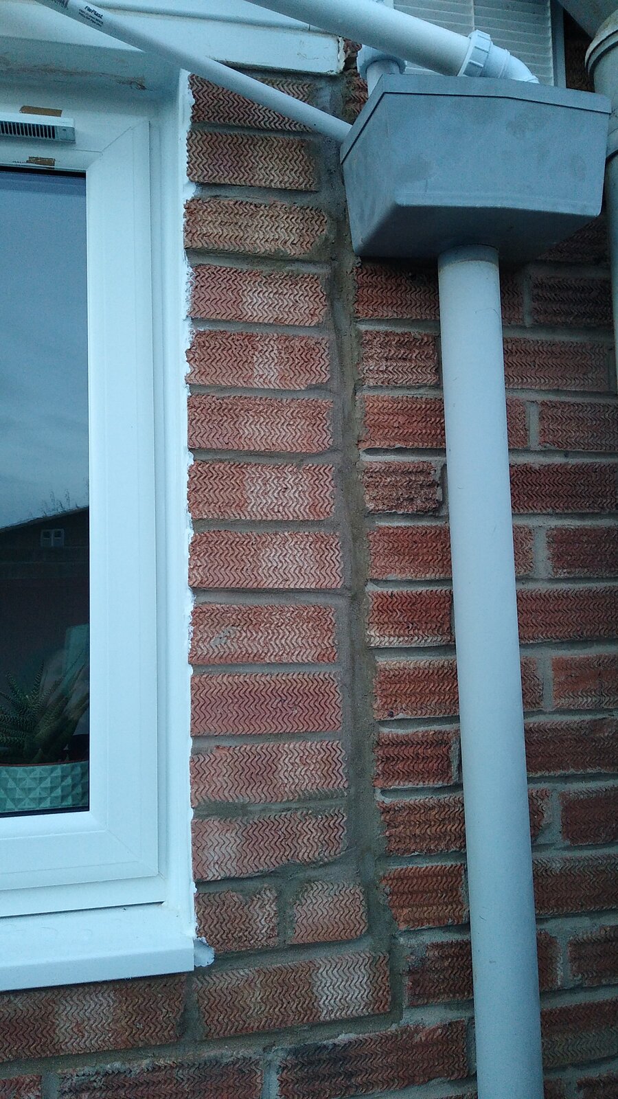

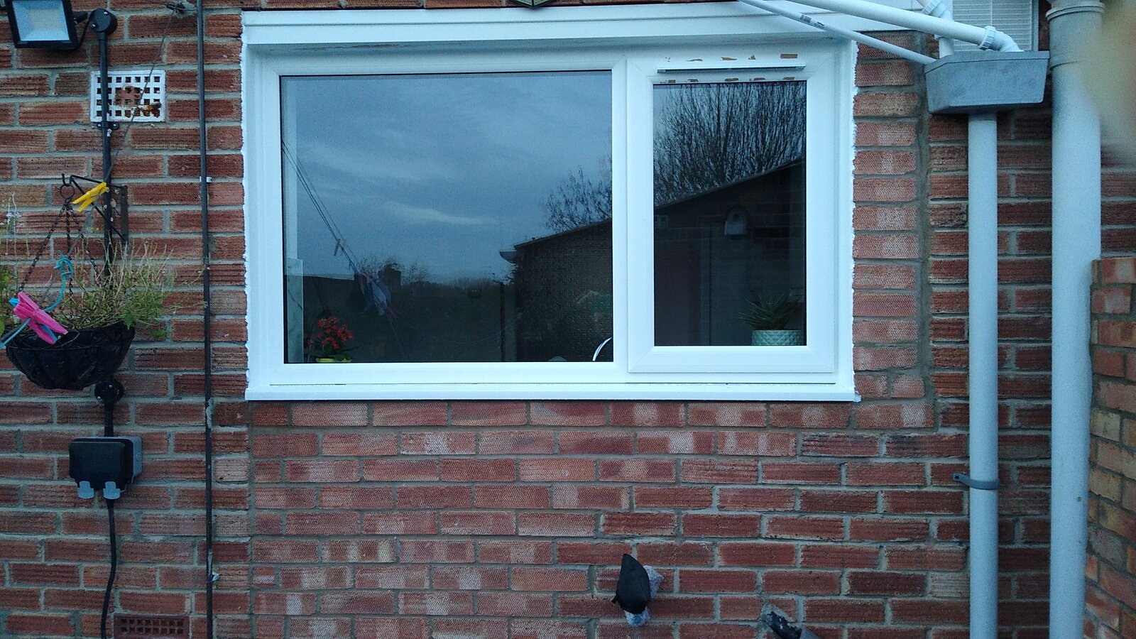

Ah I am beginning to see the potential problems now. It seems that from new the lineal is only on about 2/3 inch of brick but I am not sure if putting an extractor hole next to it is a major problem or not as its not like the extractor hole is below it. Also on the photo of the work being done the extractor vent looks lower and already there. Totally covered up by the hopper
https://www.diynot.com/diy/attachments/img_20230804_181646279_mp-2-jpg.324280/
It's difficult to judge from a photo, and partially hidden by the outside cowl, but the lintel maybe only not sits on perhaps 2" of the original brickwork, with a major part of the thickness of the upper part of the lintel having been destroyed by drilling, for the vent.
Basically, the house wall is sat on that lintel, and the only support for the lintel is the new, vertical row of bricks, which appear not to have been tied into the rest of the wall brickwork.
The builder obviously seems not to be very competent, evidenced by the drain work, and fitting the cowl upside down. Hence, the very real concerns over the structural integrity of the rest of his work.

Just spoke to Builder, I explained my concerns & he said .....
His bricky is very competent and the new row of bricks at the side of the window is correct.

Close up of brick work & pipes

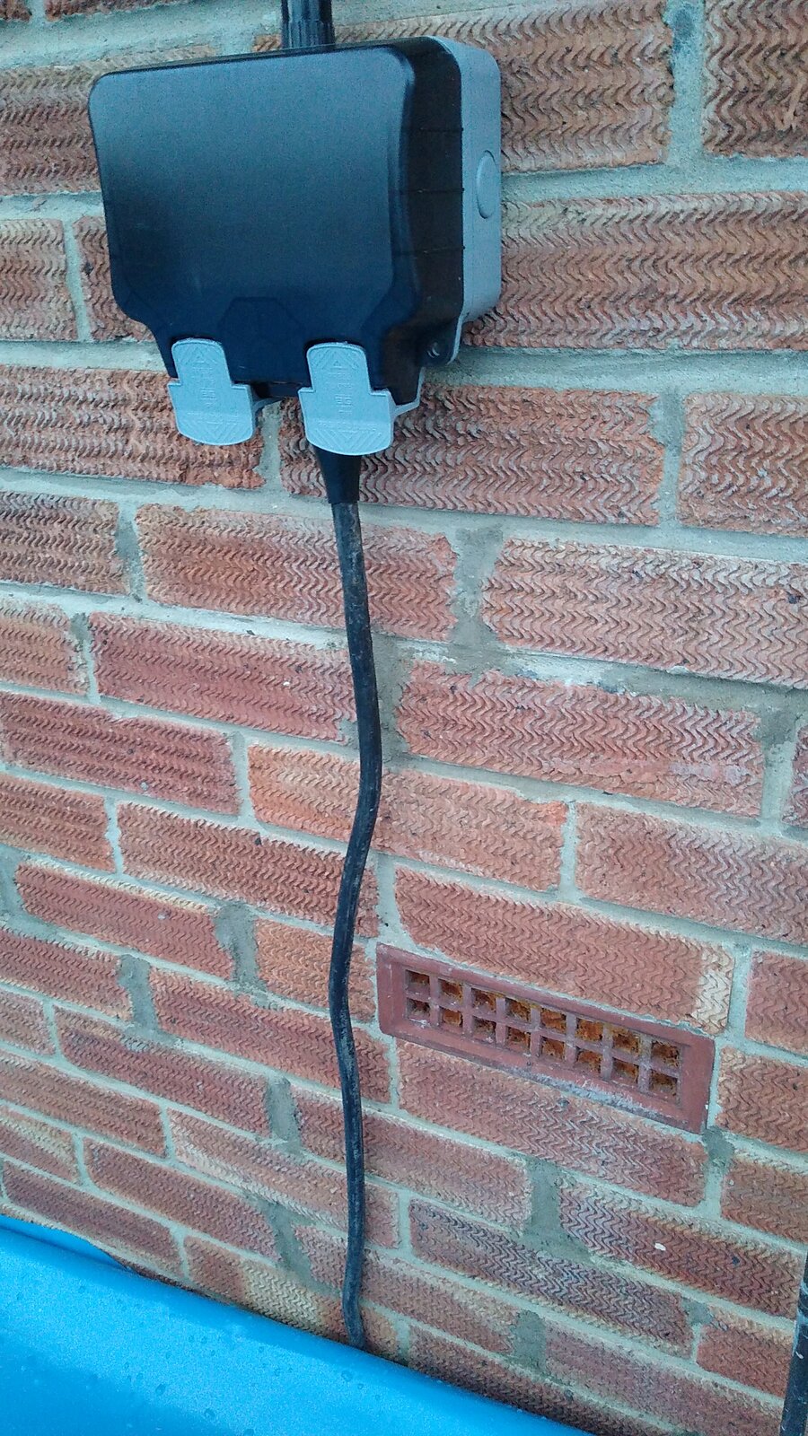

Outside Electric Plug Box ... concerned about loose cable ?

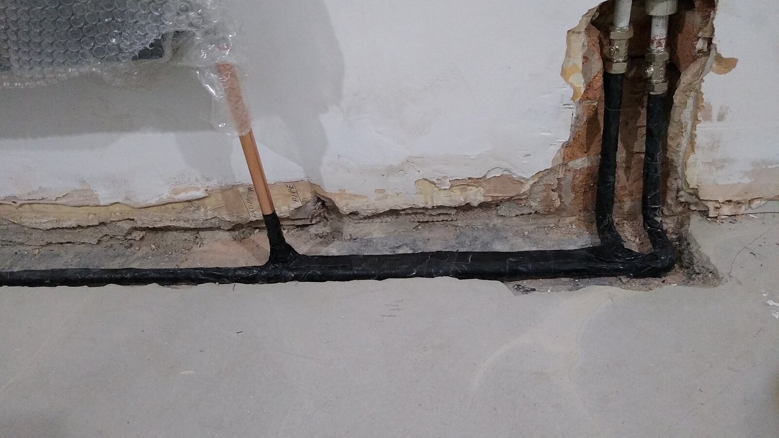

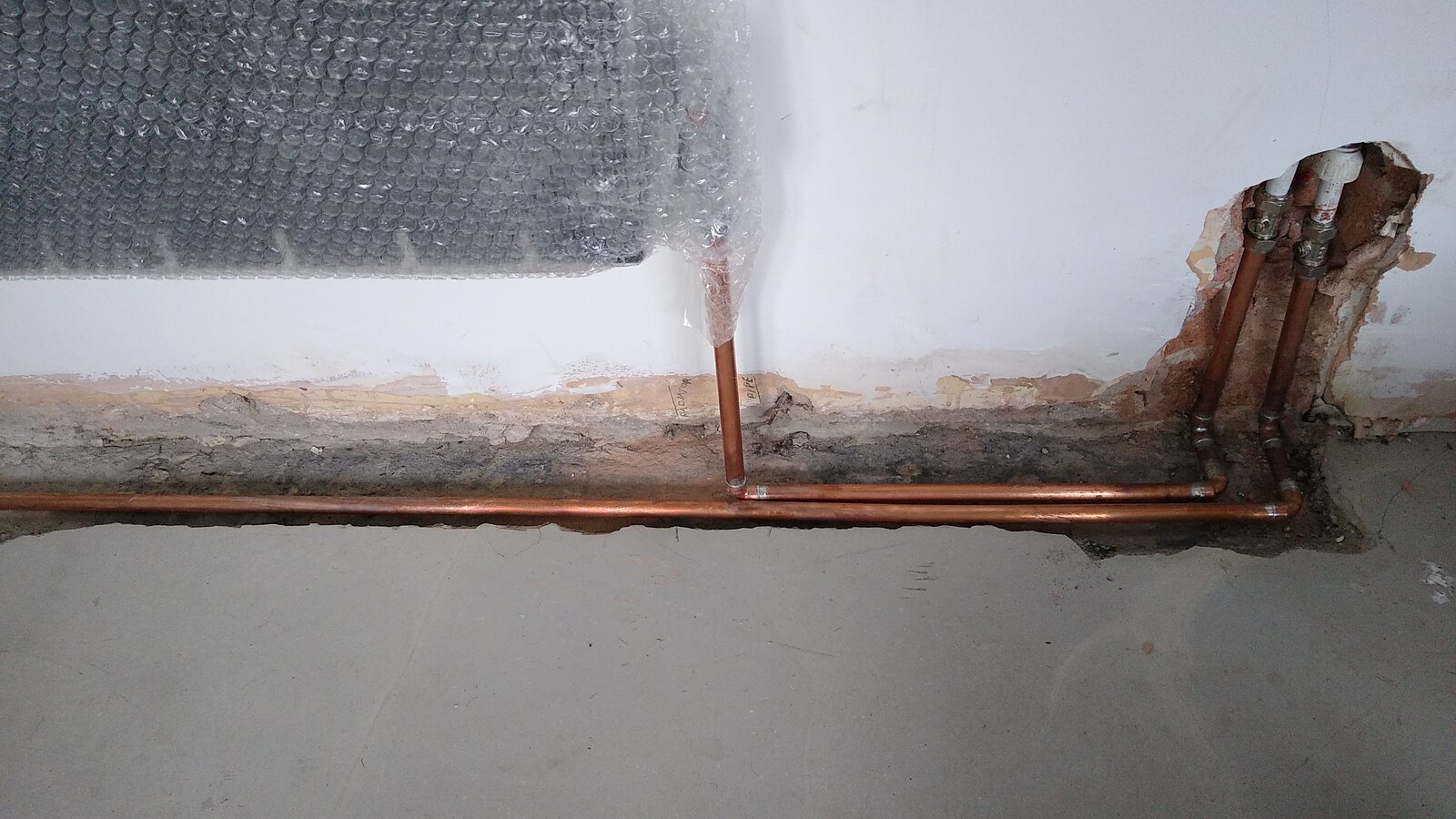

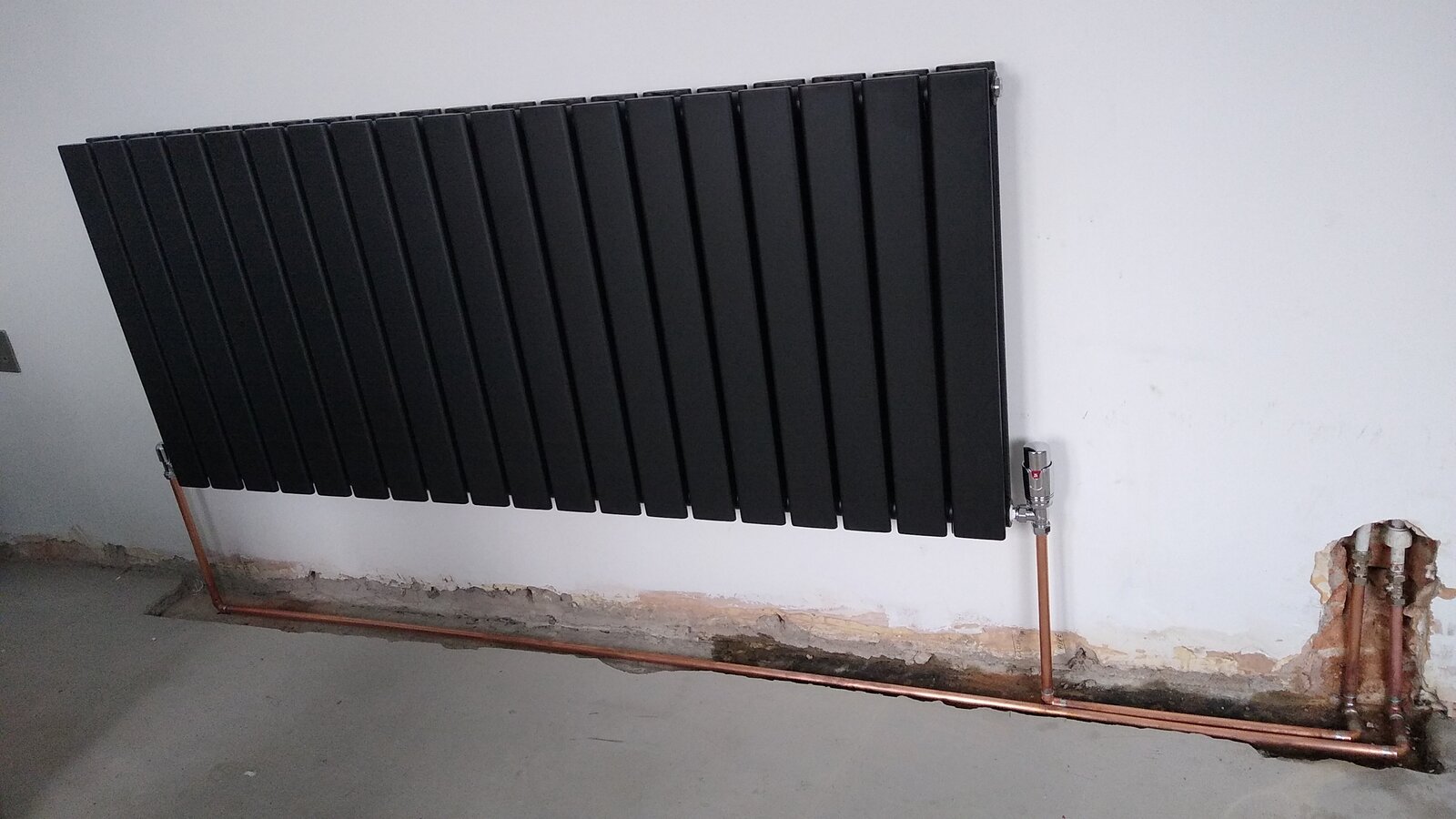

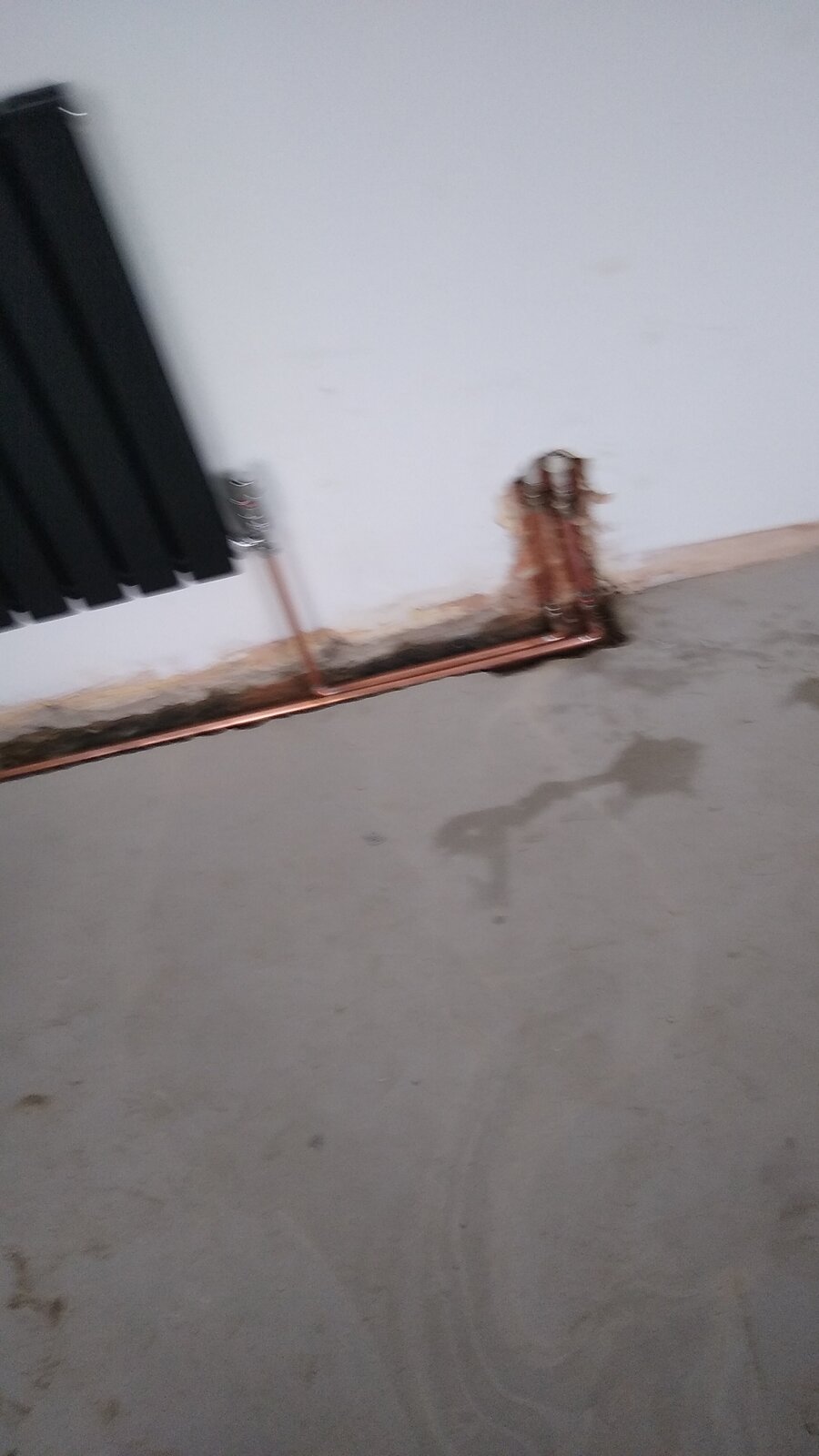

Radiator

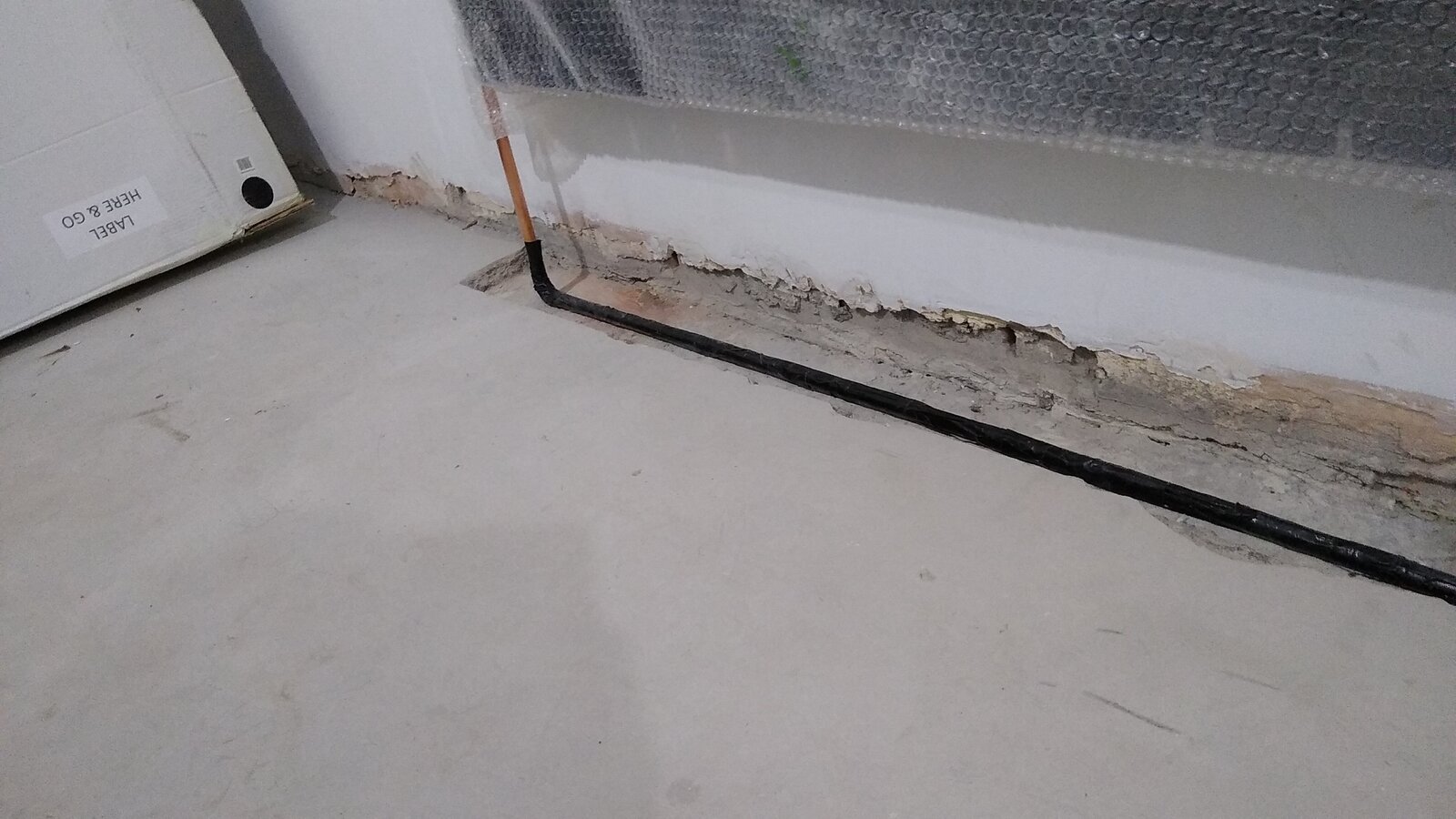

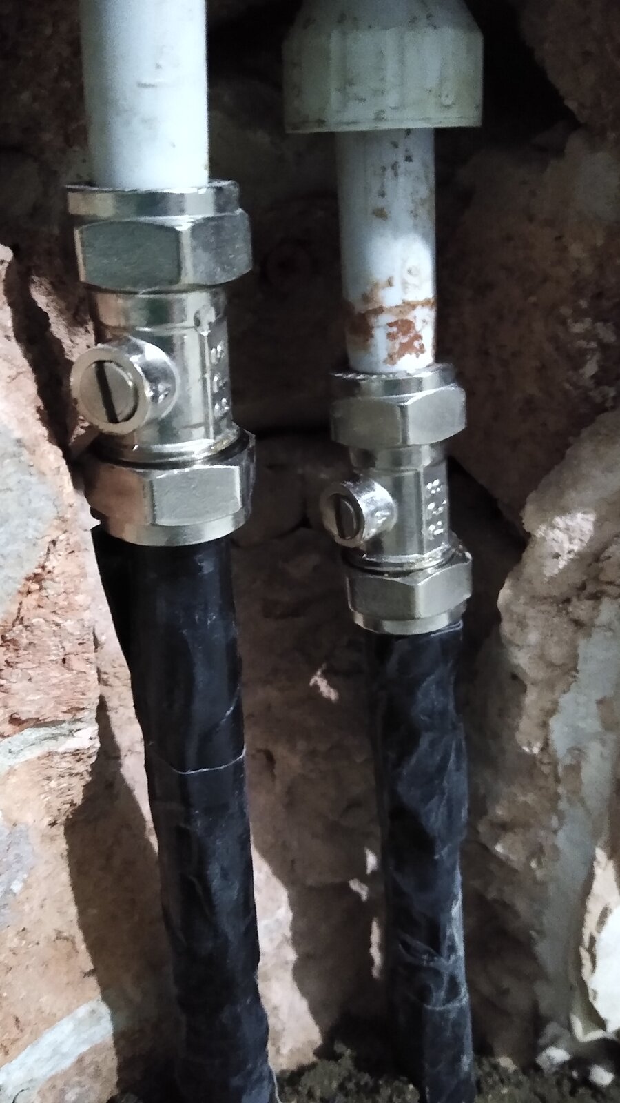

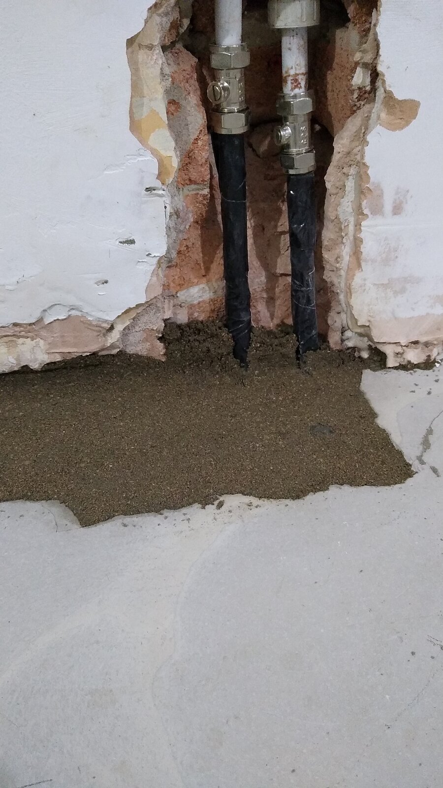

Copper pipes chased along edge of floor
Left copper exposed untill I mentioned it will deteriorate under screed, so wrapped in duct tape and laid screed on top.
I wasn't happy as no guarantee all the cooper pipe was covered so now agreed he would run pipes along wall but they no longer solder copper they use fixing joints now.
Is this correct way of installing a radiator?
Do you need a qualified plumber / gas safe engineer to install it ?
What is the black painted pipe supposed to be for?
What is that small white plastic pipe, running diagonally to the hopper?
Something else which has just struck me - Those white pipes which drain into the hopper, why is there a second hopper there at all, is the hopper and fall pipe into which it discharges, something your builder has added, or was it there originally? The thing is, grey water soiled water should all go to one underground set of drains, rain water all drains into another underground set of drains - usually, so the rain water can go strain to streams and rivers, untreated. The soil water has to be treated, and the water authorities do not like them mixed up, in fact it can be quite an heavy fine, if you do confuse the two. In some areas, they all go to one drain.
Lucky you caught that in time, the screed will attack the copper, plus the pipe will expand and contract, opening up the screed. So long as it's protected, it should be fine and allow expansion. Though they might push some out at the ends.
From what I can see, looks OK.
No, looks an OK job.
Did you mean 'compression joints? Those are all soldered joints, apart from where they must be compression joints..
The black pipe is an overflow pipe from Bathroom (been there since bathroom fitted). The piper runs out onto the path, no drain.
Small white pipe, condensing pipe from Boiler (there since boiler installed)
The builder just eplaced all the pipes which were already there.
Cut down the height of the large grey pipe to attach hopper lower down so he could fit in the vent for extractor .... Does that make sense ?
Yes, so not all your present builder's handiwork.
Compression joints - I'm not sure.
Builder said he would get his plumber to start again if I've concerns with copper pipes in screed (the duct tape did have gaps still showing the copper... I went over it myself with tape !)
So pipes are now running along wall ... His other plumber6 said they no longer solder (old fashioned way of doing it) and use some sort of joints, i don't remember the name I'm afraid
