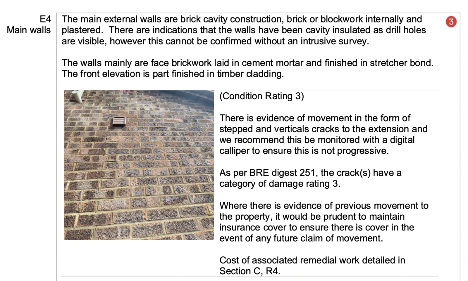

Hi,
I am a new member here, in the process of buying a 3 bed 2 storey 1970's house and have noticed cracking in the masonry where the rear (single storey) extension meets the building. The cracks are stepped and go through both the bricks and the mortar. The extension itself is around 15 years old and done before the current vendors bought the house.

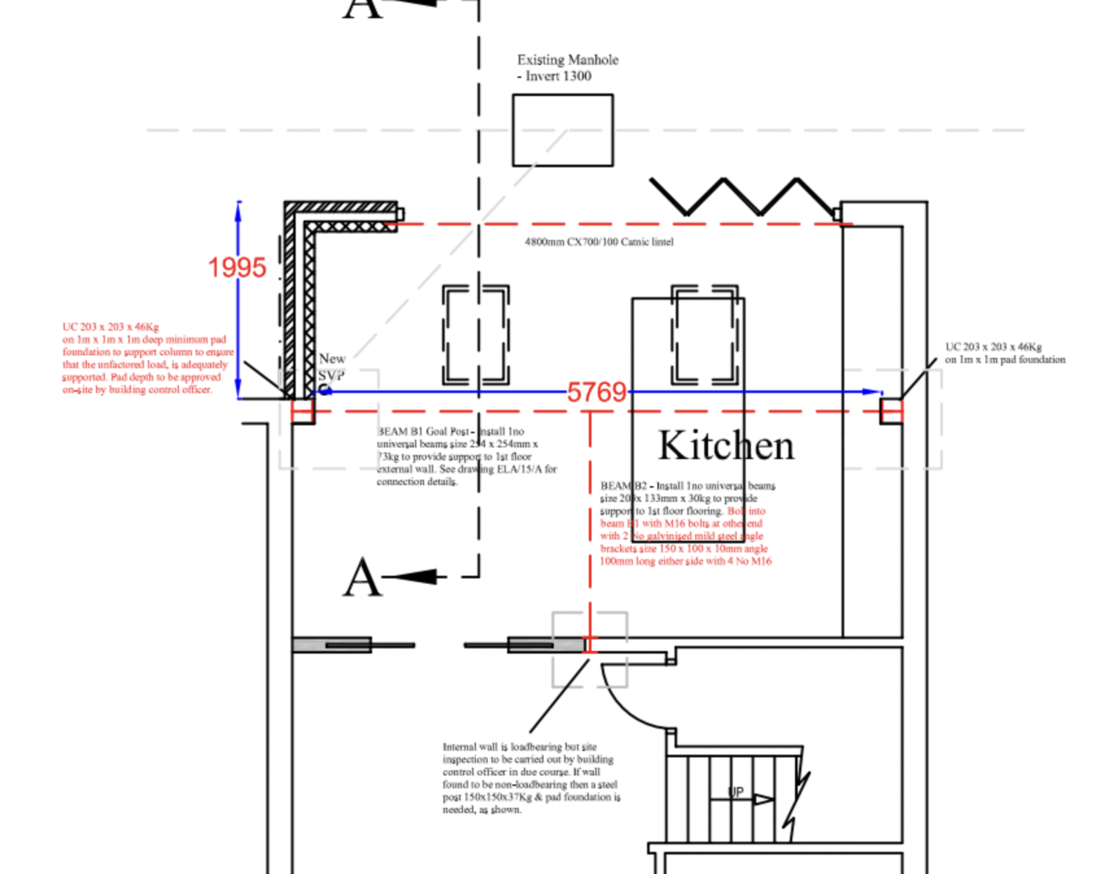

However, approx 3.5 years ago, the current occupants removed a load bearing wall (which ran in line with where the extension starts). A 5.77m RSJ was installed in its place, along with another smaller 2.29m RSJ bolted onto the centre of this RSJ (perpendicular, to form kind of a T-shape structure).
We have carried out a level 3 RICS building survey, however their only advice was to monitor the cracks for 6 months using digital calliper - Unfortunately we don't have this much time so I was hoping I could get some of your opinions on this. He also mentioned that he observed some of the insulation (using an acronym I forget) was also damaged behind the brickwork. He scared us by saying that remedial actions could be as far as underpinning needed if the cracks are progressive due to subsidence!? Thank you all in advance.

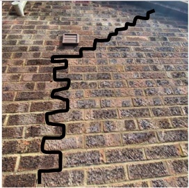

Photo of the cracking:

Building plan for the structural works (removal of load bearing wall):
Where are the cracks located on that floor plan?
The cracks appear to be directly under the RSJ. So the cracks start from approx 3/4 of the way up the side of the house, running up to where I imagine there RSJ sits, from there the cracks then further zig-zag diagonal up and to the right (ending by the pitched extension roof), if that makes sense? I will attach a rough drawing below...
Sorry, so to answer your question, it is where the rsj sits on the right hand side of that plan. (detached side of the house).

Is that crack in the photo much wider higher up or generally of even width?

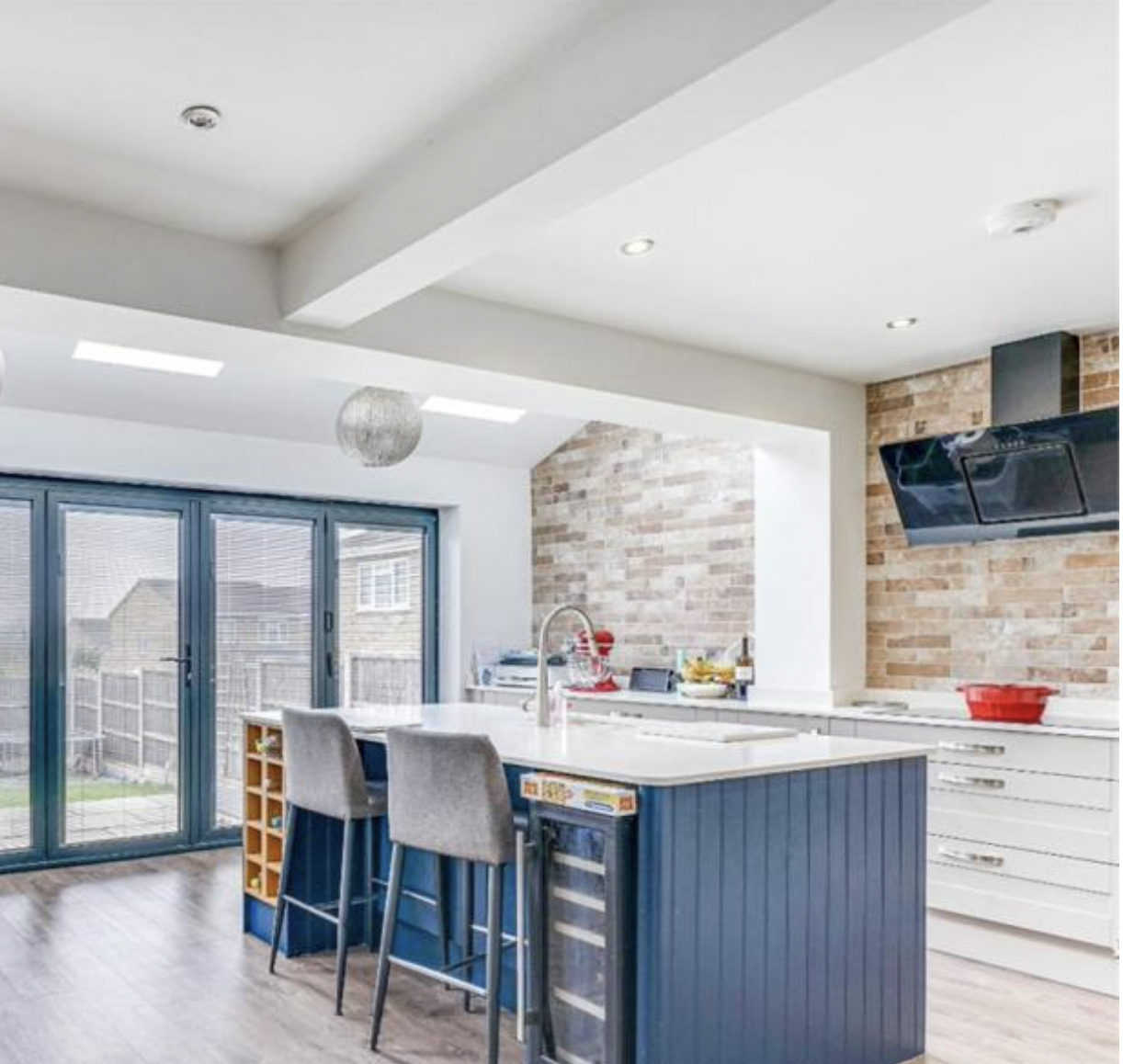

There are no cracks on the other side of this wall internally, but I suspect there may be plasterboard over the wall since it has a fancy kind of brick effect tiling (shown in picture below)
Picture showing the extended kitchen, the cracks are on the other side of the brick effect wall shown:

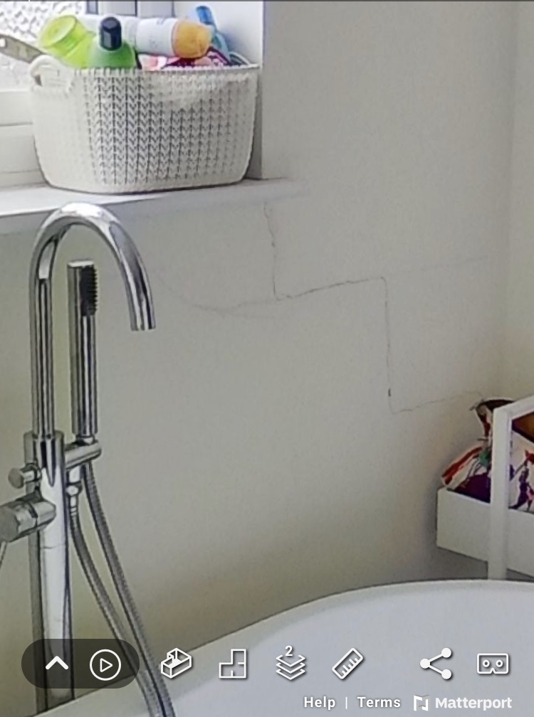

There are also some cracks in the bathroom above where the supporting wall was (I suspect due to poorly placed acros?):

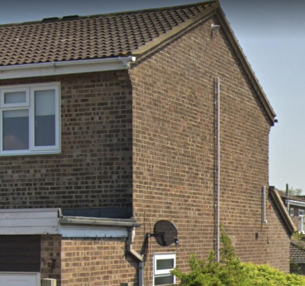

I don't have any more photos of the side wall unfortunately but I managed to find a full side profile on google maps:

What your surveyor should have mentioned is that extensions should not be tied into the house like that is, but should be tied with a metal tie that allows for movement of the extension - a flexible vertical joint.
This would mean that cracking like that is common when extensions are tied in like that, and although it's not the only possibility, he should have mentioned it being incorrectly built and a possible cause.
It's also a nonsense to advise some on-going monitoring for a crack in a home buyer's survey, when what you as a buyer want to know is whether to buy the place or not, and not that a crack needs to be monitored before any sort of opinion can be given.
But too many surveyors nowadays are either unable or unwilling to commit to any definite opinion, and will almost always shy away from telling you what you want, or more crucially what you need to know.
It comes down to assessing what cause is more likely than any other cause, and without making this an even longer post and going through all the reasoning, it seems that that crack is typical of horizontal movement and as such more likely to be related to contraction of the bricks, than anything else.
This is not a significant structural issue and a very easy and cheap repair.
  • It's in the right place
  • No movement joint
  • Evenness of the crack
  • Crack in just the external bricks.
  • The mortar looks a very strong mix
  • Looks like an old crack
  • Crack largely following the mortar joints
It does not appear to be related to the beam (those cracks above it appear to be installation quality issues), although that’s not the say that the beam is OK – you need to do the normal checks to satisfy yourself that it was designed and installed correctly.
However, there may well be some other factor not mentioned here which means that some other cause then becomes more likely, and so you really need someone to re-survey and comment specifically on this. I think it’s worth pursuing, and whilst I doubt that anyone will actually put their neck on the line and say “this is the cause, 100% sure”, if they follow the correct reasoning process they will come up with a most probable cause, and then you will be in a better position to assess the risk.
Instruct a structural engineer, tell them to comment on the beam and the wall, and you don’t want any long term monitoring or investigation suggestions, just an assessment of possible and most probable causes, and remedies – and costs.
Tell them to take a ladder, a level and to knock the neighbour’s door for a look at that side
Then you can decide whether to negotiate a reduction in the selling price or walk away.
