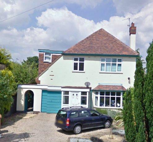

I have a hideous looking box built out of the side of my house with a flat roof (two first floor bedrooms). I'd really like to improve the look of this by having a "dummy" pitched roof built around the perimeter of the 'box' and blended back into the existing roof.
It wouldn't need to be a full-height roof (and wouldn't look right if it was) but maybe somewhere between 60cm and 1m vertical height (so the actual size would depend on pitch). The lengths are 3m - 9m - 3m. Drainage is from the flat roof sloping back to a gully where it joins the original house.
I've lived with this bloody horror for 20 years, and now I'm selling up and moving somewhere smaller I want it done to help a quick sale (I know I won't get my money back, but it should mean folks will at least view the house!)
I'm assuming this sort of thing is possible - but could anyone give me a clue about the cost? I really do want it done, but it needs to be a sensible "waste" of money :)

Oh, here is a google streetview photo of the protruberance
It's ugly.
It does not look bad at all IMO
The rake of the existing roof in front of it maintains the appearance of the main house, and the square/flatness of the roof harmonises with the square/flatness of the garage door and section of wall around the archway
I would not worry about it

It should look a bit better when the bright green trim is changed to black and the house painted white (black garage door).
I've always thought it to be awful, but my taste is often questioned! It does sound like it isn't worth many £k to put right.

I was going to say, repainting the trip could make it harmonise a lot better.
Pretty bad subsidence on that photo though :roll:
Careful if you paint house white - May look too bright :idea: Consider an off white shade :wink:
Thanks for the tip, Nige F. I'm fortunate that next door is white with black trim and to my eyes it looks very 'clean'. I will ask them and find out if it was "brilliant white" they used or some 'off white" however.
