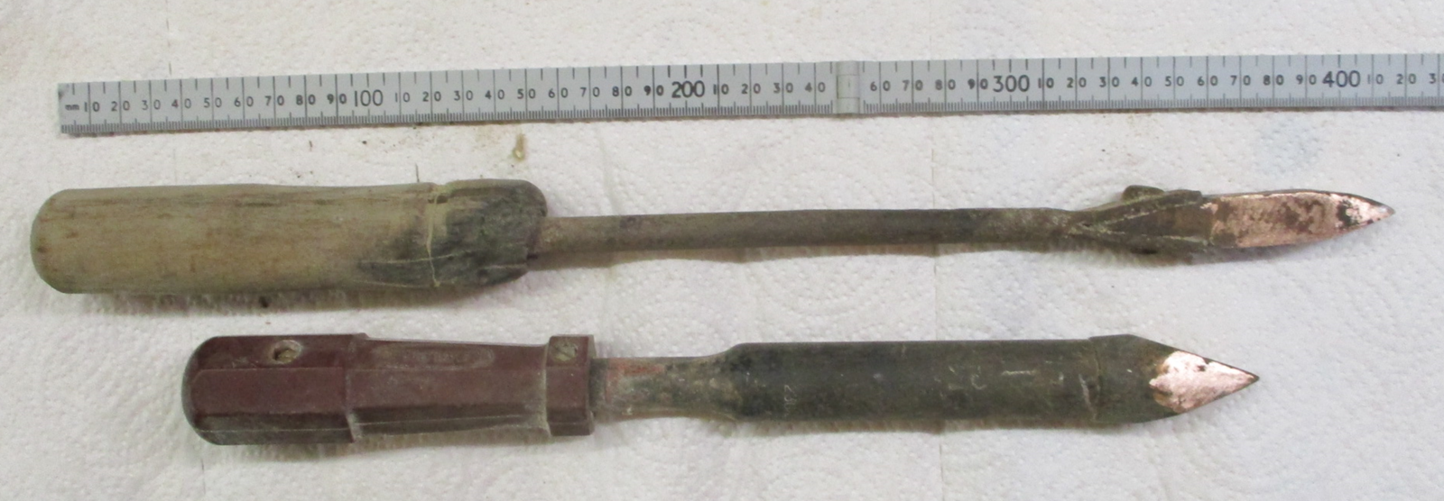

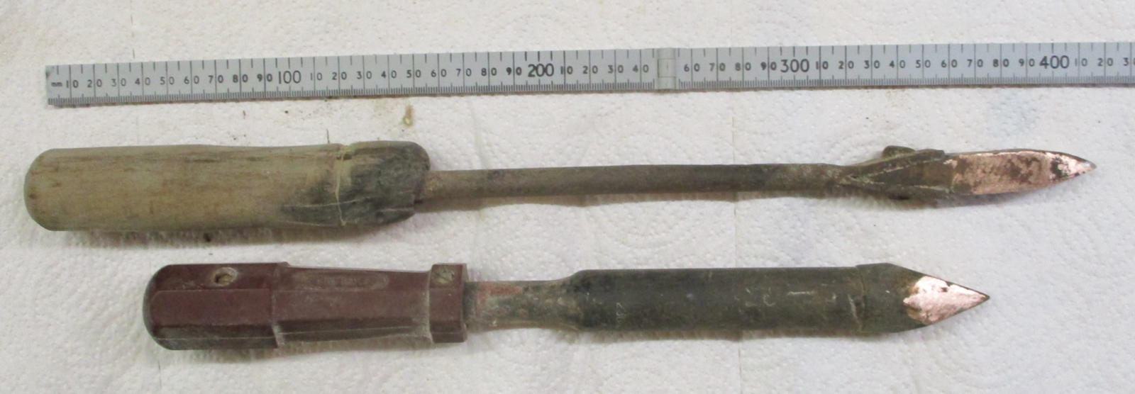

Same here, but I'm not sure I would call it particularly 'small' (upper pic below). I also have one with an even bigger tip which does 'do volts' (it says 240V) - or, at least, it would if it had a lead (lower pic) (with apologies for grotty photo!) :)

Ah but the bottom one is electric. If I had to guess I'd go for Solon or English Electric and 150 to 250W.
Indeed it is - as I said, that one "does do volts" :)

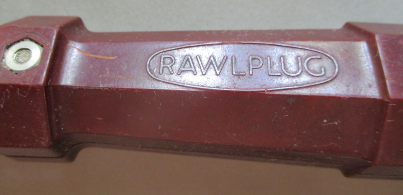

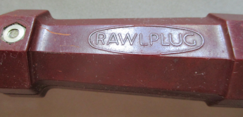

I might have guessed siumilarly. However, having cleaned it up, and somewhat to my astonishment, on the handle ...
The metal shaft is engraved with "230/250 VOLTS Made in England", but I can find no mention of power anywhere. I certainly have used it - the cable was removed because it was getting a bit iffy, and I haven't yet got around to replacing it - but, when I do, I'll measure the power!
