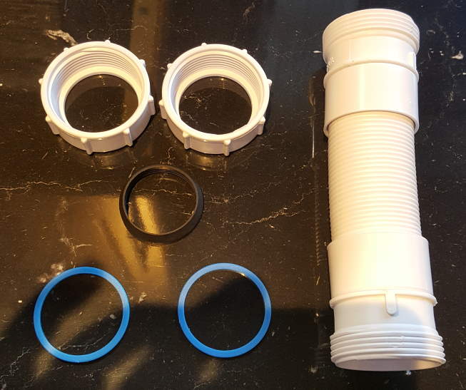

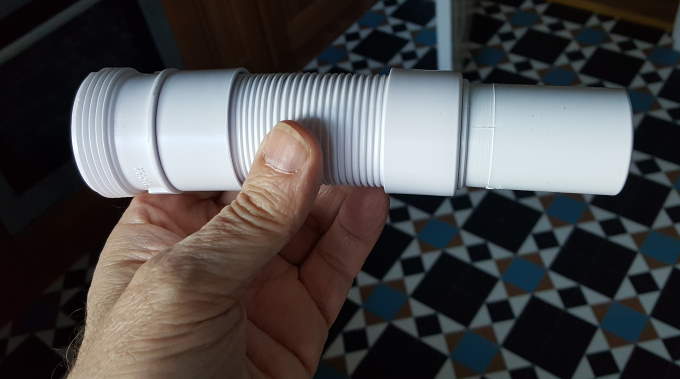

But I don't think I'm going to get away with this idea either. I reckon I could get the flexible pipe to fit - just - but the knurled "nut" on the bottom end is going to foul the water pipes I think. Won't know for sure till tomorrow.
Getting desperate now - I feel a Roger Bodge coming on, like just leaving the nut off the bottom, and sealing the waste pipe into the end of the flexible adapter with silicone. This is SO not how I like to do things, but it might actually work...
If you can't fit the nut inbetween the supply pipes ,then go for a mcalpine flexcon 5. Spigot end push fit into the floor fitting ,after removing the grey pipe. The other end is compression ,so short piece of pipe to the trap.
It's total length around 150mm to 200mm ( ignoring the length of spigot, which will be inside the existing fitting near the floor)

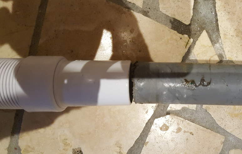

So. It now appears that grey and white waste pipes have different diameters.
The grey one is the one i pulled out of the push-fit bit in the floor; the white is the end of the flexible fitting.
The white one is about 1mm bigger diameter, and won't fit in the hole in the floor.
Now do you see why I get so f*ing despondent when trying to do what should be a simple job?

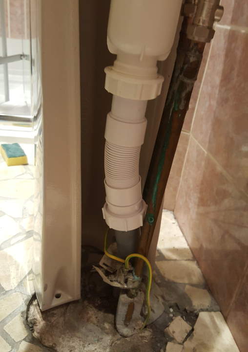

Cut a piece of the waste pipe to go into the compression end of the Flexi and back into the floor fitting ,make it long enough to clear the supply pipes ,but only just. Fit the piece of pipe into the compression fitting and tighten it ,then push into the fitting at the floor.
Raise the trap as high as poss ,and the spigot end of Flexi into the trap.
You can cut a bit off the spigot length ,if need be.
That's the ticket !! But the spigot looks as though it may not be fully inserted into the trap ,is it ???
The copper pipes could do with cleaning up with abrasive strip's ,someone's gone a bit overboard with the flux ,and solder !!:D:D:D
I didn’t cut any off the spigot, so you can still see a fair bit of it – it is fully inserted though. Just ran the tap for about 20 minutes – no sign of any leaks SO FAR. Just heating the tank now to run a few gallons of hot through it, in case that does something.
