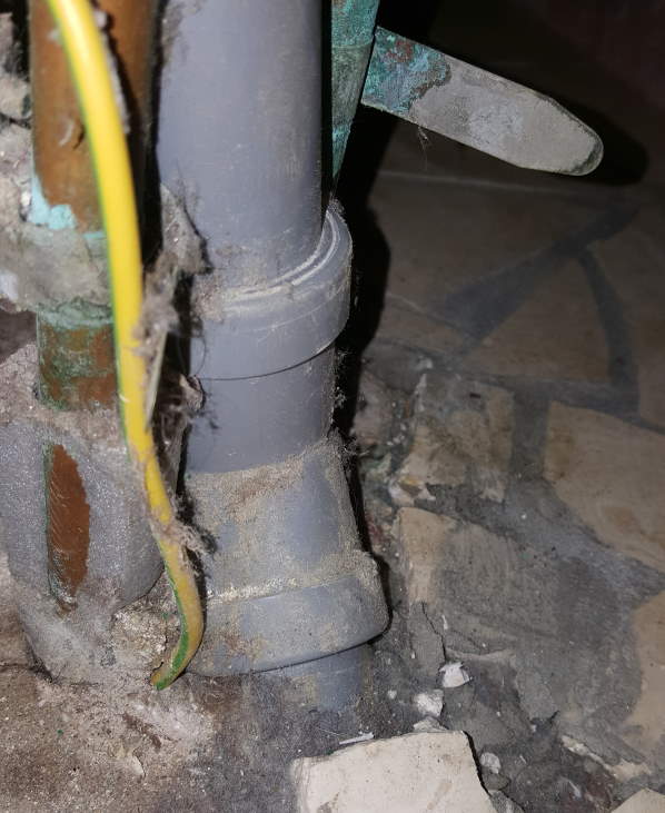

Yeah... so here's the next problem - from the joint in the grey waste pipe near the floor to the bottom of the compression joint on he trap is only about 8". Not sure if the flexi pipe will fit... nothing's ever simple in this house :cry:
You mention a joint ,low on the waste pipe , is it a push fit elbow ? Can you access the joint / remove the pipe ? And more importantly fit pipe back in ?
If so ,remove it ,warm it ,and bend it to required angle . Possible ??

I fear it's an adhesive joint... hard to see what's going on down there, but girlfriend's up now, so I'll try and get another look...
OK, here we are:
That's a push fit fitting. Your trap is extendable ,so can be pushed upward to gain space. What is the length of pipe from fitting to trap ? It looks to me to be much more than 8 inch ?
Top of floor fitting to bottom of compression joint on trap is just a little over 8". The telescopic bit at the top of the trap is extended about 1½" at the moment... so I suppose I might get lucky :LOL:
