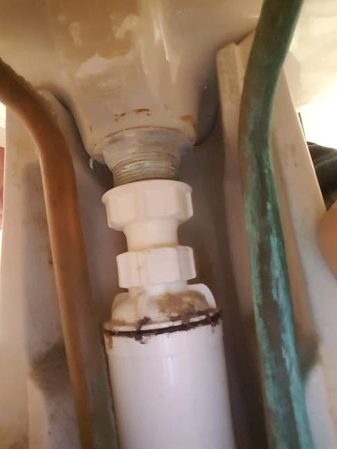

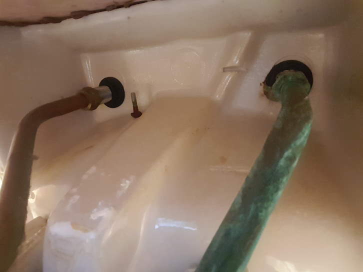

Well I think I’m going to have to lift the sink off, as the main reason I’m doing this is actually to replace the waste, which is horribly corroded – chrome totally gone etc. The taps don’t actually need replaced at all! But the waste is totally inaccessible, so I figured if I have to lift the basin, I might as well replace everything, hopefully do it right, and not have to touch any of it for another 25 years, which should see me out!
But if any magicians out there can tell me how to replace that waste without being able to even see it (I used the phone in selfie mode to get those pics), I might leave the taps alone!
Probably need to remove the basin. Its sometimes possible to ease the pedestal out ,just enough to get access to the big back nut ,but that depends on a number of things like ,is the pedestal base encapsulated by flooring / tiles etc ,and can the basin be eased from its wall anchorage sufficiently ,is there any play in the pipe work.
A judgment call as to if its gonna be quicker to just take the basin out.

The basin was very loose when I moved into the house, and the entire ensuite is fully tiled, so I had to silicone it to the tiled wall, as the fixing screws were just rotating in their holes. Not really how I'd like to have done it, but I couldn't see any alternative. But at least I know how to remove it again... and the base just fits into a slight recess in the floor.
My plan – unless you advise me differently – is to remove it, take everything off, clean it all up, install new waste and taps; flexible tails on the taps; fit isolators to the risers; and hope I can get it all together again without leaks :eek::eek::eek:

Looks to me that you have plastic backnuts, or at least one and two thirds of them, which might account for the discoloured copper on one side..
