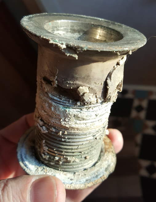

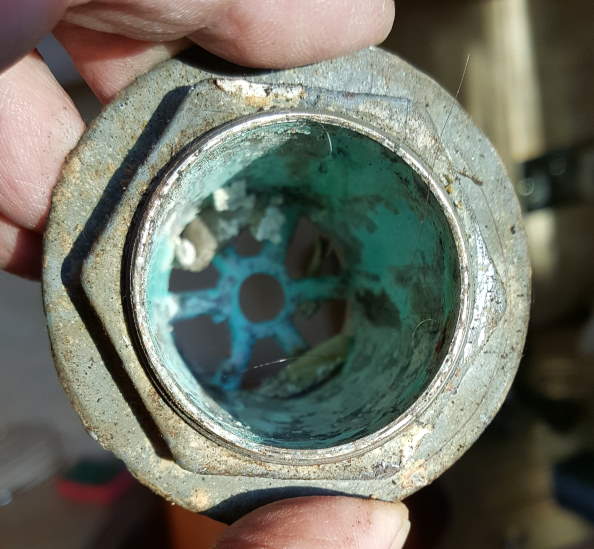

I like to keep you all entertained here, as a kind of payment for all the valuable advice… as mentioned above, the main reason for doing all this is that the waste is horribly corroded, and it mings from time to time, no matter how much bleach etc I chuck down it.
The pedestal is very narrow, and the water pipes completely obscure the waste pipe, no absolutely no chance of doing anything with the waste without removing the sink. Sink is siliconed to the wall, so can’t ease it up and lift the pedestal out, unfortunately – it all had to come down (big saw knife down between the basin and tiled wall).
Anyway, taps, waste etc removed from the basin now, basin all cleaned up and ready to reassemble with new taps, waste, and trap. For your amusement, here’s a piccie of the waste I took out (which took a LOOOOONG time and much swearing, as it was badly corroded and all fused together). Think somebody overdid it with the Plumber’s Mate, or whatever you call that stuff…

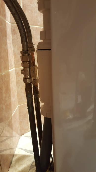

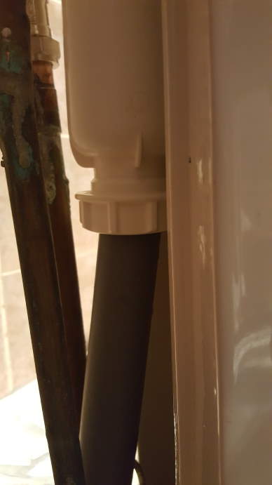

On the last stretch now, hopefully, but still a problem as always… taps, water pipes all done, and no problems; but can’t get the waste to seal. I’ve fitted a new rubber seal and fibre washer, but the problem is that the waste pipe coming out of the ground is at a slight angle, and he trap isn't. At least I assume that’s why it’s leaking.
The leak is slight, but I can’t leave it like that, can I… there’s no way I can see of straightening the waste pipe, as it’s concreted into the floor, and pretty short. I’m working in a very cramped space too, making everything very awkward.
Any suggestions please? I have to use the “S” word, but must I resort to silicone?
Your correct it's the angle of the waste pipe meeting the trap ,if your sure it's leaking at the bottom of the trap. Check the top end ,to be certain it's not leaking higher up and misleading you.
Can the waste pipe be moved to be close to the wall ,is there any play ?
If so you could change the trap for a small bottle trap . Use an elbow and coupler to marry up.
Cheers Terry, but it’s definitely leaking from the joint between the bottom of the trap and the grey pipe coming up out of the floor. If I move the joint slightly, some more dribbles out. I always wrap a dry bit of bogroll around all the joints, right up to the basin, to check for leaks anywhere.
Unfortunately not… the whole setup is perfectly designed to frustrate me at every turn. The pedestal is narrow, and the hot and cold pipes block the opening at the back of it – there isn't any space to get the waste pipe through.
Somehow I’ve got to get this joint to seal :sleep:
Maybe possible to introduce a short flexible waste pipe. Cut the one from the floor ,make it shorter.
Was going to suggest that, but didn’t want people to judge me. :oops:
Is that because flexible pipes are generally regarded as a bit naff, or is there another reason? Must admit, I'm considering it (if I can figure out which one to get...)
Rigid waste pipes makes for a neater and more professional job ,and offer less resistance to flow ,and as the inner walls are smooth are less likely to hold solids and blockages.
However they do come in useful ,and in your circumstances won't cause any problems and behind a pedestal ,not to conspicuous. And will solve your misalignment problem fairly easily.
