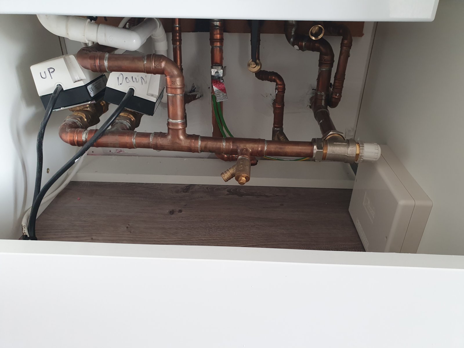

Well I am not quite sure what it already has but there are two boxes wired in marked upstairs and downstairs but these have no lights or buttons on them and sit just inside the boiler cupboard
They could be motorized valves but could you post a pic of the two boxes, just to make sure?
It would appear it's a danfoss wiring centre on the right and two electronically activated valves so my question would be, where would I wire the DBR RF relay.
