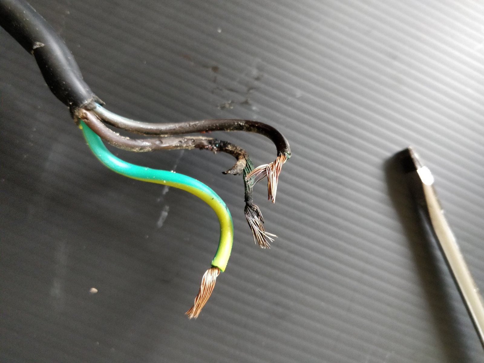

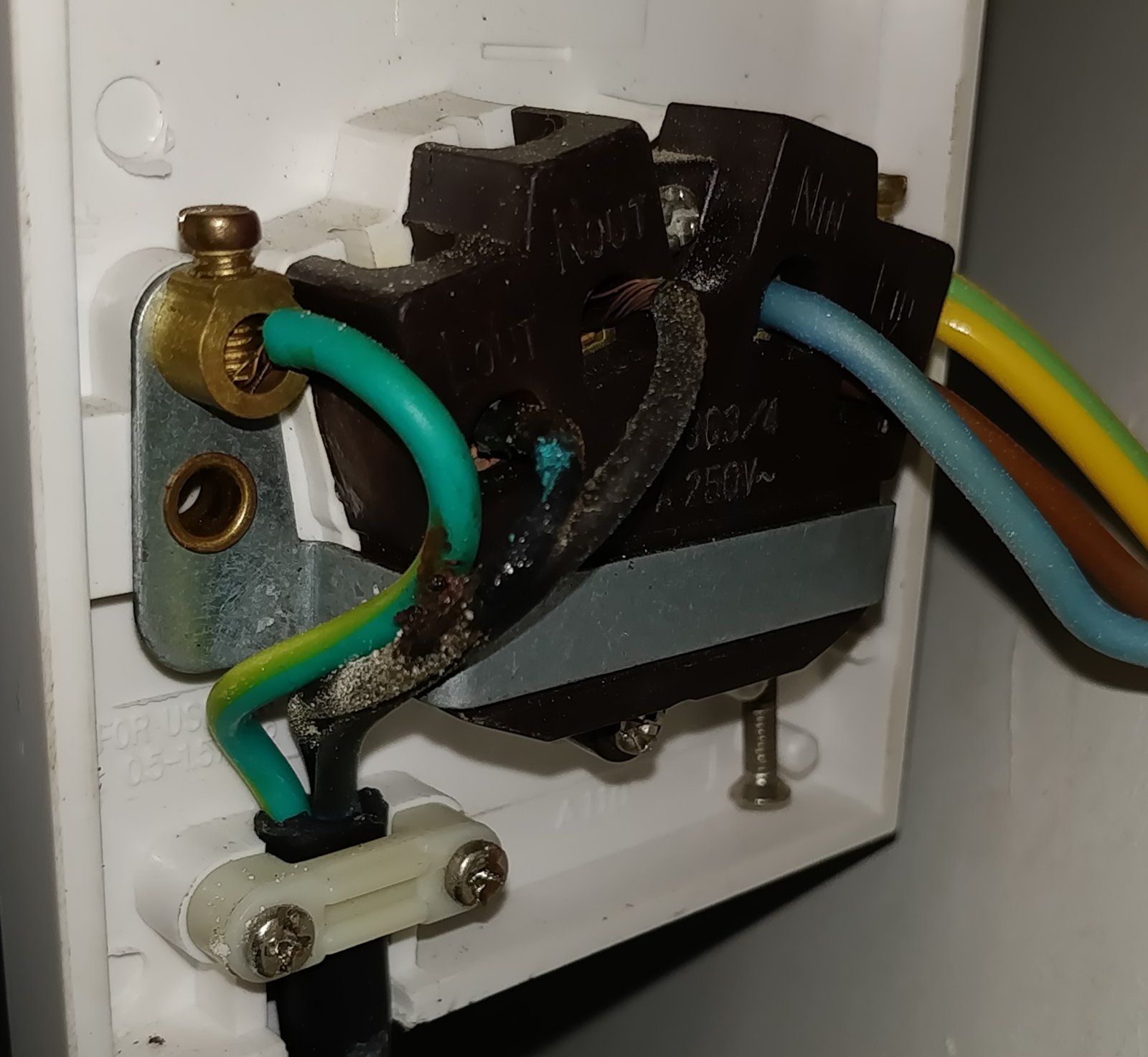

We are in a new build, approx 5 years old and today the electrics tripped. I traced it down to the dishwasher and found that the mains cable had not been tightened at all resulting in it getting hot and melting the insulation.
Should I be worried that this could have caused a fire?
Is there any way to test the rest of the house or do I need to inspect the rest of the appliances as I have no faith in the builders electricians now?
Here is a picture of the cable.
Another picture.

That was probably done by the kitchen fitter rather than the electrician.
One good thing: the RCD did its job
Yes it could have caused a fire. Not a bad plan to open up and check all terminations (isolate beforehand of course), guaranteed you'll find some loose, some with excess copper showing, maybe some reverse polarity or no earth link from backbox to faceplate, and you'll almost certainly spend longer doing 1 circuit than the original installers were given to 2nd fix the whole house
Cant see that it has been said already, so will say it, Ensure you replace the spur/flex outlet as well as cutting back teh cable, the terminals will have been damaged by the heat and shouldnt be re-used
Preferably with a plug and socket. It will make it much easier when you come to replace your appliance.
Thanks for the advice. Will try and check some of the other connections in the kitchen when I get time, bit tricky as it is a fitted kitchen with all the wiring behind. Will also look at replacing the outlet.
