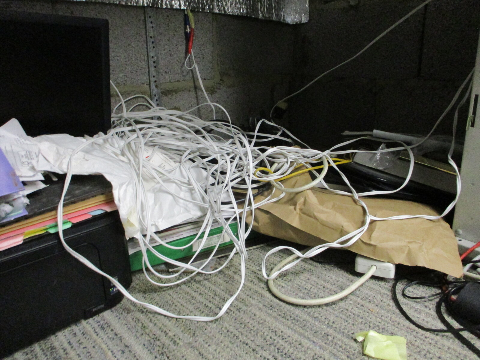

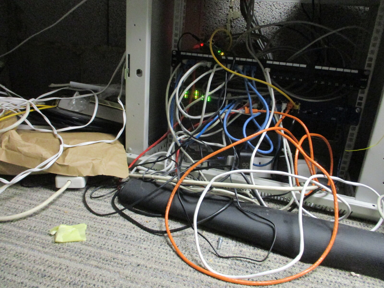

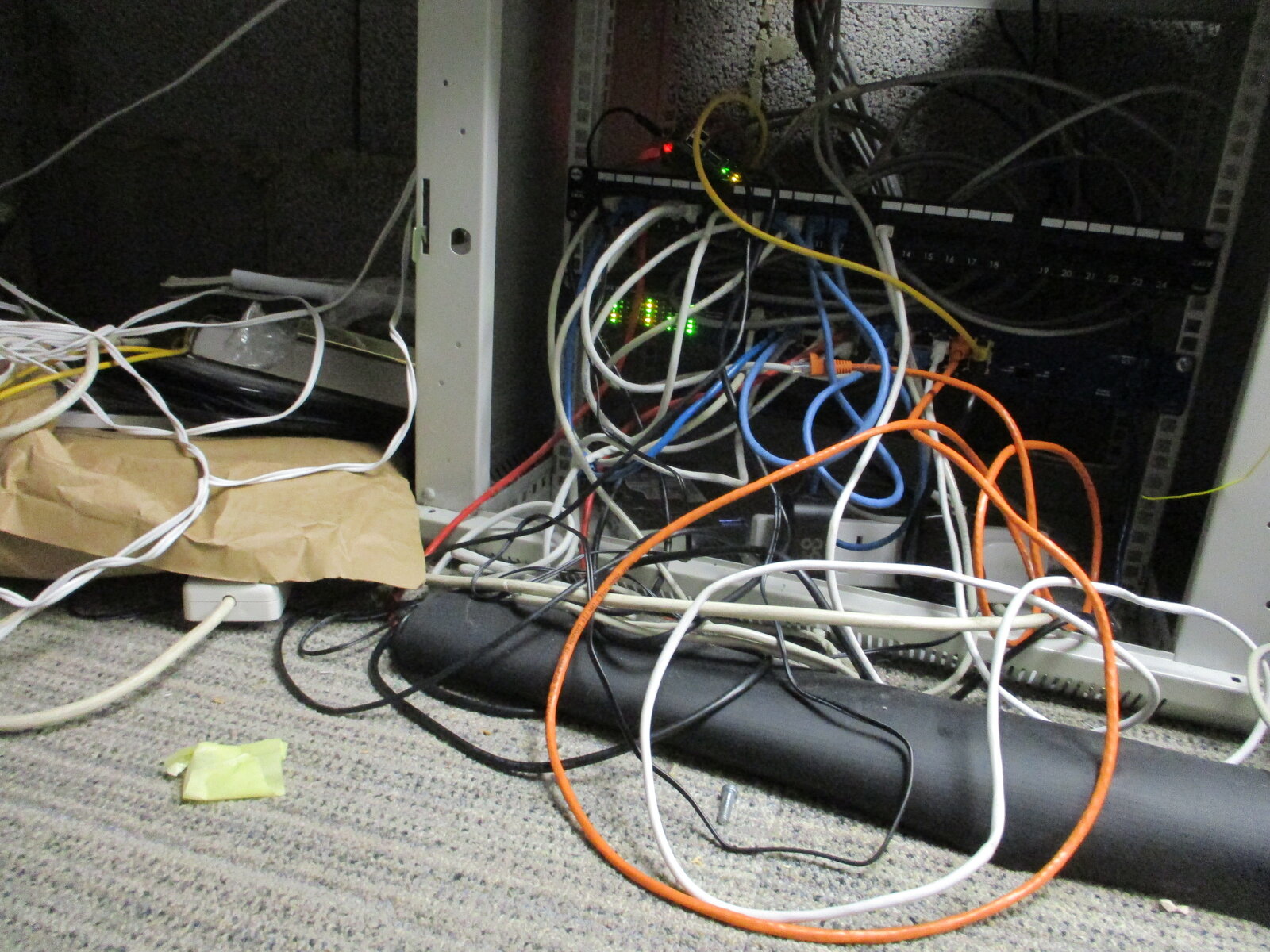

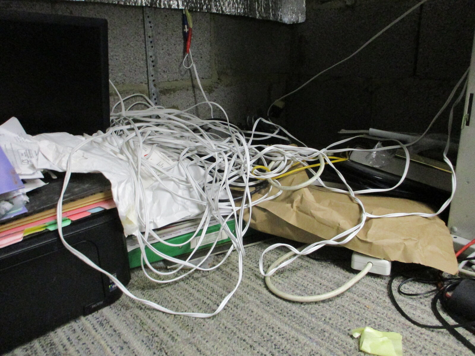

Data Cabinet Help
keep the cable nice and tidy in the cabinet as well
1,342m of cable terminate here
And keep the cctv cable nice and tidy too...
