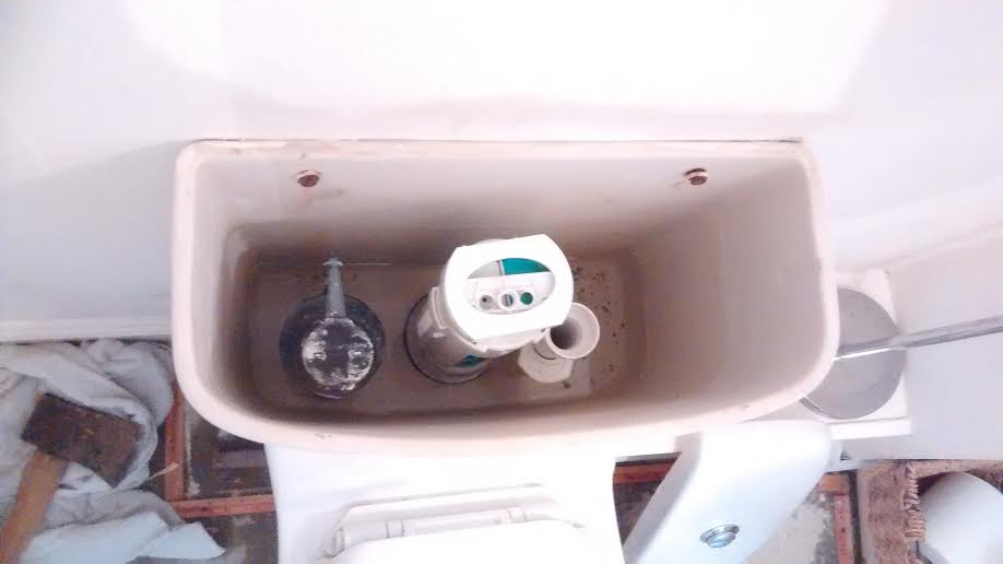

Well, I got my hand round the back and he felt the inlet pipe, and it was a little wet to touch. So, probably just a leak. But a pain to fix as need to rip out that cover. Have shoved towel in there for now!
Need a new fill valve. Leak got worse today, but I managed to find the isolation valve ...

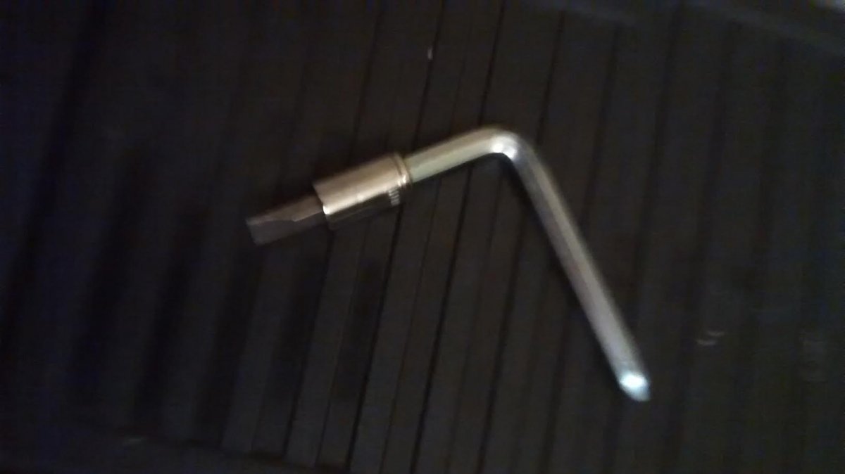

And after some action with the ax (and a mallet, and a large screw driver) I had to fashion this tool to turn the valve, which was facing the wall!
I really should get some new tools!

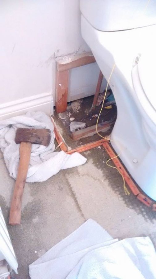

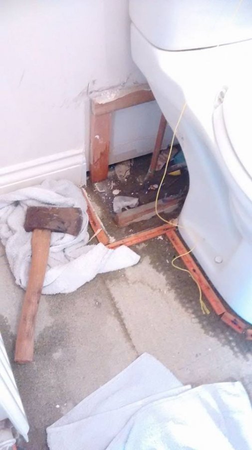

This photo better shows what the ax achieved - the wooden casing was put together with nails. Barratt Homes obviously have a lot of faith in the longevity of their plumbing!
