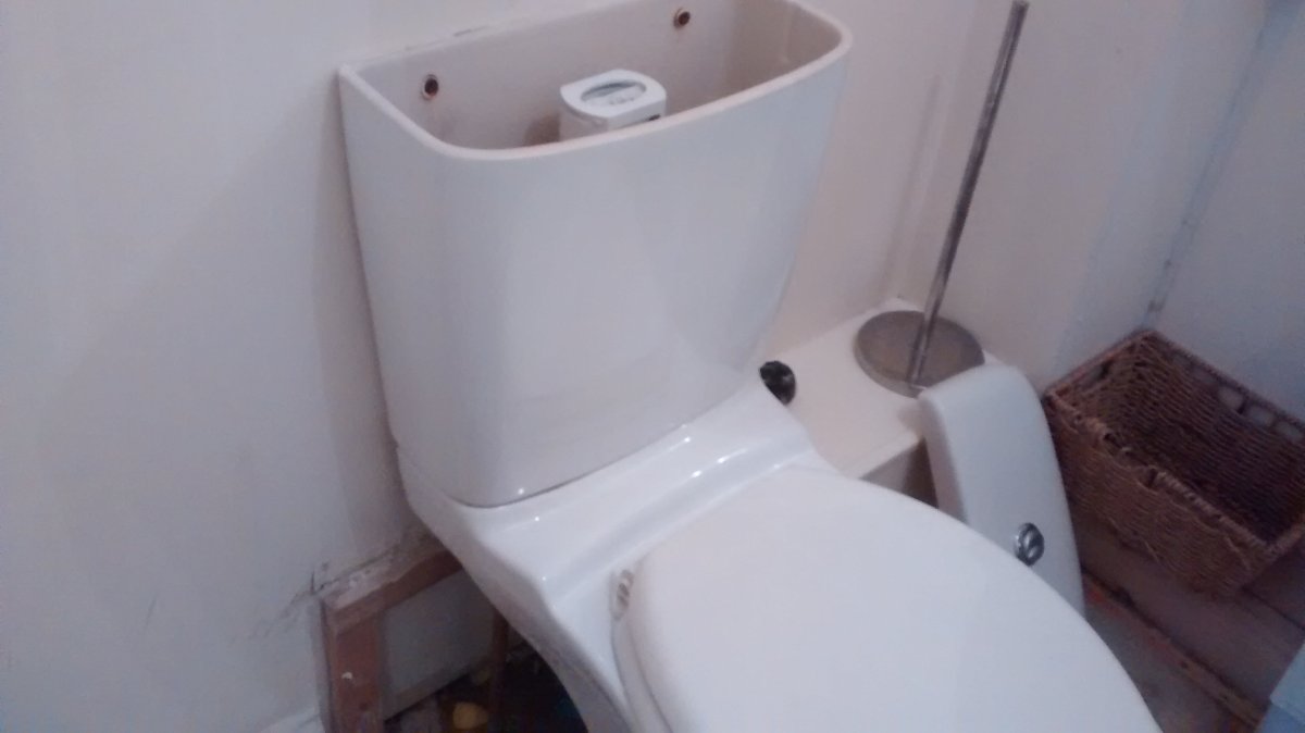

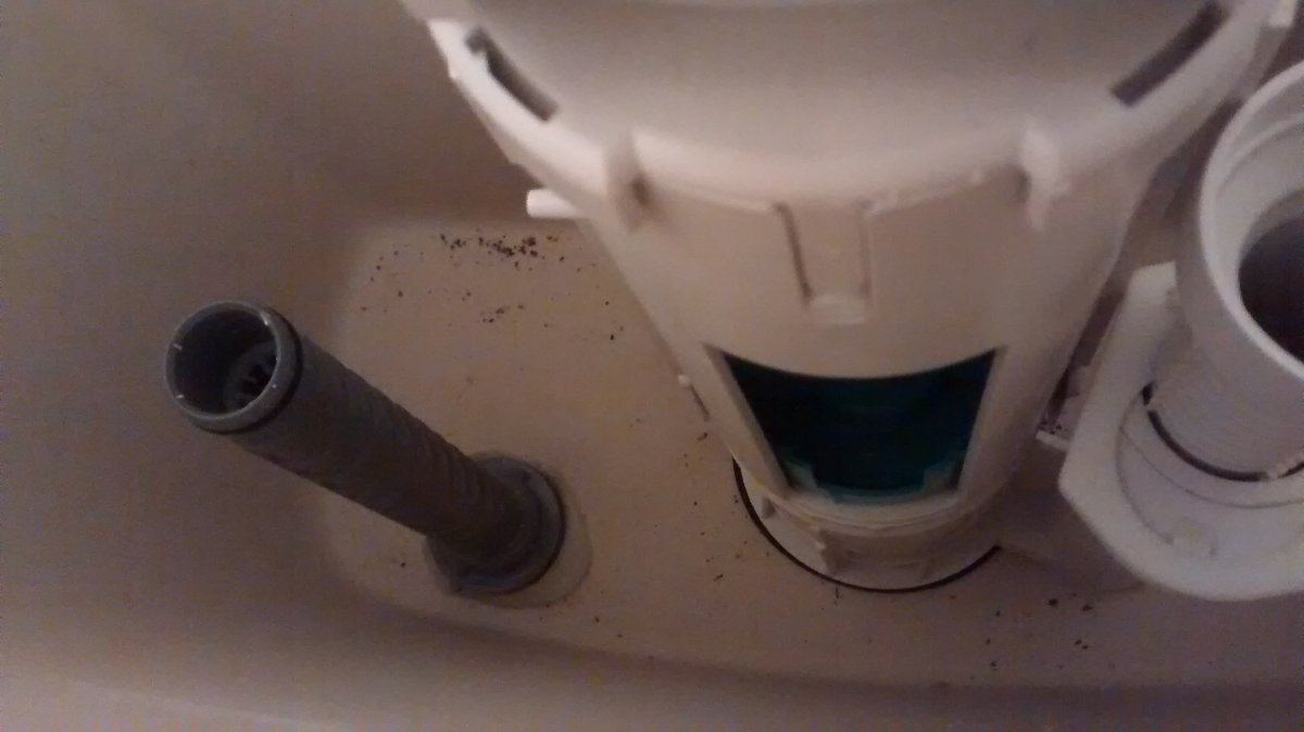

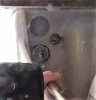

How do I get the fill valve out????? CAnnot get hold of that nut, and when I did just about manage to with an adjustable spanner, turning the top of the fill valve (I removed the toppest bit) would not budge. Just spent about an hour sweating over it. Almost ready to call a plumber .... but, maybe one last try. I really want to be able to do this stuff myself, but it is just so damn tricky!
Maybe, I get break the top part and send the whole lot down?
that looks tricky to get at,you may have to take the cistern off the pan,then it's easy.or if you have a new valve ,turn the old one anti clockwise ,may loosen it .a box spanner is the better tool.
I already thought about taking the cistern off, but, the valve is holding it on ... I need to remove the valve to get the cistern off.
I did think, if I can take out the flush unit, I could possibly saw through the plastic pipe below the fixed washer bit (what is it called?) and then it will just fall down. But, will that just create another problem ....
if you have seperated the supply pipework from the filling valve threaded tail , then the cistern can be taken off the pan ,once the screws holding cistern to the wall are removed ,and the two bolts that hold the cistern to the pan are removed as well. the white back nut that you are having difficulty getting to does not hold pan to cistern.it only secures the fill valve to the cistern.
But, the fill valve is in the cistern ... and the nut under stuck. .... maybe Ideal Standard is not such a great name for a toilet after all ....
