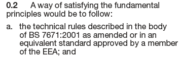

Quite possibly - and equally possibly the 'associated documents', as per this example ....
.... The original Approved Doc P which, as far as I am aware, is still the 'current' one in Wales, includes this advice as to what is deemed to satisfy Part P ...

As I've reported before, a friend of mine who has recently retired from a long career as a lawyer involved in the drafting of legislation for a series of governments explained to me the probable reason that this legislation did not simply refer to "the current edition" of BS7671.
She said that they were extremely reluctant to have legislation which required compliance with any third-party material (Standards, Regulations etc.) which were not available for government and members of both houses of parliament to study, if they so wished, prior to the legislation being voted on. If, by requiring compliance with "the current" edition of BS7671, the legislation would require compliance with editions not yet written, those future editions might contain requirements with which government/parliament might not agree if they knew what they were going to be.
