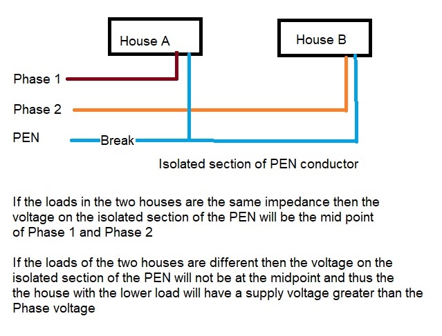

but isn't the most common situation one in which a 'lost PEN' results in 'under voltage'
A broken PEN can result in significant ( destructive ) overvolting of supplies that are connected to broken PEN
Yes, I know that - but, as I said, I thought (maybe wrongly?) that the 'most common situation' would be under-voltage.A broken PEN can result in significant ( destructive ) overvolting of supplies that are connected to broken PEN

Surely not "will be reduced", but, rather, "may be reduced" - since it all depends upon where the PEN is 'broken'?By fitting multiple earths, should we get a broken PEN, then the voltage swings will be reduced ...

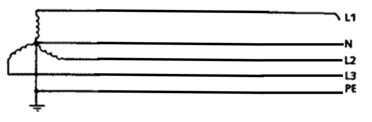

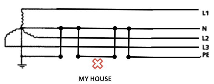

Your installation is presumably still configured as TN-S - i.e. your 'earth' is derived from the sheath of the cable that enters your property?All I want to know is, given that I "have" a TN-S supply, and a recent cable fault in the street saw a section of what would have had to have been 4C + E cable replaced with 3C + E, have they done something dodgy?
No. Standard procedure, and why TN-S doesn't really exist any more.
That being the case, I would think that they have not done anything particularly (electrically) dodgy (at least for the time being) provided that the cable sheaths are intact (and of adequate low impedance) between their new downstream joint and your property - but I can't see how they could be sure that such is the case unless they undertook measurements in your house.

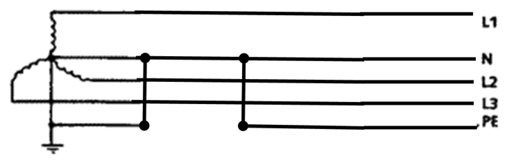

If they reconfigured the wiring within your house to derive your 'earth' from the incoming 'neutral' then, as flameport implies, they would then effectively have made the whole thing TN-C-S (which means that they also should have also PMEd it.
As I wrote, provided only that the cable sheath is intact/satisfactory from where it is connected to the neutral to your house (and your installations earth has always been dependent upon that) then, providing the cable has been PMEd (see below) then what you now have would seem to effectively be a perfectly satisfactory TN-C-S earth (even if achieved in a slightly unconventional manner) - so, if I were you, I don't think I would have any concerns, other than about the health of the cable sheath on which I was relying (but that has always been something to 'be concerned about', even before the DNO's 'repair')..Because they've compromised it as per what they did in my street?
As I presumed/expected.Yup. .... They didn't. .... 1) My earth remains as it was, and as it was when originally installed decades before TN-C-S started to be used.
There only has to be one earth rod (somewhere) in addition to the one at the transformer for it to qualify as PME. I had previously always 'assumed' that the 'M' of PME usually meant 'several', but the late-lamented westie used to tell us that when a distribution run was PMEd (to facilitate TNC-S) DNOs commonly only installed one extra rod, usually at the end of the cable run.2) As far as I could see they did not install an earth rod at the location of the repair.
Yes, I understood that to be what you were describingWhat they did has to have been going from this: .... to this:
