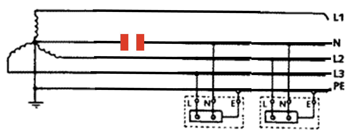

If two phases are involved then as per the diagram one house will be undervolted while the other house will be over volted.
True.
If I wanted to 'argue' (in support of the comment I made), I might point out that the above means that there is a 50% probability that any affected house would experience under-voltage and that, combined with the finite possibility of what you mention below, and the finite possibility that only one phase was involved means that, overall, there would be a greater than 50% probability that any particular affected house would experience under-voltage - but whether that would make that situation qualify as the 'most common' scenario would perhaps be debatable (even though literally correct) :-)
If the isolated section of PEN has no path to Ground then the two houses will be in series across a 400 Volt ( 2 phase ) supply.
Again true. It obviously depends upon the active loads in the two houses, but if they were similar, then that would result in both experiencing under-voltage (both about 200V).
All the above obviously assumes that only two houses are involved. If there are more than two, it gets a bit more complicated.
agreed but if ( when ) the loads are not similar the lowest load will be at risk of being overvolted.
A few years ago a cable fault severed one phase and the PEN to a cluster of 7 houses. The supply to one house went up to 300+ volts when the local sewage pump tried to start up. Remedial work ended up with a new 11kV supply being installed for the pumping station to separate it from the houses
Agreed.
That's obviously an even more complicated scenario.
Although I never quite worked out the probable mechanism, a good few years back a fault at the local transformer resulted in one of our phases falling to a low voltage (relative to N) (which is how we became aware of the problem) and another rising to a frighteningly high level (if I recall correctly, significantly over 300V) - but fortunately no harm/damage resulted.
I suppose that experience is a little 'reassuring', in that it indicates that it is at least possible for high over-voltages to not do any 'harm'.

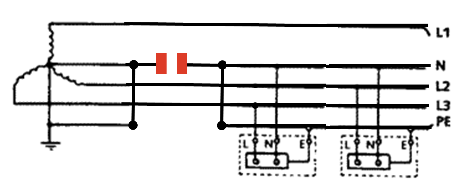

N break here: .... vs here? ....
You've illustrated the situation before the break was repaired.
I was talking about the situation after repair (with a 3C+E cable), when they would have to join the downstream cable sheath (which is providing consumers' earths) to the (repaired) N conductor.
In that situation, the sheath entering consumers' houses (i.e. their installation's earth) would be electrically connected to the supply N - just at some midpoint rather than at the transformer - which, as I wrote, I don't think would really make much difference.
No - I was illustrating a break happening after the repair. But in the new section, which would be pretty unlikely - didn't think about that.

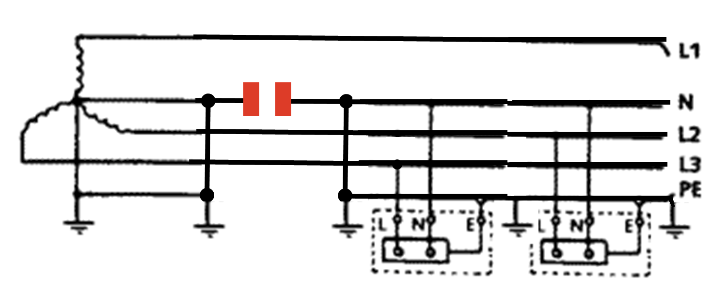

@morqthana has shown the problem where a repaired section which made the installation PME has failed a second time. And not so unlikely as one may think, where for example speed humps have caused ground movement no one expected, causing repeated problems in the one area.
We hope there are multiple earths 1756943007680.pngthe question is what is the resistance between the two sets of earth rods or other methods of earthing? The resistance and load will determine how much the voltage will swing, and with a housing estate pre-heat pumps, solar panels and EV charging etc, the fault could exist for some time without anyone realising.
But the reduction and increase of load due to use of heat pumps, solar panels, batteries and EV charging means the voltage swings can be far greater.
As to private earth rods, they are not likely to be good enough to have much effect, the problem is the likes of EV chargers and solar inverters are designed to auto switch off if the voltage is out of spec, but they will also auto reconnect, only when someone looks at the number of times this has happened is one likely to be alerted to a possible problem.

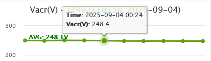

I can see what my voltage has been,

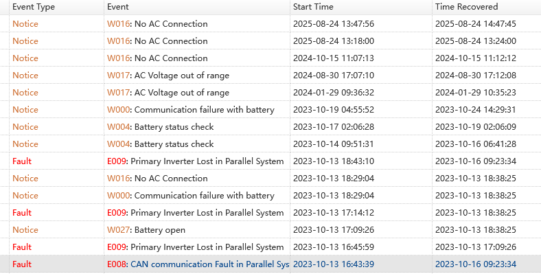

but if it was not being talked about here, I likely would not look. We get a report, ⁣but1756944072347.png again I have only looked because it is being talked about, how long could a fault exist before we become aware?
I simply don't know, as to if smart meters would report it again I don't know. Until we get lights flicker or bulbs blow, we may not know anything has gone wrong, and with LED lighting will it even flicker, depends on how the bulb is controlled.

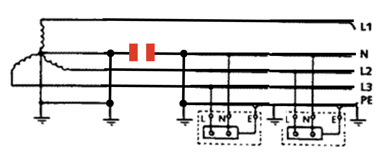

We hope there are multiple earths View attachment 391687
There used to be lots when we connected metal water pipes and gas pipes etc to the earth of the supply. I've still got a bonding connection on my gas pipe, but IHNI if the underground pipe is now plastic, or not.
