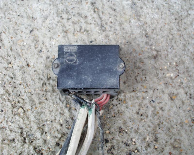

No. Those blocks are designed to take single wires with double insulation.
Twin and earth will have to have the outer sheath removed, so you will end up with single insulated wires where they enter the block.
There is also the problem of what to do with the earth - those blocks only have 2 terminals, but you will need 3 for twin and earth.
Yet another problem is that the terminals are very large, and fitting multiple 6mm wires in there will probably result in one or more loose connections.
Multiple T+E in a henley block ends up looking like this dangerous mess:
