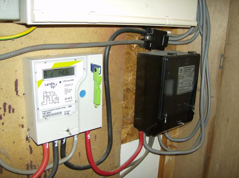

What's your electricity tarrif called? I have a feeling it isnt straight E7. Most E7 supplies have two fuseboxes, two mainwitches. This certainly isnt a standard system.
Dont suppose you know if you have 3 phase do you? A picture of the meter and mainfuse would tell us.
And that B40 in the old wylex shouldnt be there.

I wonder what sort of person fitted that whizzo MEM and left the old Wylex in place?
Dont know who fitted this system
The is no main isolation switch for the system
The house was built in the 70's and then they put the heating system in about the 90's
Nightmare city
Someone who was asked to price and install heating.
