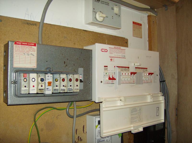

woah woah hang on
You have two consumer units?
Please post up a photo of the units you worked on and explain where you moved this circuit FROM and TO.
Its normal for an economy 7 circuit and consumer unit to have no power during the day. They are switched on by the meter.
Do you have economy 7? Maybe storage (or otherwise electric) heating?
Its normal to find bits of plastic in the consumer unit if you've had a messy spark who didnt clean out the case after he bashed holes in it.
Was anything burnt or melted?
If you have moved your eco7 element from the eco7 to the permenant supply it will run constantly and give you high bills.

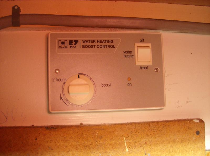

When i had no power to the tank i turrned the boost on and i had power to the element when that was off i had no power,
I thought the thermostat controlled the on off of the element
The two MCB are wired into the eco7 control unit this giving you two power sorces into the unit
And the boost i think is the one that is the off peak one that gives you a top up
This system is a twin element and the tank does not have two elements
The 100 amp switch MUST HAVE POWER going through it - its the mainswitch for the CU, unless someone has been creative with the wiring. If there is no power getting to the bottom terminals, the whole CU would not work, you'd have no heat.
PLEASE put a picture up.
Something doesnt sound right.

There are three 100amp breakers in the CU and loads of 16amp MCB
Two of the breakers have 1 power feed to it this supply the heaters focal fire boost etc
The 3rd 100amp breaker is the one that feeds the hot water tank 16amp MCB
all these breakers are inside the CU
The is no main isolater switch before for the CU
I will try and get some photos for you
higgie21 - please STOP what you are doing. Randomly changing circuits in your consumer unit is not safe, and won't fix the problem either.
The most likely explanation for the lack of hot water is that one of the elements has failed. Alternatively, the heating controller has failed. Either way, the solution is for a competent person to locate the defective item(s) using proper test equipment, and then replace whatever is broken.
Given the questions and descriptions of items you have provided so far, it is clear that you are NOT competent to do any of this work.
Your consumer unit does not have '100amp breakers' - they are isolating switches. If these had failed, the results would be burnt and melted plastic.
The supply to the main hot water heating element will not be on 24/7, it will switch on on overnight and possibly for a few hours during the day.
The consumer unit with two 100A switches will be dual tarrif board, one half being supplied via the unrestricted supply, and the other half from the timed E7 supply. Likely that the unrestricted section is due to there being supplementary heating such as wall mounted convectors, or possibly dual function storage heaters with fans or convector heaters in them.

Here are the photos of the set up of the CU
The left hand side single MCB is the water heater and is on E7 power
The middle one is 24/7 power and the right one is E7 power
I have proved that the element works fine so it must be the control unit
My mate who is a spark is going to have a look at it from me
