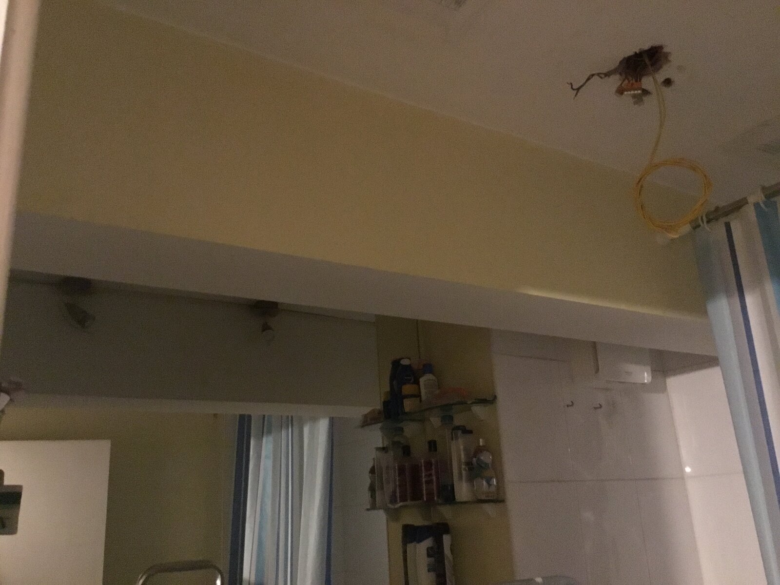

Photo shows my bathroom ceiling. Note the old ceiling rose location, fan, lights above mirror (reflected in the mirror), and huge boxed-in steel beam. This is a flat; I have no real access to the room above. The ceiling is plaster on expanded-metal lath, with awful “deafening material” above.
I am trying to get individual control of the fan, mirror lights and main lights. I posted previously about pulling additional wires through the conduit from the switch, which I have now done.
Currently there is steel conduit from the ceiling rose to somewhere behind the fan, containing 3+E. From the fan, discrete surface-mounted trunking takes twin+earth to the above-mirror lights.
To separately control the above-mirror lights, my options seem to be:

4. Run a cable by a new route from the rose to the lights. I guess I would drill through the web of the beam! Could I do this through an easily-repaired “keyhole” in the boxing, with a long drill, or would I need to remove enough boxing to get up close to the beam?

..... 4. Run a cable by a new route from the rose to the lights. I guess I would drill through the web of the beam! Could I do this through an easily-repaired “keyhole” in the boxing, with a long drill, or would I need to remove enough boxing to get up close to the beam?
I think you would find that drilling a hole through a "huge" RSJ would be a major challenge even if you established very good access (lots of 'destruction' and repair), hence quite probably near-impossible through a 'keyhole'.
RSJs not uncommonly some with holes in their webs, but you might have to undertake massive de-construction to see if there are any (and might well find none :) ).

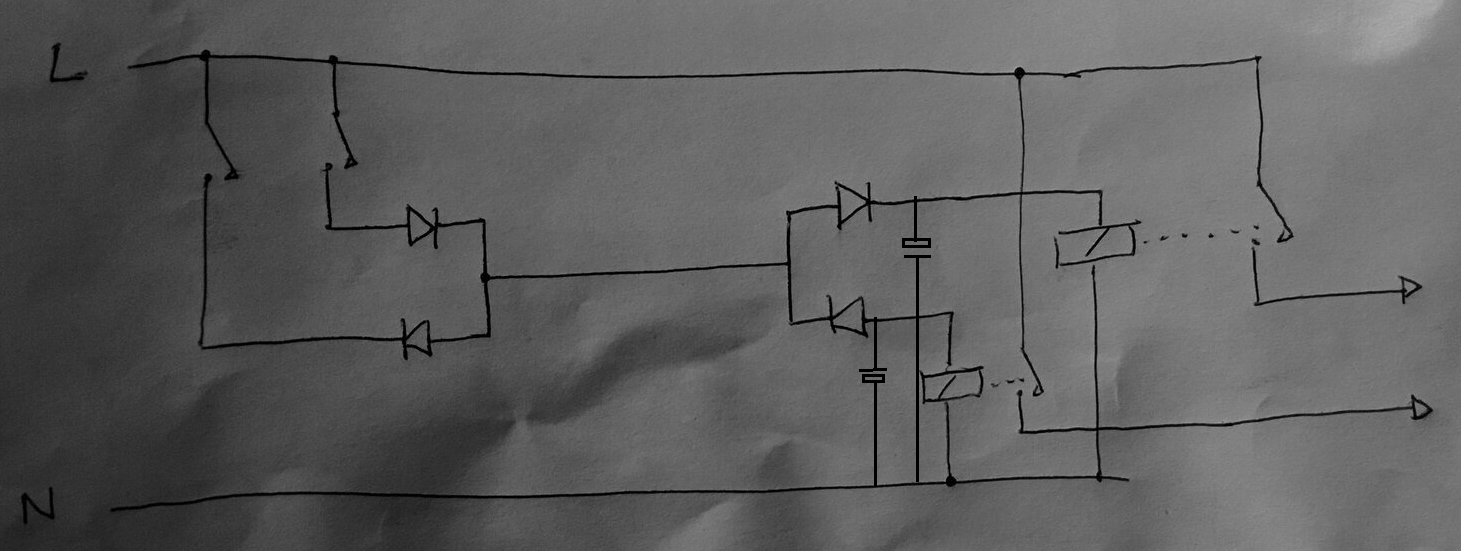

5. As an electronic engineer by training, I am tempted to multiplex the fan and light control over the available wires using some collection of diodes and relays. I am discouraged by the fact that some of it would end up inaccessible.
Having wasted my Easter Sunday trying and failing to run an additional wire, I am now contemplating this scheme. The idea is that each switch controls one half cycle. Then the requirement is that the relay coils are happy with a half-wave-rectified input. For a mechanical relay, half wave rectified 240 V is about 170 V RMS, which I guess is probably enough, but with some odd harmonics; I wonder if it would buzz. For a solid-state relay, I wonder if a half-wave-rectified input would result in a half-wave-rectified output? I.e. if the opto-isolator only turns on for one half cycle, the triac would only fire for one half cycle. Anyone know? Maybe I’d be better off with a DC-input solid state relay with a capacitor on the input.
For the fan, which has a permanent live input, if the switched live input is just a control signal then it might work directly from the half-wave signal.
Feel free to tell me I’m crazy!

..... I am now contemplating this scheme. The idea is that each switch controls one half cycle. Then the requirement is that the relay coils are happy with a half-wave-rectified input. For a mechanical relay, half wave rectified 240 V is about 170 V RMS, which I guess is probably enough, but with some odd harmonics; I wonder if it would buzz. For a solid-state relay, I wonder if a half-wave-rectified input would result in a half-wave-rectified output?
Quite clever, and simpler than I has envisaged (because I hadn't contemplated running relays with half-wave rectified input!).
I suspect that a mechanical relay might well buzz with such an input and, like you am not sure what would happen with a solid state one (although I suspect that what you go on to suggest may well be right). Therefore ....
... I think I would be inclined to include smoothing capacitors and use (mechanical or solid state) DC-input relays.
I was initially concerned that there might be a problem if both switches were 'on' - but, on reflection, that ought to work as intended.

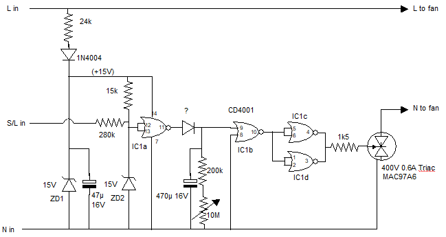

I imagine so, provided that you used the correct one of the half-wave rectified signals for the fan. I think that the most common arrangement is that the first negative half cycle of the AC input pulls down the voltage (to the 'forward' voltage across a zener) at the (joined) inputs to one gate of a CD4001 - and it takes only that half-cycle to trigger the timer.

My experience of the proposal: AC relays will buzz and arc, use some modest smoothing capacitors and ideally DC relays.
Indeed - as I wrote ...
I suspect that a mechanical relay might well buzz with such an input and, like you am not sure what would happen with a solid state one (although I suspect that what you go on to suggest may well be right). Therefore .... I think I would be inclined to include smoothing capacitors and use (mechanical or solid state) DC-input relays.

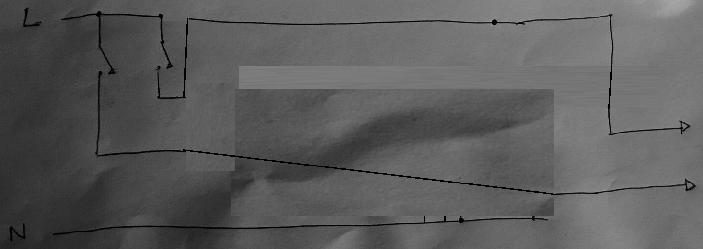

I assume this arramgement isn't showing one
Having the fan individually switched it doesn't require a permanent live. ... I assume this arramgement isn't showing one

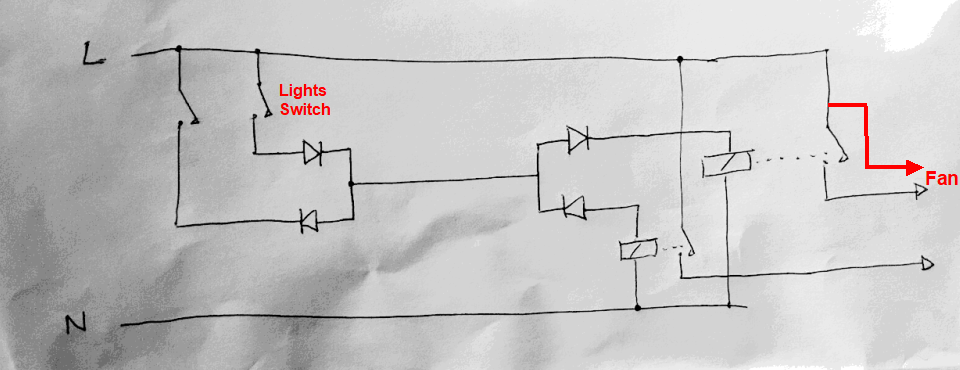

Maybe I misunderstood, but I took it from what the OP had told us was that it was a timer fan triggered by the rooms lights (but not shown as such on his diagram)- i.e. as below. If that weren't the case, if he had two switches, two loads and three cores then, as you've illustrated, he would not have any need for anything 'clever', would he? ...
I will still have a perm live to the fan. I had considered not doing so, but this particular fan doesn’t work well with perm and switched live joined together, and I don’t want to replace it.
I'm getting a little confused :-)
If it has both a switched live and permanent live, then I presume I was right in assuming that it is a timer fan?
What controls (and/or what do you want to control) the fan - activated by the lights or separately manually switched?
What do you mean by saying that it doesn't 'work well' with perm and switched live joined? It is obviously only the perm live which can actually 'power' the fan - the S/L merely triggers the timer to start, and I can't see how there can be a difference from triggering it with, say, the switched supply tio the light and having it permanently connected to L (in which case the tiner will get triggered as soon as soon as the permanent live becomes 'live'.
