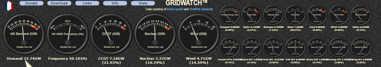

For the above reasons, it rather surprises me that we haven't seen a lot more 'on-screen analogue displays' (which are easy enough to implement). One sees them occasionally, but not often. I suppose that 'bars' are quite common in some situations, but something gthat looks like an analogue meter is pretty rare - here is one of the very few examples I regularly see ...

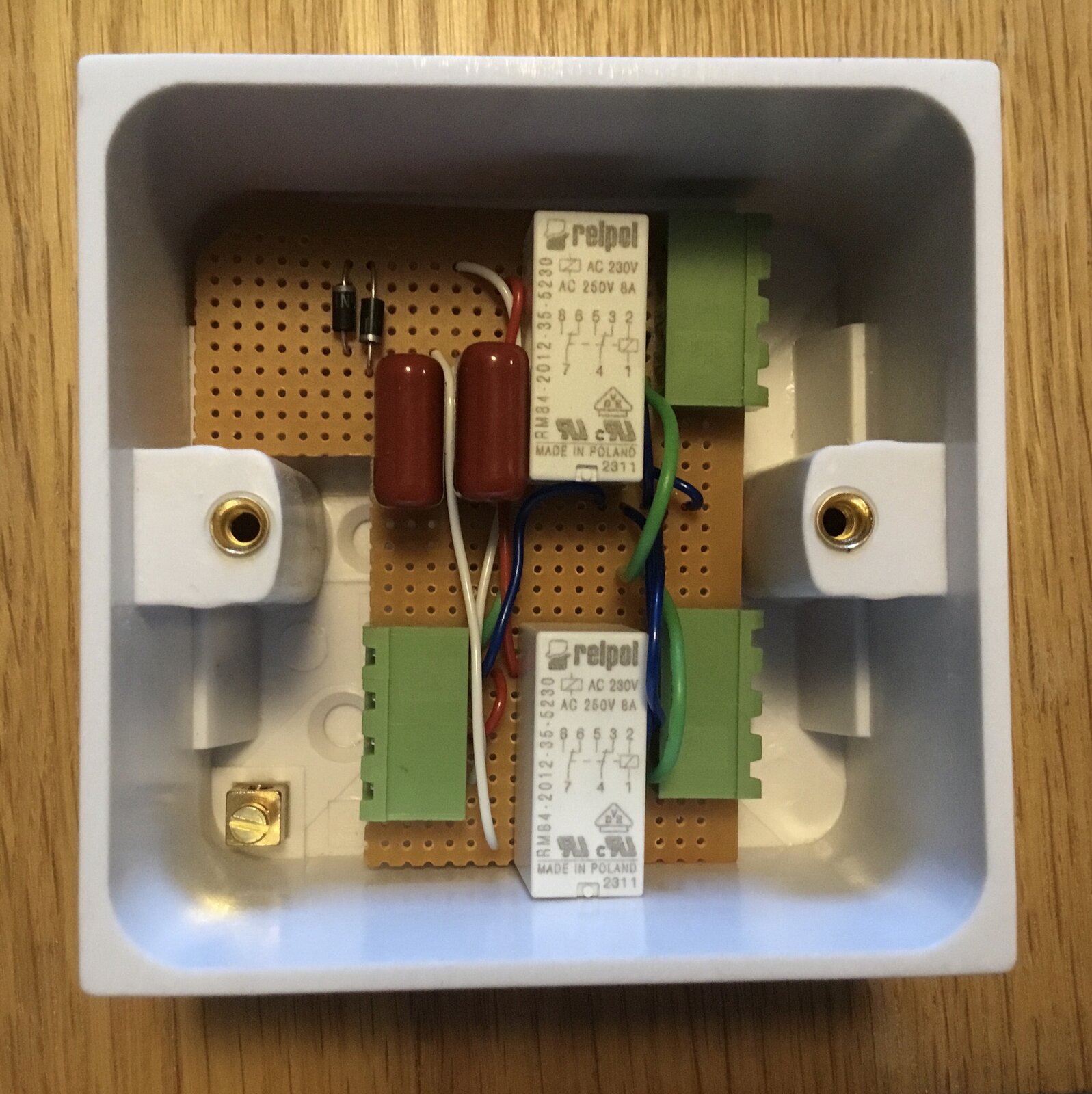

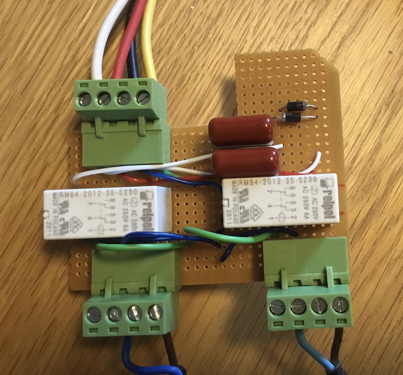

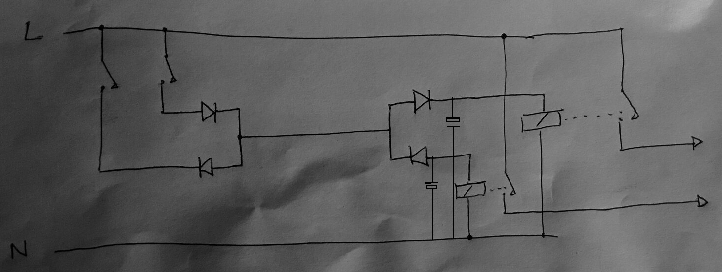

Latest update: I have obtained some high-voltage capacitors and added them as shown in @SUNRAY ’s edited circuit.
I didn’t want to do this in the obvious way because I felt it could overload the coil; smoothed rectified 240V AC is about 330V DC, and since much of the coil’s impedance is due to its inductance, the current would increase by even more than that would suggest. So I’ve chosen a smallish capacitor value - 0.47uF for this relay - such that it discharges to about 100V during the “off” half cycle. The result is a waveform with an average DC voltage of 247V. That must still dissipate a bit more heat in the coil than 240V AC would but it does work and doesn’t get noticeably warm.
This works on a breadboard.
The crucial question is presumably whether it still buzzes?
Thinking aloud (and particularly if it still buzzes a bit) .... could you not increase the capacitor value considerably (to get a much smoother waveform) and then put a high-voltage zener in series with the relay coil, to reduce the voltage reaching the coil to whatever you wanted?
Kind Regards, John
