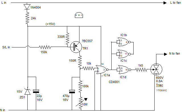

I've never seen a fan timer module in which the timer can be completely 'disabled' (without getting one's soldering iron out), but they invariably have a configurable run-on period, and that can usually be wound down to no more than 'a few seconds'.
If you were prepared to 'get your soldering iron out', you obviously could (referring to the circuit I included in post #6) dramatically reduce the value of (or probably completely remove) the 470 F timing capacitor (and/or, probably, remove the diode between IC1a and IC1b)

One option would be to remove the timer from the fan and install it near the light (instead of your proposed relay arrangement), that way only neutral and motor live required, leaving the 3rd core free for the mirror lght.
Yes, that would be the obvious option IF the OP definitely did not want the timer (or humidistat) functionality. Whilst,as I wrote, I've never seen a timer module which can be totally 'disabled' (without some 'soldering' work), removing the timer module is child's play (I've often done it, at least as a temporary measure, when a timer unit has failed or needed repair) - and obviously removes the need for two 'lives' (perm L and S/L).

That's pretty unusual. The timer units I've seen are all essentially the same, both physically and electronically (with just a few variants to the electronics), with just screwed-terminal blocks on the two ends of the PCB - a 3-way one for 'in' (Perm L, S/L and N) and a 2-way one for output to the motor - so, as I said, making it child's play to remove and 'bypass' the module. It sounds as if you must have a more up-market one than the various 'fairly basic' ones I've dealt with.
Most of the variations in electronics I've seen are very trivial. The one I showed was per Manrose, but many of the 'nameless' and own-brand ones I've examined are essentially identical. A slightly less trivial difference was seen in a Wickes-branded one I took out of service a decade or so ago. It used a transistor, rather than one of the gates of a CD4001 to be triggered by the S/L input, but that seemed a bit daft, since they then ended up with two of the gates of the CD4001 being unused ....
