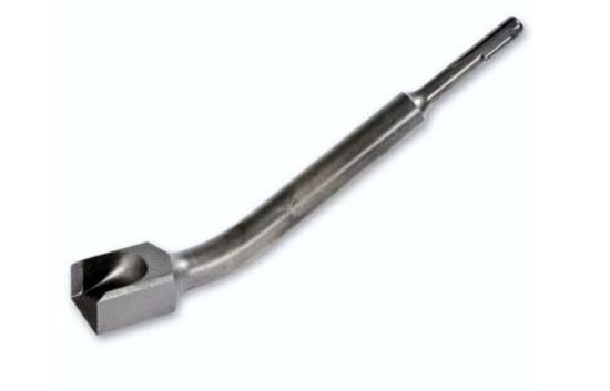

I have a DIY job to do this weekend where I need to cut a channel into my lounge floor to run radiator pipes.
Using an angle grinder and sds drill will make a huge mess. Any suggestions for limiting this mess please?
I’ve got a Henry hoover with a fabric bag fitted btw. I’ve seen dust guards available for angle grinders on Amazon, any suggestions please?

The angle grinder will make a mess (even with Mattylads excellent suggestions) but and SDS drill and then chisel whilst slow, shouldn't make too much mess. Keep in mind the notion of sealing the channel afterwards with a liquid DPM, in case you've breached the previous one.
Or alternatively Armeg do some really good chasing chisels if you have a rotation stop SDS drill:
Above: 30mm single chasing chisel
Below: 55mm double chasing chisel
They also do a 20mm swan-neck version for chasing down behind existing skirtings without the need to remove them as well as being the originators of the EBS single and double box sinking system. Not the cheapest, however, but made in Sheffield and pretty durable. Good for light to medium blockwork (although not for very hard concrete blocks or compacted concrete) and for soft to medium brick or stone (though not engineering brick or hard stone such as granite)
