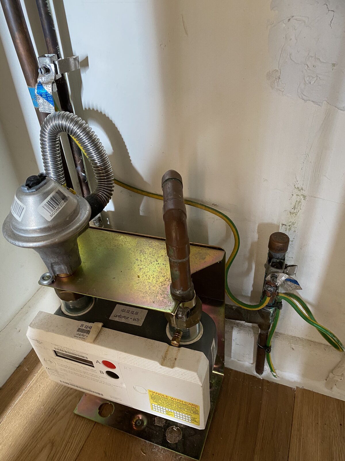

Hi
I have metal gas and water pipes with an Earth bonding cable going from my consumer unit to my copper gas pipe near the gas meter. The same Earth wire comes off the gas pipe to my copper water pipe.
My water stop cock in the kitchen does not have any earth bonding cable. It looks difficult to try and run a new cable to the kitchen as all tiled floor etc.
If the earth cable running onto my gas pipe then continuing to my water pipe ok and doing it’s job or do I need to get my kitchen stop cock fitted with one too ?
or is there any other way of earthing the water stop cock in the kitchen, maybe running from a junction box behind the fridge or somewhere in the kitchen where I can find an earth cable ?
pse see photo (gas pipe on the right and water pipe on the left)
any help and advice appreciated thanks

How far is the section of water pipe with the earth clamp away from the stop cock for the water?
Are you certain that the section of water pipe with the earth clamp is the same pipe as the one where the stop cock is?
Can you remove the kitchen plinths to run cables?
What is the incoming pipe from the road made of?
If the pipe with the earth clamp really is the same pipe from the stopcock, I probably wouldn't worry about it, if wiring access is difficult.
Hi. It’s about 10 feet away. The gas meter is in the hall near the front door.
I don’t know if it’s the same pipe as the stop cock. It’s nearer the front door where the water supply probably enters the house, I can’t see it though.
I have wood floors everywhere on top of the existing floor boards.
I think all pipes are copper, can’t see any plastic.
The house was renovated around 10 years ago with new boiler system and wiring etc. To earth the kitchen I would have to run a cable through the ceiling and drop down somewhere in the kitchen. Maybe a bit difficult.
If I was to run a cable to the kitchen would it come off the earth cable by the gas meter? I’m assuming it wouldn’t need a new earth cable from the consumer unit.
If you were to do, you could come from the gas meter, no need to go to the consumer unit.
Worth checking if the water pipe in the hall is the same as the stopcock one.
IF you need to do this, and I repeat IF, don't forget you can run the cable outside the house.
The whole idea is not to earth, but to bond so ensuring all metal parts have the same voltage to any common point. If the gas or water pipe is isolated from true earth i.e. plastic main or isolation piece then then it is unlikely to end up different to other metal within the home.
Water pipes are clearly water cooled so no real problem, gas pipes one has to be careful the earth with a TN-C-S supply is correct side of the isolating block or the pipe under fault conditions may not be able to take the current.
To ensure there is no isolating part within the home that would result in part of the metalwork being at true ground potential rather than the potential of whole house, we have rules as to how close to where the supply comes into the house the bonding should be. However with RCD protection once in the house bonding is not so important, the worry was a fault in once area of the house, say for example the dog knocked over a standard lamp which smashed the bulb and resulted in a live part touching the radiator could result in the radiator pipes becoming live and some one in another room touching a radiator could get a shock. But the amount of current required to trip a RCD is very small, less than 30 mA, so today that is not really a valid worry, so the bonding requirements are not as strict any more, at one point in the early 70's it went daft to point of earthing metal window frames, but that is no longer the case.
If you touch a live part, but are not also touching other voltages like the birds on the power lines, you get no shock, so too much bonding can be as bad as not enough.

thanks I will bear that in mind. It’s all because of British Gas fitting an EV charger in my garage. Hopefully they won’t think it’s an issue.
many thanks for your help.
