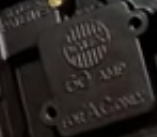

I had EICR with a property I let 5 years ago, few electricians asked to replace the fuse box (pic attached). I Managed to find an electrician who passed it.
Is it still passable today?
The whole of that question by the way it is asked leads me to shudder. Maybe my interpretation of you asking a few electricians and managing to find one willing to pass it.
I suppose I am inclined to ask you you how deep was the barrel you were scraping the bottom of?
With only 4 circuits, it's not going to cost a fortune to upgrade, unless of course the whole lot is shot
2x32 and 2x6 makes me wonder how well appointed this property is .. one ring final, one cooker and 2 lighting circuits is hardly palatial :unsure:
6 circuits 3 x 32(30), 1 x 16 (15) and 2 x 6 (5) would have accounted for a very common set up with the old Wylex 604 allowing for 1 cooker and 2 rings, one immersion heater, two lighting circuits, simple . For those too young to remember the figures in brackets would be for rewireable fusewire then the early MCBs - wylex MCBs were push button not toggleswitched type

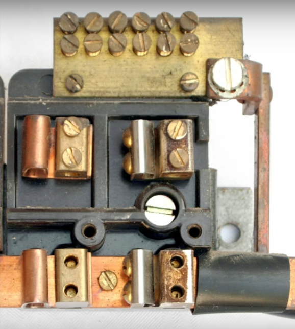

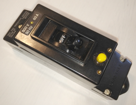

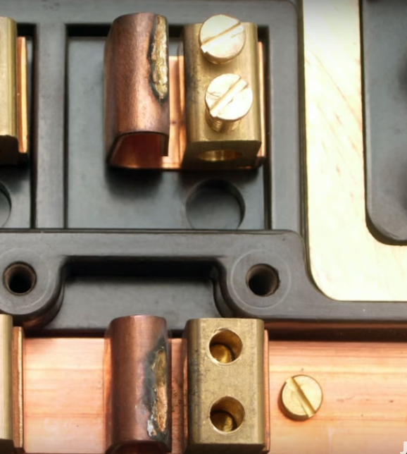

The problem with the old Wylex:-
1) Only rated 60 amps Wylex 60 amp.jpg 2) Most were damaged over 30 amp fuse used.Wylex burnt contacts.jpg 3) Wylex heavy duty.jpg Those with the ability to take a larger fuse, it was only on the first fuse carrier. There was nothing to stop an ELCB-v from being fitted, ELCB-v.jpg but the test gear Clare ELCB tester3.jpg is long gone. But nothing to stop the ELCB-v from being replaced with an ELCB-c, but when that was done, it was often the 100 mA version. I have seen where the 100 mA has been swapped to 30 mA, and also seen the problem with it tripping all the time.
