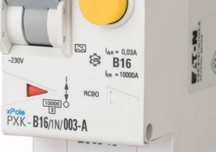

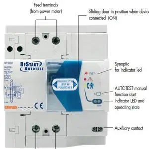

I have tried to be serious, early 90s my son passed his RAE (radio amateur exam) and I wanted to keep him safe. This was before we had consumer units like seen today, so I got an 8 module adaptable box to house two 4 module wide RCD's. This was fitted before the two Wylex fuse boxes like you show, so I had RCD protection with Wylex fuse boxes.
Pictures can show what you have, but not what you don't have. The RCD's would every so often have a bout of tripping, no faults found, but we're looking for a way to cure the problem, Auto RCD.jpgX-pole.jpg either auto resetting (now banned for domestic) and the X-pole which gives a warning, but sold house before I got around to it.
