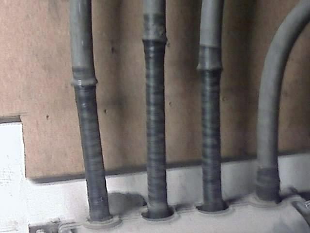

When you speak of pyro, do you mean a single core of multi-core pyro or literally 'single core pyro'?
Single core , im sure i have a picture somewhere
Hmmmm. As I said, I woiuld that thought that, if eddy currents are an issue of concern, then any metal-sheathed single should invoke such concerns. I think that there still has to be something about all this that I don't understand, or am missing! Anyone?
Heres some lead for you :)
Again interesting, given that my comments apply to any sort of conductive sheathing..
Kind Regards, John
