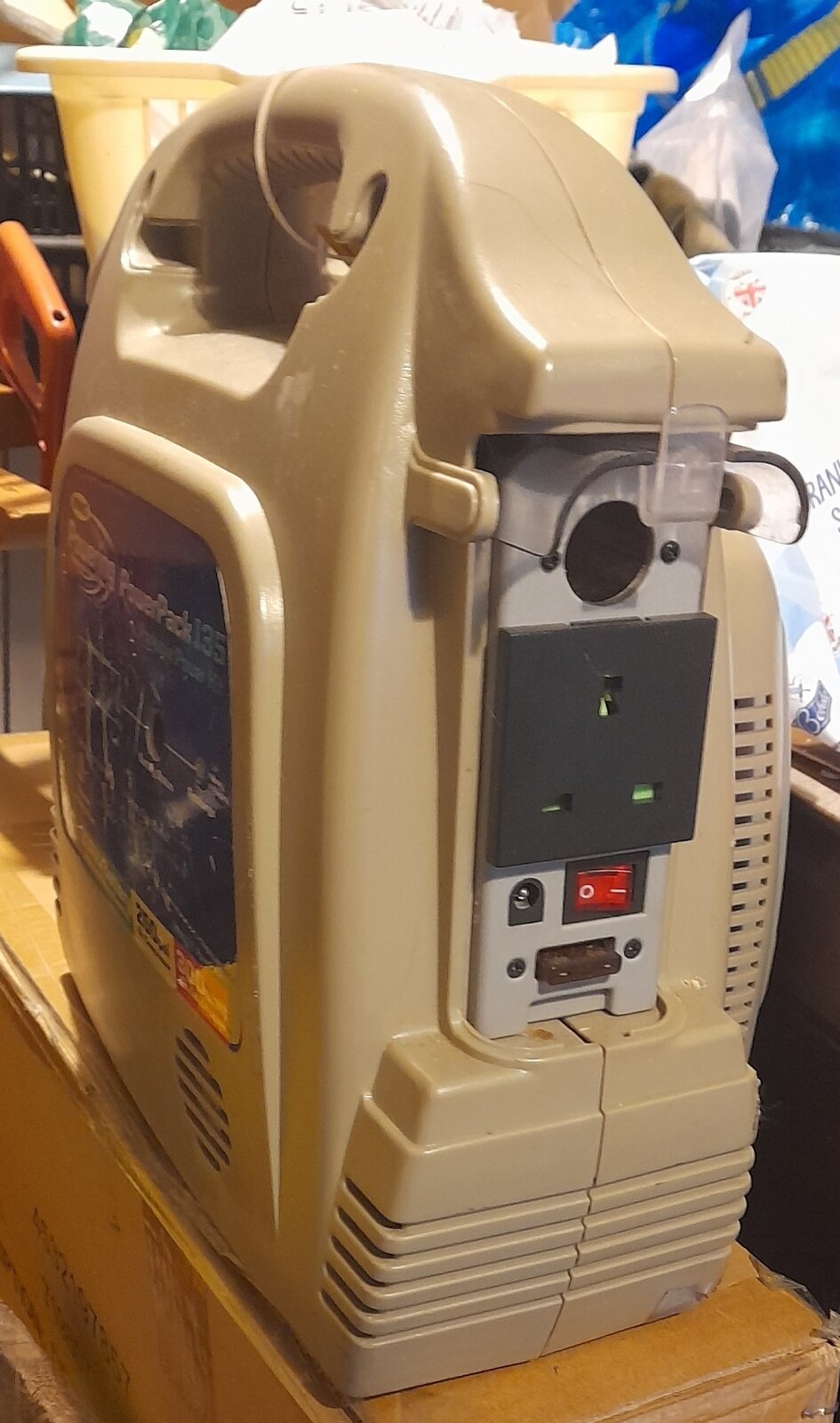

could keep the heating running, one shown is just 150 watt, not tried to run the central heating, but would likely run for 8 hours. I would guess one of these would work Yes, but that's just "you" and, as I said, the great majority of people in UK do not have any source of electricity other than the grid - so, as I said, loss of grid electricity will cause them to also lose gas/LPG/oil central heating.My oil boiler will continue to run, until my batteries go flat, and the solar could mean they could last for weeks. ...
