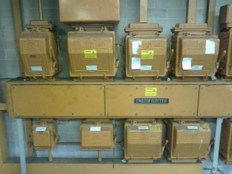

Used to work on similar stuff regularly, most BT telephone exchanges have similar vintage installations, full of busbar chambers, massive heating/lighting contactors and big old azzy filled switches.
The only thing I disliked about the old installations was tap off systems. Who ever invented that needs shooting. The proper busbar ones are OK but the bits of 16mm in a ring with soldered on tails to a box are a horrible, horrible idea...

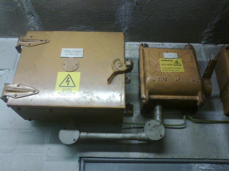

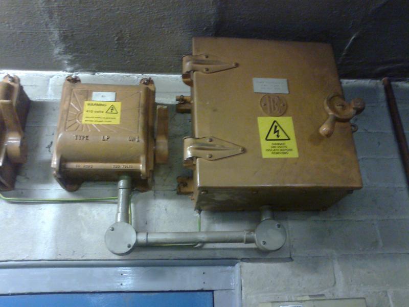

see a few like this round and about, generally in good condition but they can take quite a bit of "abuse" as well.
Like the "legacy" cut-out/CT chamber set-up as part of the board

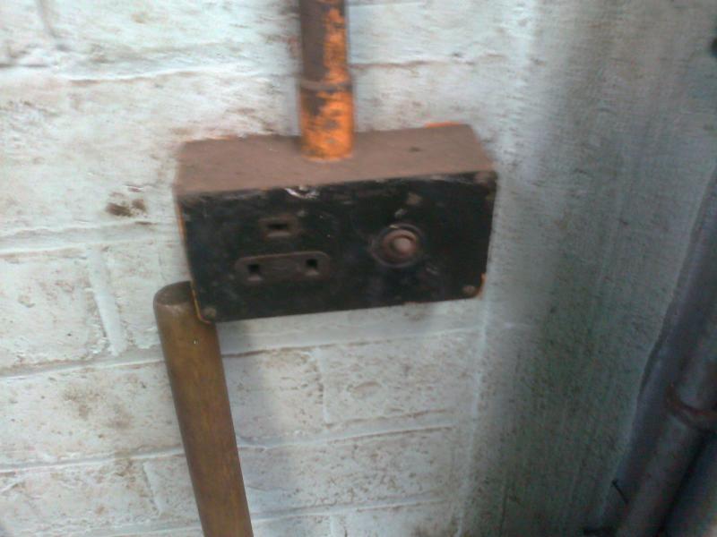

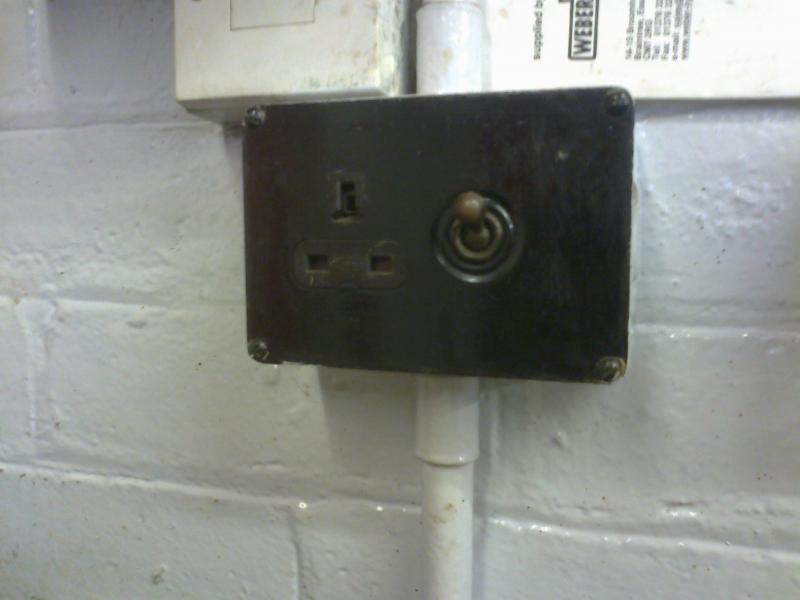

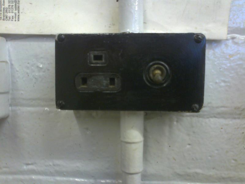

Im sure all the wiring was singles in steel conduit and trunking it, I know all the lighting circuits in the offices and the sockets where done in conduit and it was PVC singles using the conduit as the CPC.
