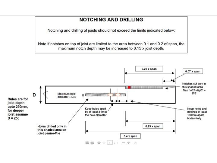

I'm interested, did he thread all the cables through joists 50mm down?
I've just done a rewire where I've done just that, on my own. Takes bloody ages.
Years ago, it was a case of utilising any notches left by previous sparks, heating installs, whatever. I find threading cables through joists puts a lot of extra time on a job. Probably spent 6 days on 1st fix alone. Don't know how one guy can do the lot in that time ... and this house in empty!
Yep all cables are threaded through the joists at the correct depth. I seen him do allot of it as i took a few days off.

I'm interested, did he thread all the cables through joists 50mm down? ... I've just done a rewire where I've done just that, on my own. Takes bloody ages. ... Years ago, it was a case of utilising any notches left by previous sparks, heating installs, whatever. I find threading cables through joists puts a lot of extra time on a job.
I must say that I sometimes feel a bit nervous when I see electricians (or plumbers), in the name of compliance with current regs, drilling 'yet more holes' in joists that are already extensively littered with notches and holes (possibly in structurally inappropriate places). Is there any guidance about this, in terms of structural safety?
Kind Regards, John
This might help ... The actual limits are detailed in BR Part A and the OSG
It doesn't help me all that much - I am aware of the current regulations/ requirements. What I'm more interested in is whether there are any regulations, or even just guidelines, clarifying what is permitted (or 'wise') in terms of new holes/notches, if the joist in question is already littered with holes and notches which are not in the 'shaded areas' in which they would now be permitted.
It seems to me that, pragmatically, the interests of the structural integrity of the joist would probably best be served by using existing holes/notches, even if they are in places which are not now compliant, rather than create 'yet more holes' in joists which, by modern standards, might already be regarded as structurally compromised.
Kind Regards, John
I absolutely agree. I will always use existing notches (adding safe plates), holes etc rather than weaken further the integrity of the joist.
I'm glad you agree - that's certainly what I would do, and would want to be done, in my own home. However, I seem to recall that when this has been discussed in the past, some electricians have said that, "to cover themselves", they would prefer to drill more holes (and presumably thereby weaken the structure further) than to put new cables through holes that were in (structurally) non-permitted positions.
