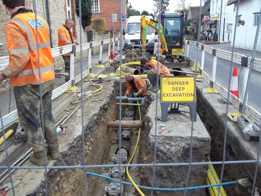

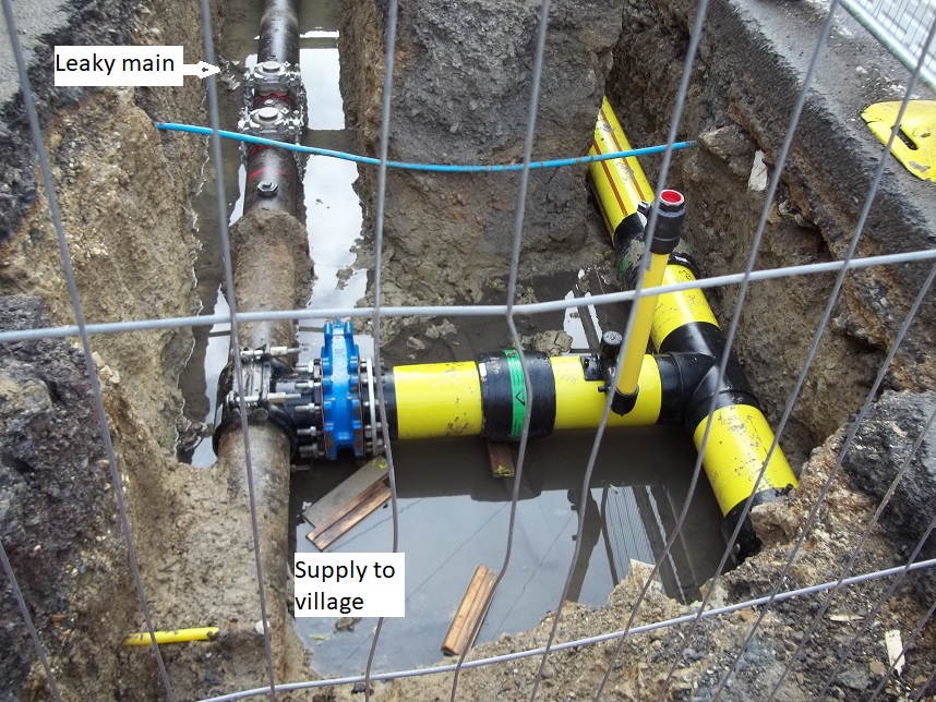

Cadent decided that 200 metres of leaky metal main along the High Street was to be by-passed, sealed and abandoned. Sleeving was not a viable option. even though the pipe was a straight run.
Sleeving seriously reduces the internal bore of the pipe. There are lots of properties with 16mm insertions that don't give nearly the full rate they are supposed too. They probably decided that a new main was the best way to supply everyone
