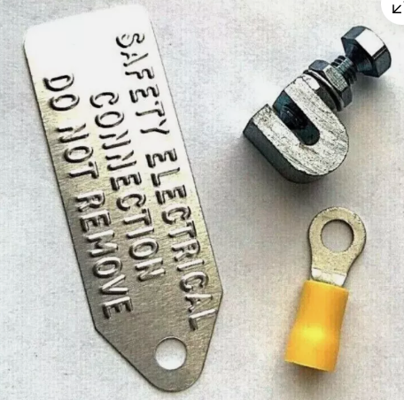

Furthermore, as I've said, if (as is common) the radiator were electrically isolated from the pipework by PTFE tape, if you really wanted to earth it, you would have to scrape some paint off thge radiator and use a "radiator earth clamp", such as this ....

Furthermore, Harry has yet to clarify whether he really has earthed his radiators, rather than just the pipework. I've just tested a couple of the radiators in my (all copper plumbing) house, and they appear to not be earthed, even though the pipework is earthed, presumably due to the PTFE tape.
