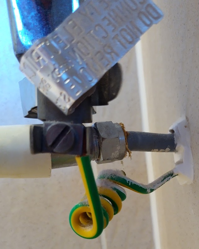

Here is some bonding to a towel radiator found earlier today:
Here is that same bonding and some others after I cut it all out:
Whoever installed this mess was evidently unaware of what bonding was for.
The radiator is connected via plastic pipes.
The rest came from some bathroom basins where someone had connected to the short lengths of copper pipe below the taps. Hot and cold pipes to the bathrooms are plastic.
Without bonding, the radiator and taps are just metal objects in the bathroom. No problem there.
With bonding they become big lumps of earthed metalwork connected to the electrical installation which is much worse.

Is it worse, as in dangerous, if the EP bonding overall is properly installed?

I am not sure there is an answer to that question because the words do not actually make sense.
It is worse, as in dangerous, if unearthed metal parts are earthed by unnecessary bonding, so how can the bonding be properly installed overall?
It can be (potentially dangerous) in situations such as flameport described, when a large and touchable metal object is connected to earth (via 'bonding') when it would not be so connected (e.g. because it was a radiator supplied by plastic pipes) in the absence of that bonding.
In that situation, if someone somehow touches something electrically 'live', they will not get a significant shock if unless they simultaneously touch something 'earthed' (or connected to the installation's neutral). To create (by unnecessary bonding) an unnecessarily earthed large lump of touchable metal therefore increases risk/damaged in that situation.
If the radiator were supplied by metal pipes, then it is extremely probable that it would already be connected to earth. In that situation, although totally unnecessary,'bonding' it would do no harm.[/S]

I thought the whole point of EP was to equalise the potential in such situations, so that there is no or low shock.
It is. If there are two or more items which could have different potentials, they are bonded together to keep them at the same potential.
Typically it's items which introduce earth potential from outside (such as metal pipes) and other metal parts connected to the electrical installation.
However if something has no potential (not connected to anything else) then there is absolutely no point in bonding it.
The radiator example with plastic pipes cannot have any potential - it's just a metal object on the wall. Same applies to a metal door handle or a drawer of metal cutlery.
Bonding is not based on whether items are conductive - it's whether they are conductive AND can introduce a potential into the location.
