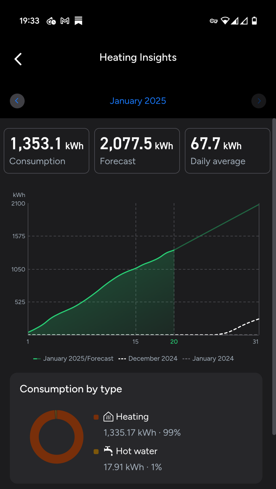

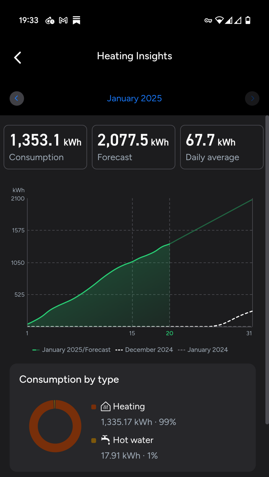

So the attached is a screenshot from my Tado system showing usage for Jan so far. Actual consumption of 1,353 kWh for 01-20 Jan.
The actual meter readings were 601m³ on 01/01/2025 and 993m³ today. This is a usage of 392m³ which is roughly 4,454 kWh (using one of the many online converters).
Now how can these two figures be so wildly out? Even assuming that the Tado figures are rough and ready, and the conversion from m³ to kWh varies slightly from one calculator to the next, how can the actual gas usage be 3.3 times the estimate from the Tado system?
Note: the Tado system was only installed recently so I don't have data to cover the bill period mentioned in my original post.

Agreed, but that's the other thing that puzzles me... My tado system which controls the boiler for heating and hot water shows considerably less gas usage as compared to the octopus smart meter readings.

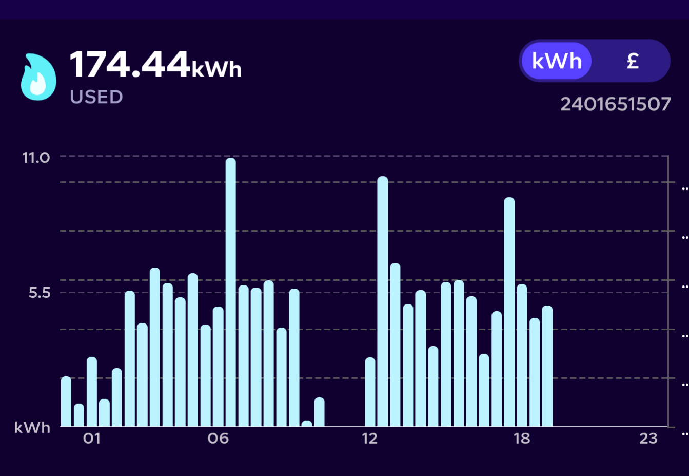

Here is a screenshot from my Octopus app. I turned off the boiler at about 10am for a couple of hours so you can see zero usage until I turned it back on. The boiler is installed in the garage so was cold before I turned it back on. However the gas usage only peaked to about 10 kWh as you can see from the picture.

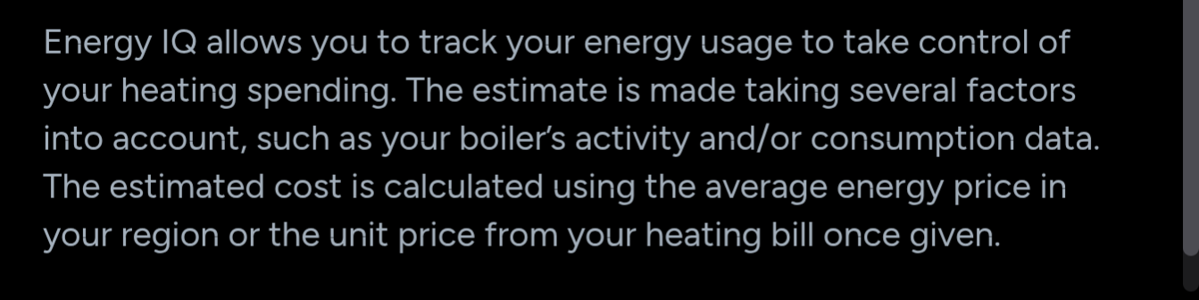

Forget Tado it is not measuring anything but trying to estimate it, quote from there own website
"We estimate (heating) energy consumption based on historic tado° heating data. To make an accurate estimate, we need the energy consumption data from at least two energy bills. Just the meter readings, no personal data. We need this data to calibrate our abstract heating data to your individual heating system."

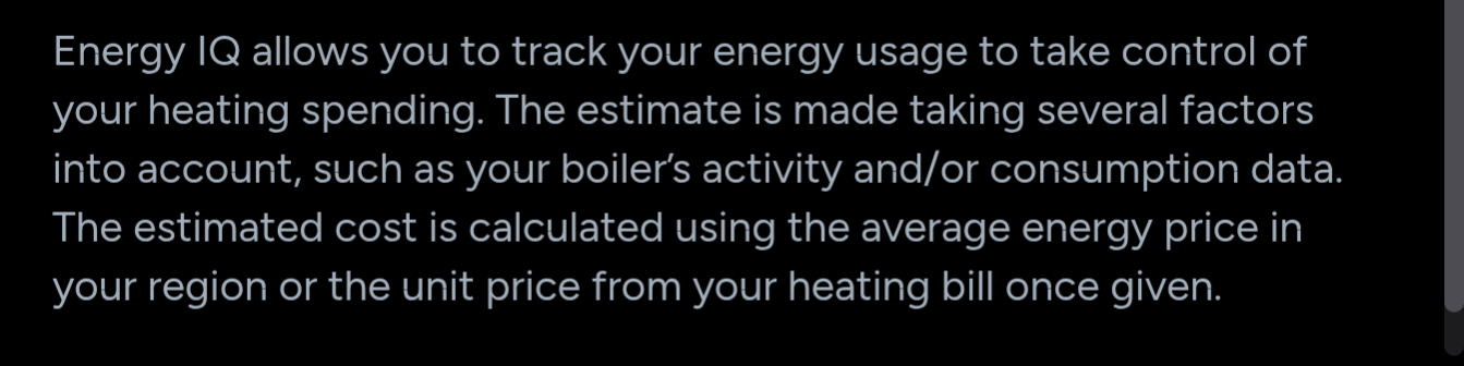

A very good question! After fiddling around in the app for a bit it looks like it's a combination of estimates based on how many times it has to call for heat/hot water and meter readings.
See the attached screenshot from the app which explains this. I have added all the meter readings fir the new meter but the actual usage hasn't changed at all which seems to suggest that the actual usage is from how many times it called the boiler, but the forward-looking forecast must use the meter reading data...

That is NOT peak consumption, it is consumption averaged over 1/2 hourly intervals.
As you seem to be running your heating system all day I am not surprised at your consumption.
Are you using radiator thermostats on all radiators or just a room stat ?
Does your frost stat run all the radiators ?
That looks like your smart TRV's are calling for heat all day long!
