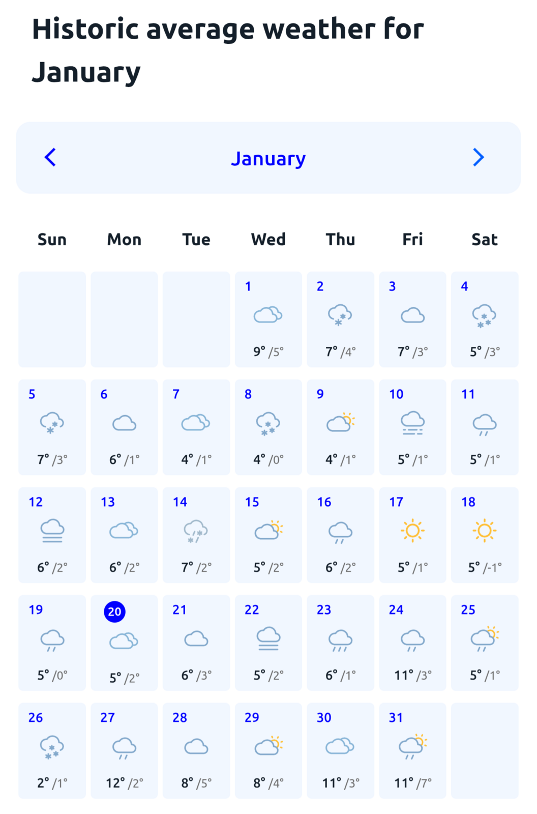

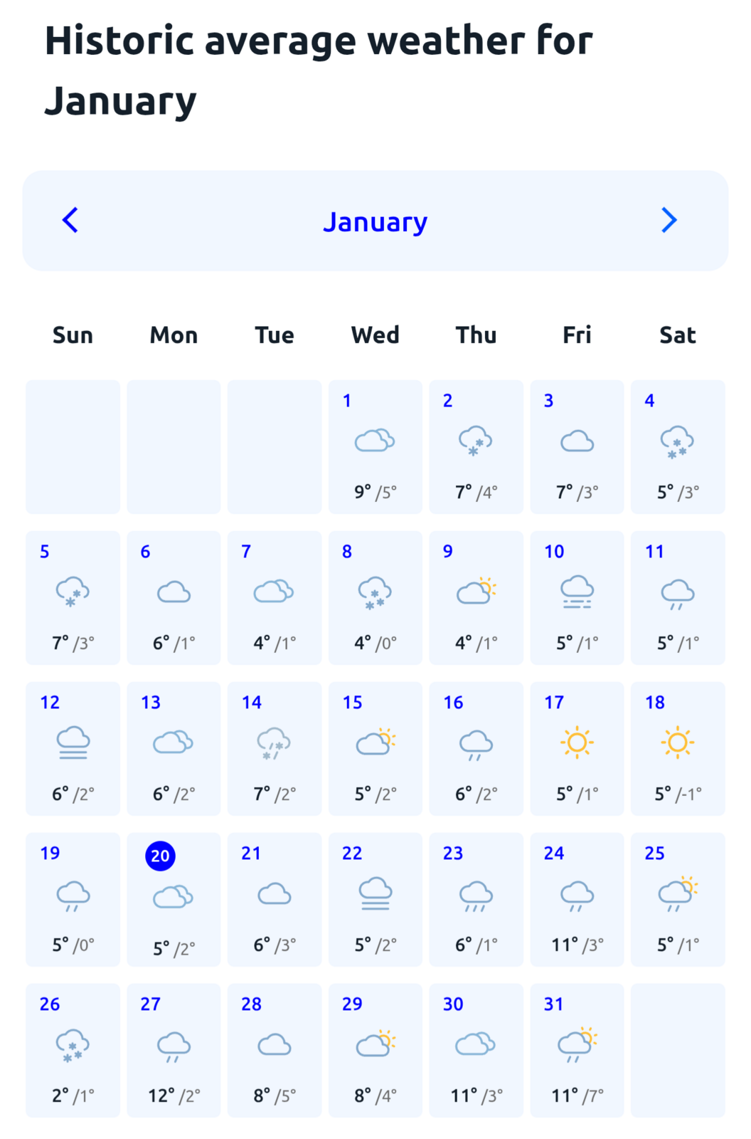

How cold was it for the period of the screenshot? When was the screenshot period? I could check mine for a comparison?
Here is a screenshot of the weather over the January period. Not sure how accurate this is though as the last two weekends have been sub zero temps.
